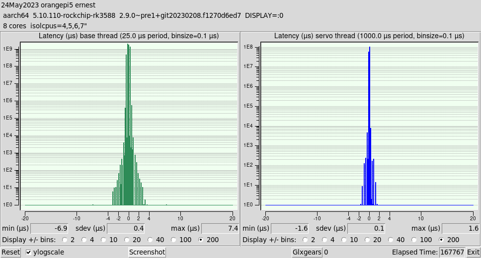

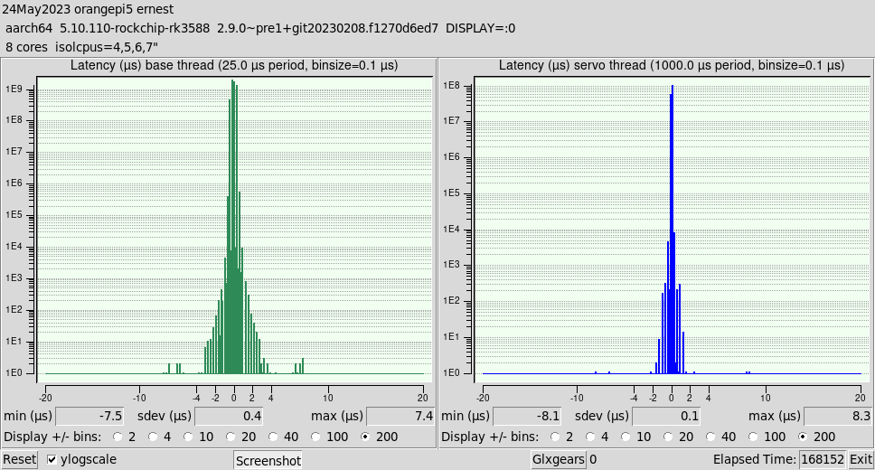

I installed heatsinks and a 512Gb .m2 card, then transferred the OS and ran the test again overnight.
The results were exactly like the one before, under 4 on the servo thread, except for the ouliers at about 25. I have to leave it running overnight for these to show up, and nothing is printed to the console. Is there a way to get the histogram to print a timestamp when the max or min latency has been exceeded?

I think the evidence is clear at this point. I've been running this latency histogram for days, trying to determine where the glitch up to 25us was coming from. I've got the all but perfect results above. The only thing I haven't done is run any video.
Is it fair to blame the glitch I got before on This Old Tony? Maybe I should have been watching tubalcain videos?
Replied by echristley on topic Can the OPI5 be Configured to Run LCNC?

We have found that playing youtubes in FF give us the worst latency results on any processor. It might not be what you see when running the machine, but it sure gives you a worst case to keep in mind.

I think you nailed it, Bari.
Look at the timestamps on the screenshots. I ran for two days, doing everything imaginable to trip it up, and you get the first screenshot. A few minutes of playing a video in FF. . . and the latency has already expanded by a factor of five. If that don't tell the story, I'm reading the wrong book.
