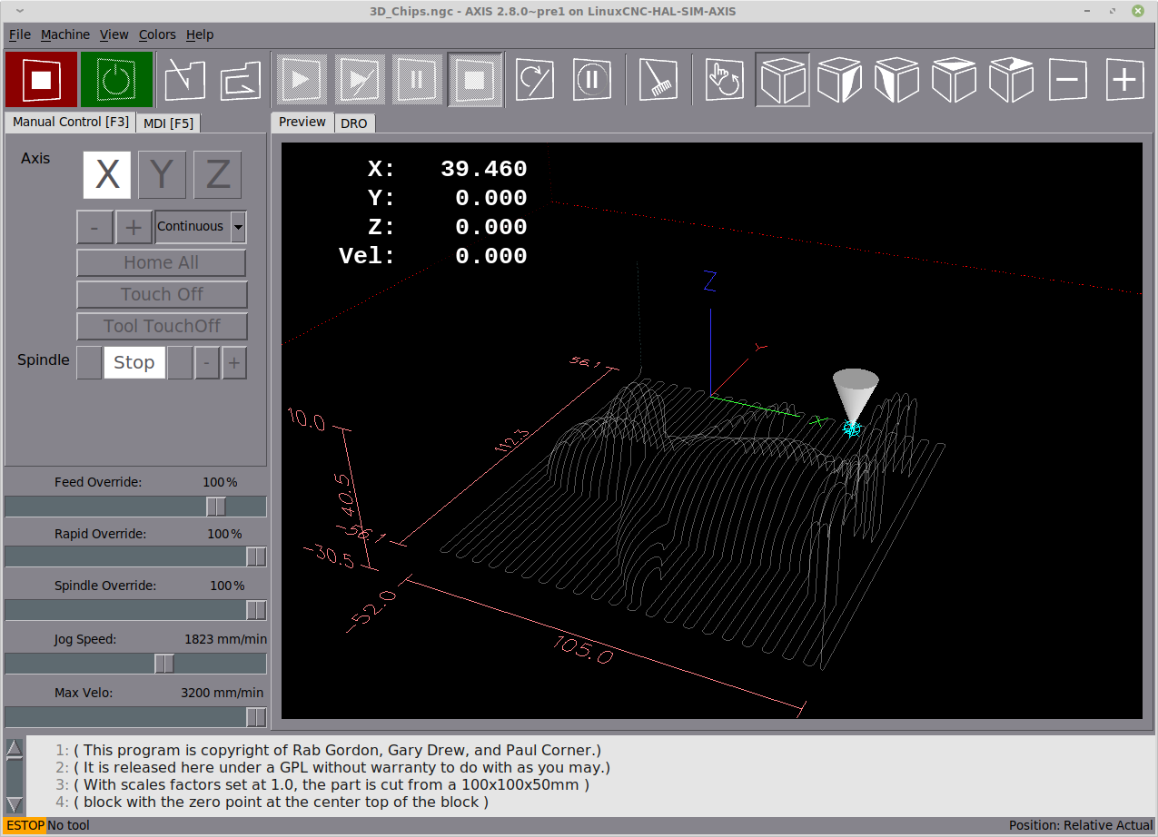

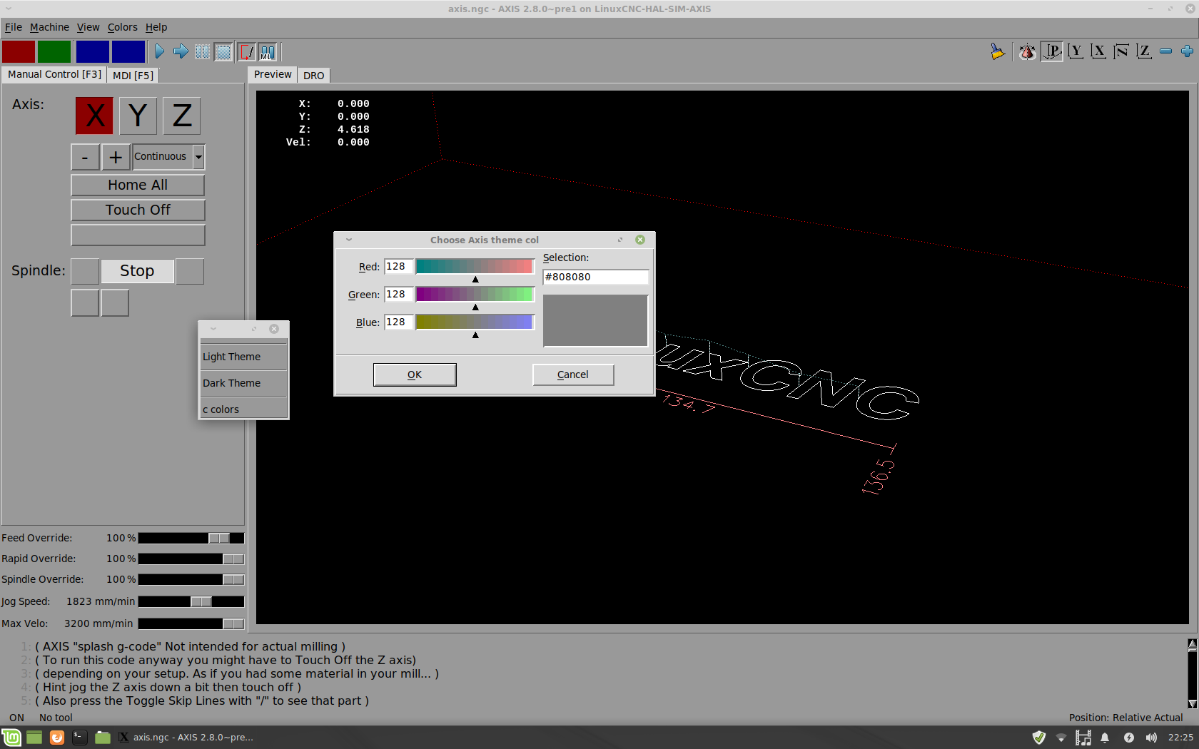

there is a color choice menu item dose this seem feasable for touch users to exaggerate colors

25 Mar 2020 21:05 #161507 by tommylight
Replied by tommylight on topic Changing the openGL colors in the Axis GUI
I have just dark or light choice from the menu, and both do nothing !

Herewith example axis.tclPlease remember this is only a proof of concept.I wonder who will be interested in making axis fully customizable?I need to still define which buttons take which attributes etc.Do we need to chance fonts?Do we need to re arrange tabs and windows etc....please give it a try, see attached..... and don't forget to rename it to axis.tclsu: cp to usr\share\axis\tcl

31 Mar 2020 12:23 - 24 Sep 2023 15:22 #162248 by zack
Herewith updated tcl and icons
Last edit: 24 Sep 2023 15:22 by zack. Reason: add icons

I was wondering about putting it in LinuxCNC as Axis2, given that we often get complaints that Axis is "old fashioned" but no complaints about how it works.
