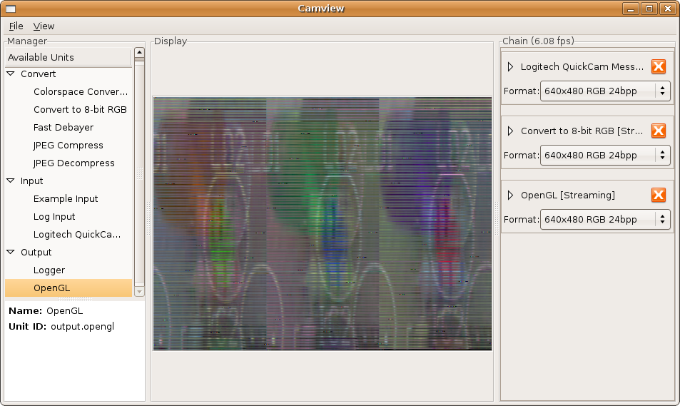

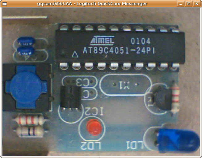

As I know the cam is one of cheap Logitech. I do not know exactly as I striped cam out of the plastic house and make another one with ability to fine align axis of cam so I get constant offset from tool. For driver I use - no driver -
I didn't install any other driver as cam work instantly. So if the driver is installed is without my knowledge.
Is there some commandline to discover what cam is actualy connected?
The design of camera is like tinyurl.com/349tony

Driver is inside linux kernel
So you need to check loaded modules
lsmod | grep video
lsmod | grep gspca
First command will also include video drivers but not many.
I suspect gspca driver so last is to check it
Also 'lsusb' command will show you connected devices.

that's results
slavko@emc2:~$ lsmod | grep video
videodev 25856 1 gspca
v4l2_common 16384 1 videodev
v4l1_compat 12164 1 videodev
slavko@emc2:~$ lsmod | grep gspca
gspca 625764 0
usbcore 119348 5 snd_usb_audio,gspca,snd_usb_lib,ohci_hcd
slavko@emc2:~$ lsusb
Bus 001 Device 002: ID 046d:08da Logitech, Inc. QuickCam Messanger
Bus 001 Device 001: ID 0000:0000
slavko@emc2:~$

Please upgrade libcamunits6 and camview-emc packages.
I've added support for 'strange' cameras yesterday.

I've fixed issues with V4L1 driver and it working fine for me (with vivi driver), without interlacing.
Also i've built camview-emc and friends (everything except HAL integration) so you may try it tomorrow.

I tried but still not working
20 Nov 2010 16:36 #5466 by eslavko
Replied by eslavko on topic Re:Another tab for WebCam
image should be:
