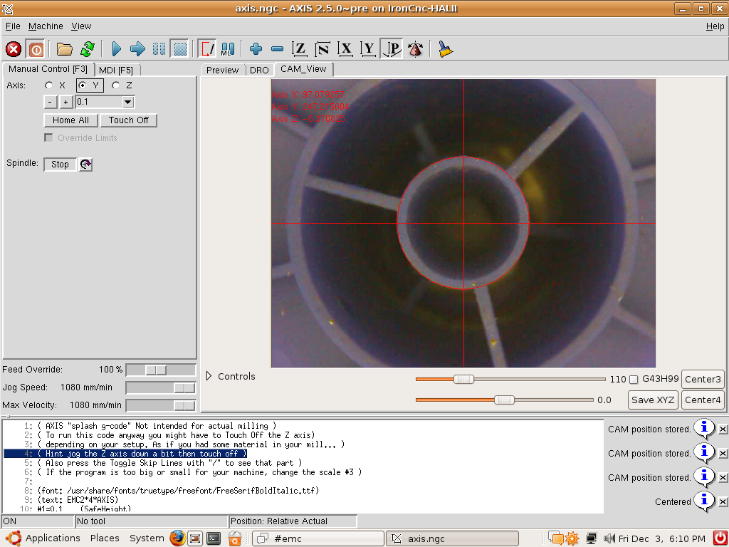

So here is some results.
All button's now work. And little explanation What can do and how.
The top slider resize aperture (circle here in image but can be paralel lines too)
The botom slider change angle of aperture (usable with paralel lines as aperture)
G43H99 checkbox Just do what is says. Ie introduce offset for camera (is not mounted on spindle) and move machine to camera just see position was under the tool. (When unchecking the all is done in reverse - the tool goes where cam was)
SaveXYZ Button just save coordinates to the file (log) so some tracing is possible and some other things can be done too. The last 4 coordinates are saved in internal variables too.
Center3 button means that clicking on that machine find center of circle from last 3 points and Center4 button is for centering with 4 points (top, bottom and left, right).
All that with great help from Pavel Shramov (psha) Thanks.

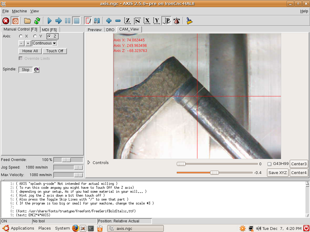

07 Dec 2010 16:47 - 07 Dec 2010 16:54 #5911 by eslavko
Replied by eslavko on topic Re:Another tab for WebCam
As few people ask me to publis how I get folowing interface here is How it's done.
(just little comment on picture. The micrometer is oppened to have 3um gap. So anybody can see how precise cheap webcam can be.)
The system works on Ubuntu Hardy heron and EMC2 is version 2.5.0~pre (latest 2.4.x should work too).

Every action just start that custom file located in PROGRAM_PREFIX folder.
And my files are:
_camon.ngc
When checkbox (G43H99) is checked this is executed.
It moves the machine in such way to position camera in place where tool was before.
The camera offset (from tool holder) is defined as Tool 99 offset in tolltable.
o<_camon> sub

_camcenter3.ngc
When Center3 is clicked the last 3 saved point is used to calculate circle center.
The routine isn't perfect and throw Nonsense coordinates when can't calculate it.
(in most case this is when X or Y coordinates of point lie in same line.) The machine does move to the calculated center!
o<_camcenter3> sub

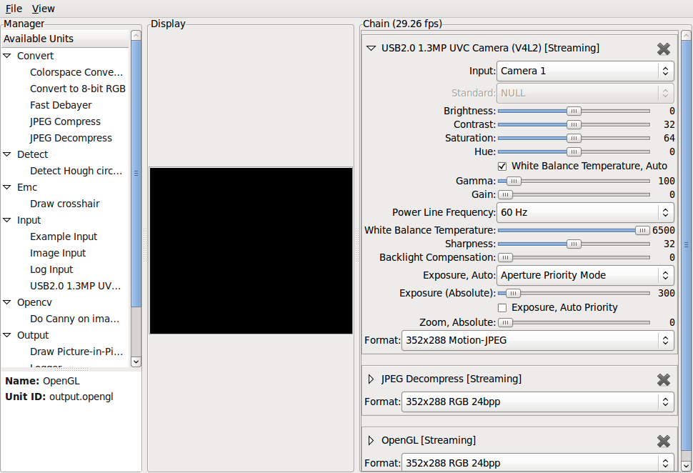

I hope somebody can help me
I loaded camview and camview-emc
See just a black window in camview
Any ideas how to fix it?
arkcnc@arkcncD610:~$ lsmod | grep video
uvcvideo 56990 0
videodev 33267 1 uvcvideo
v4l1_compat 13198 2 uvcvideo,videodev
video 17089 0
output 1773 1 video
arkcnc@arkcncD610:~$ lsmod | grep gspca
arkcnc@arkcncD610:~$ lsusb
Bus 005 Device 001: ID 1d6b:0001 Linux Foundation 1.1 root hub
Bus 004 Device 001: ID 1d6b:0001 Linux Foundation 1.1 root hub
Bus 003 Device 001: ID 1d6b:0001 Linux Foundation 1.1 root hub
Bus 002 Device 001: ID 1d6b:0001 Linux Foundation 1.1 root hub
Bus 001 Device 002: ID 04f2:a133 Chicony Electronics Co., Ltd Gateway Webcam
Bus 001 Device 001: ID 1d6b:0002 Linux Foundation 2.0 root hub
Last edit: 26 Mar 2011 23:48 by Andy123.
27 Mar 2011 05:48 #8138 by psha
Replied by psha on topic Re:Another tab for WebCam
I've added section about finding out which component is failing.
psha.org.ru/b/camview-emc.html#_troubleshooting
What if you try example/vivi instead of your cam?
27 Mar 2011 11:19 - 27 Mar 2011 11:20 #8147 by Andy123
Replied by Andy123 on topic Re:Another tab for WebCam
As far as I know camera works just fine, since I am using with Skype on the same computer
vivi and example input giving me black screeen
So my guess will be OpenGL issue
After I posted this last night I tried different configurations
In some combinations I was able to get a frozen picture for a short time, but this was not consistent at all.
I can try other ideas if you have them
Spasibo!
Last edit: 27 Mar 2011 11:20 by Andy123.
