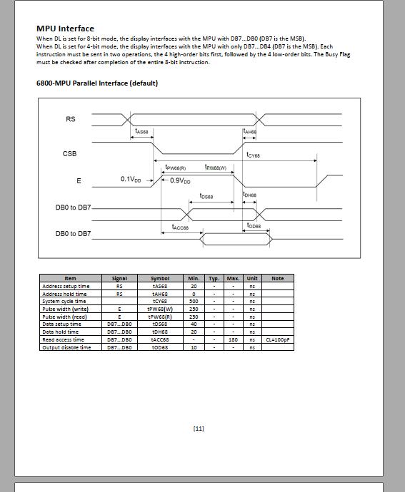

The OLED is about 50 times slower
? I'm amazed, I compare the timing interface of oled ea w204 xlg and lcd dem20485 fgh,
it's very similar: data setup time and data hold time for example
curiously I do not know the timing of the thread Andy does not specify
in his test:
forum.linuxcnc.org/27-driver-boards/3385...isch?start=20#105606
my motherboard is very fast, i3 7100
in his test:

What is your servo thread rate ( I was testing at the default 1 KHz)
(the CPU speed is not important)
The slow timing on the OLED is the maximum time to process commands
600 usec on the Newhaven and in the 10s of usec range on LCDs

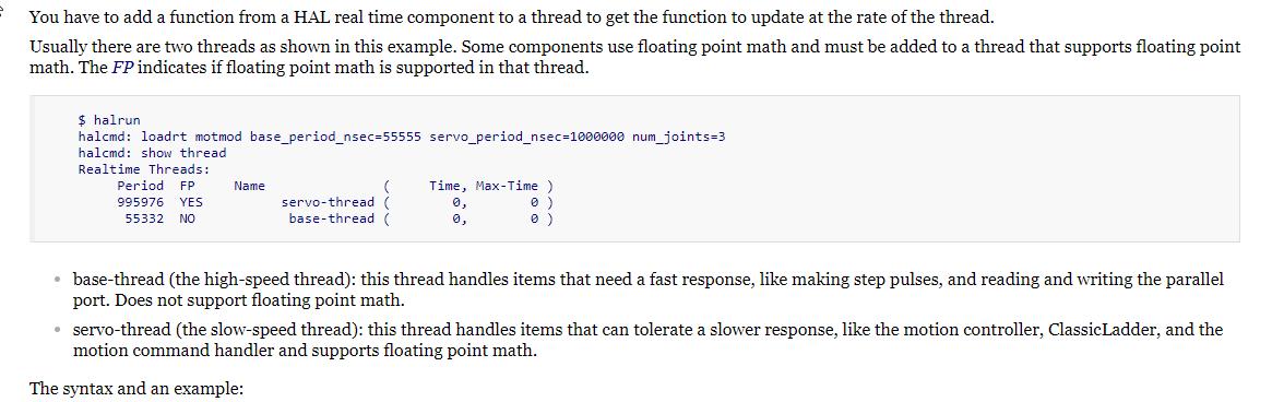

500 000 ns at 1000 000 ns i have error message smartserial card ...eztc etc 7i73 remote fault with linuxcnc
I repeat again one faith I use the test of andy or it does not fix the servo thread
and I can not load "loadrt motmod etc ..." I can not find an example of syntax
andy test is here:
600 usec sur le Newhaven no 600 nsec
andy test is here:

First I would figure out why you cannot run a 1000000 ns (1 ms ) servo thread
since this is the default servo thread time.
Edit are you sure you tried 1000000 ns not 100000 ns? 100000 ns would definatley fail
The 600 usec max time is listed in the "Table of commands" page 7

I use 2.7.14 wheezy
thank you for helping Peter
on occasion if you could only test the Andy's little program in a terminal without axis
and try to include the "loadrt motmod line" to set the servo-thread

Not sure why i would add motmot since I am not testing motion
I will try the halcmd script Tuesday
My setup is:
hal file with LCD/net commands setup to pipe lcd comps char out to 7I73
LinuxCNC 2.8
And I see no cursor issues (cursor is turned off when LCD component starts)
