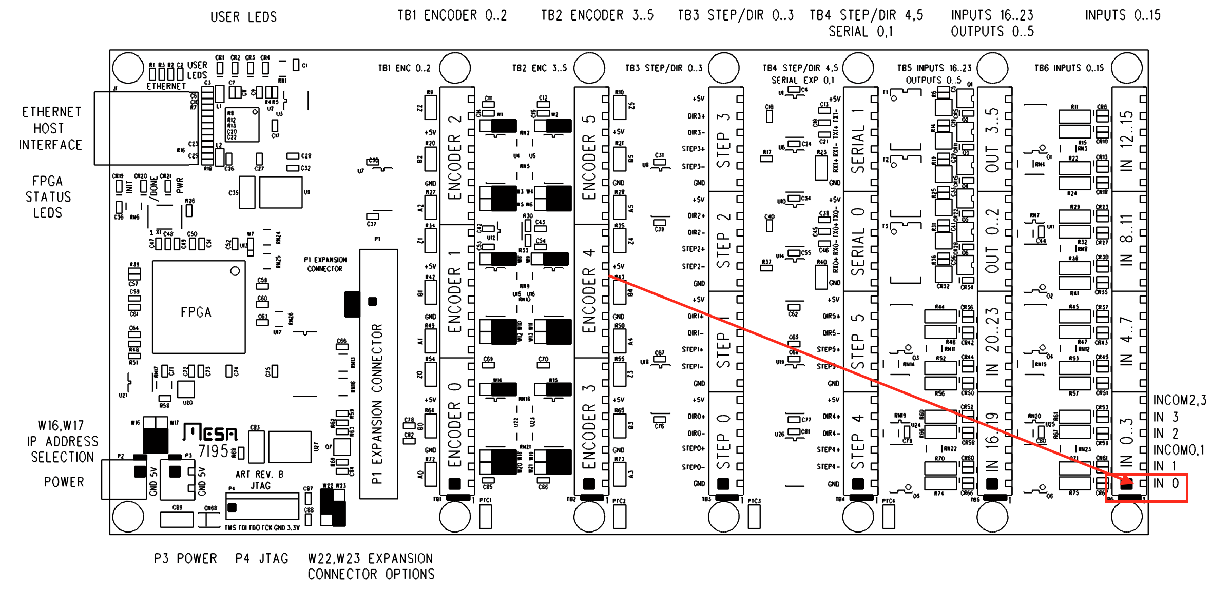

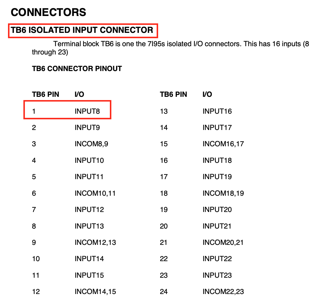

29 Nov 2019 23:06 #151534 by PCW
Replied by PCW on topic Mesa 7i95
I also see a manual error (probably a copy/paste error from the 7I97 manual )
TB6 pin 1 is input 0, not input 8
1 IN0
2 IN1
3 INCOM0,1
4 IN2
5 IN3
6 INCOM2,3
etc
