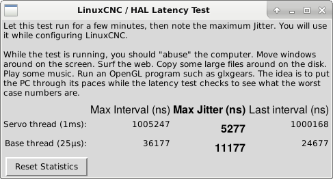

Latency test is aprox 5000 ns max jitter. using firefox playing youtube videos while i use the pc normally.
The power supply is from an old pc. I tryed with 2 different but tomorrow i will search something "smaller". What is the max voltage that the mesa card accept? is written 5v, but 6 will already kill the board?

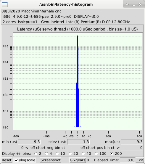

What PC?
Run a latency test and post a screenshot of it
latency-histogram --nobase --sbinsize 1000 --show

Hi, there is the latency test.

The PC seems good and latency is very good, but that bring the next question:
