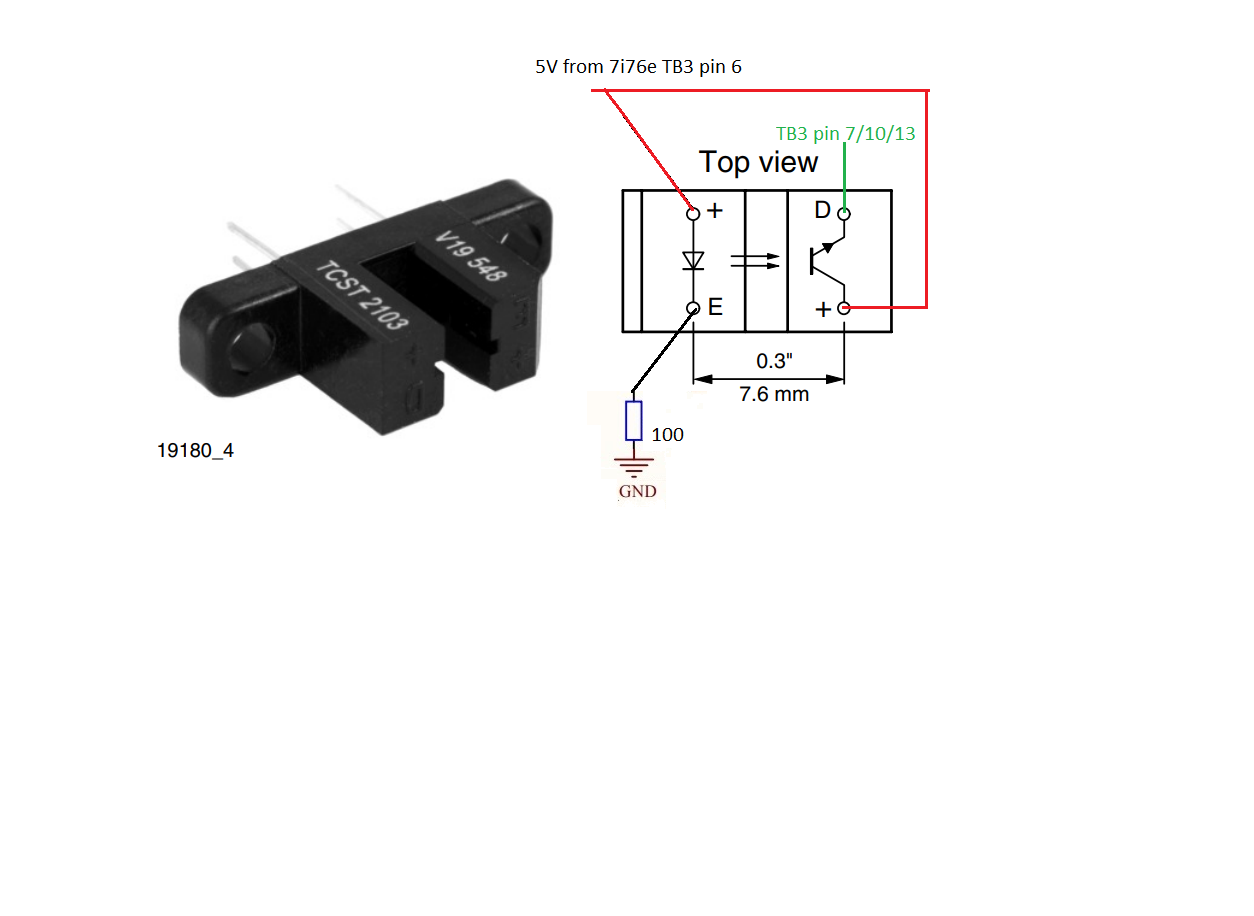

Hi
Can you help for encoder wiring to 7i76e ?
I have try with same wring as my old card (working finr)
Burned 2pcs Tcst2103, for now only A is not burned so i try to test with only this one
7i76e jumper set to single end encoder.
www.vishay.com/docs/81147/tcst2103.pdf
It is correct ?
Br

Replied by PCW on topic 7i76e and opto ancoder TCST2103
Yes, that will work for a "A" only encoder
A ~120 Ohm LED current limit resistor should be about right (~35 mA LED current)
considering the 10-20 current transfer ratio and the 2K pullup resistors on the encoder inputs
Wiring:
+5V --> 120 Ohm --> TCST2103 LED anode --> GND
TCST2103 Collector --> 7I76E ENCA (ENCB,ENCIDX)
TCST2103 Emitter --> GND
Wiring:

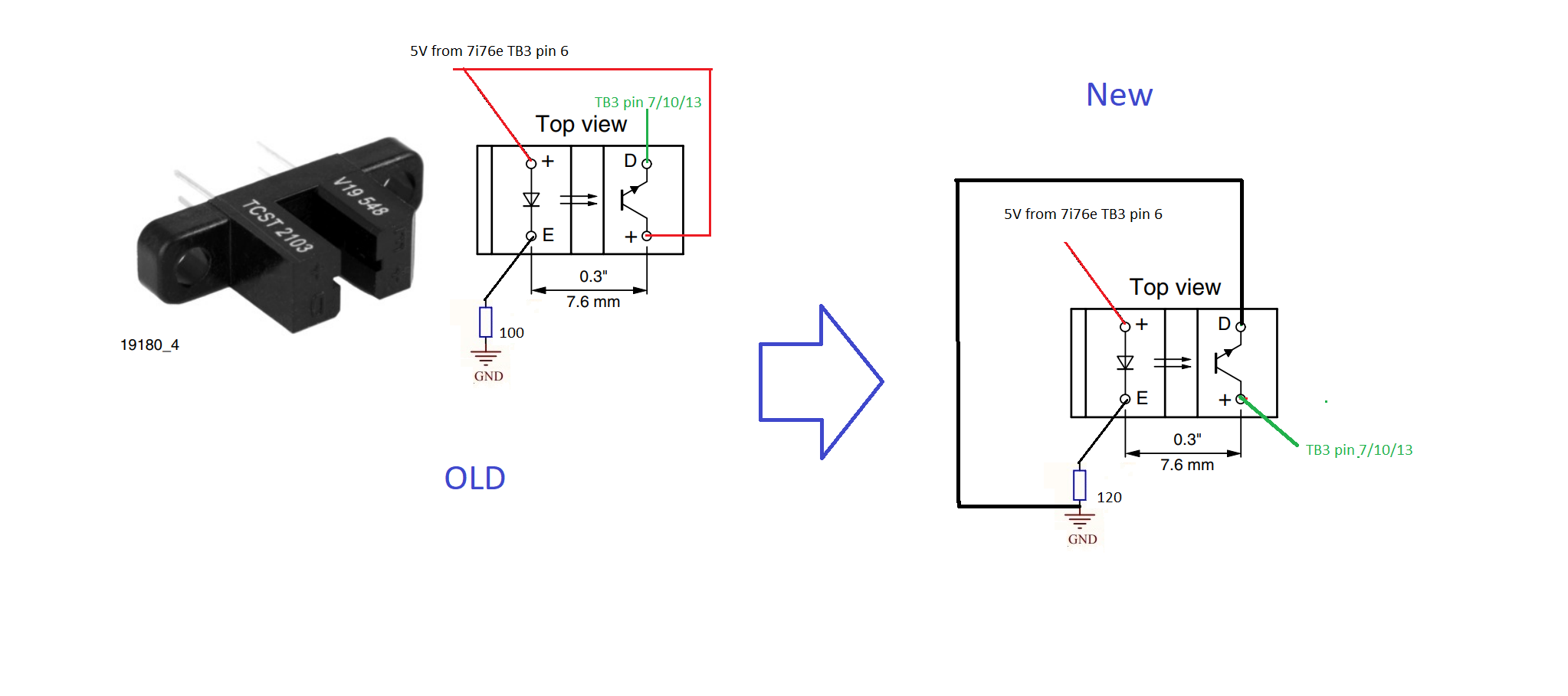

01 Mar 2020 20:14 #158907
by alkabal
That looks right, though I would probably put the 120 ohm resistor in the positive side of the LED
so if you accidentally ground the LED cathode lead you dont destroy the LED

Replied by alkabal on topic 7i76e and opto ancoder TCST2103
I'm really happy at the end the 3 TCST2103 work fine !
Many thanks for wirering information.
