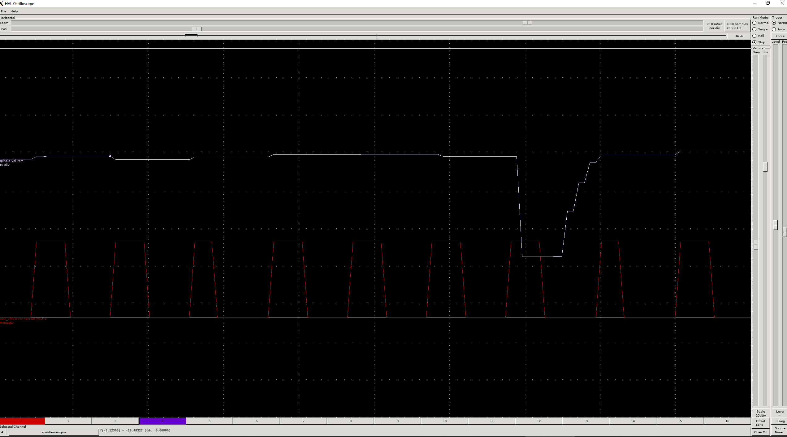

10 Mar 2020 18:39 #159683
by alkabal
Well you mean increase the 120 ohm resistor ?
halscope with something like 30 rpm is possible but need to test all mode ? (filter/counter/sample-frequency)
the reverted input is not a problem ? (especially for index ?)
Replied by alkabal on topic 7i76e and opto ancoder TCST2103
One change is that you had a 560 Ohm load before and now have a 2000 Ohm load
This may have affected the quadrature symmetry. You may be able to adjust this by lowering the LED current.
Note that you cannot actually see the quadrature signals accurately in halscope unless
you rotate the spindle very slowly
- Posts: 18116
- Thank you received: 5335
10 Mar 2020 18:41 #159684
Replied by PCW on topic 7i76e and opto ancoder TCST2103
Yes, you can invert the index, its one of the encoder parameters
It may simply be that running the 7I83 from the KBMG 15V is not practical
Having a "hot"= floating at line voltage analog control is a problematic
It should have worked with an external supply. I suspect your supply was not isolated hence the line power short

10 Mar 2020 19:19 #159690
If you look at the right side of the trace it very close to violating quadrature
you may be able to mechanically adjust this or adjust the symmetry with the
LED current, I suspect a quadrature violation is why you have the 0 velocity spikes.
As far as isolated power supplies go almost any transformer based
wall adapter should work, but should be verified with an Ohmmeter
on the megohm range
on the megohm range

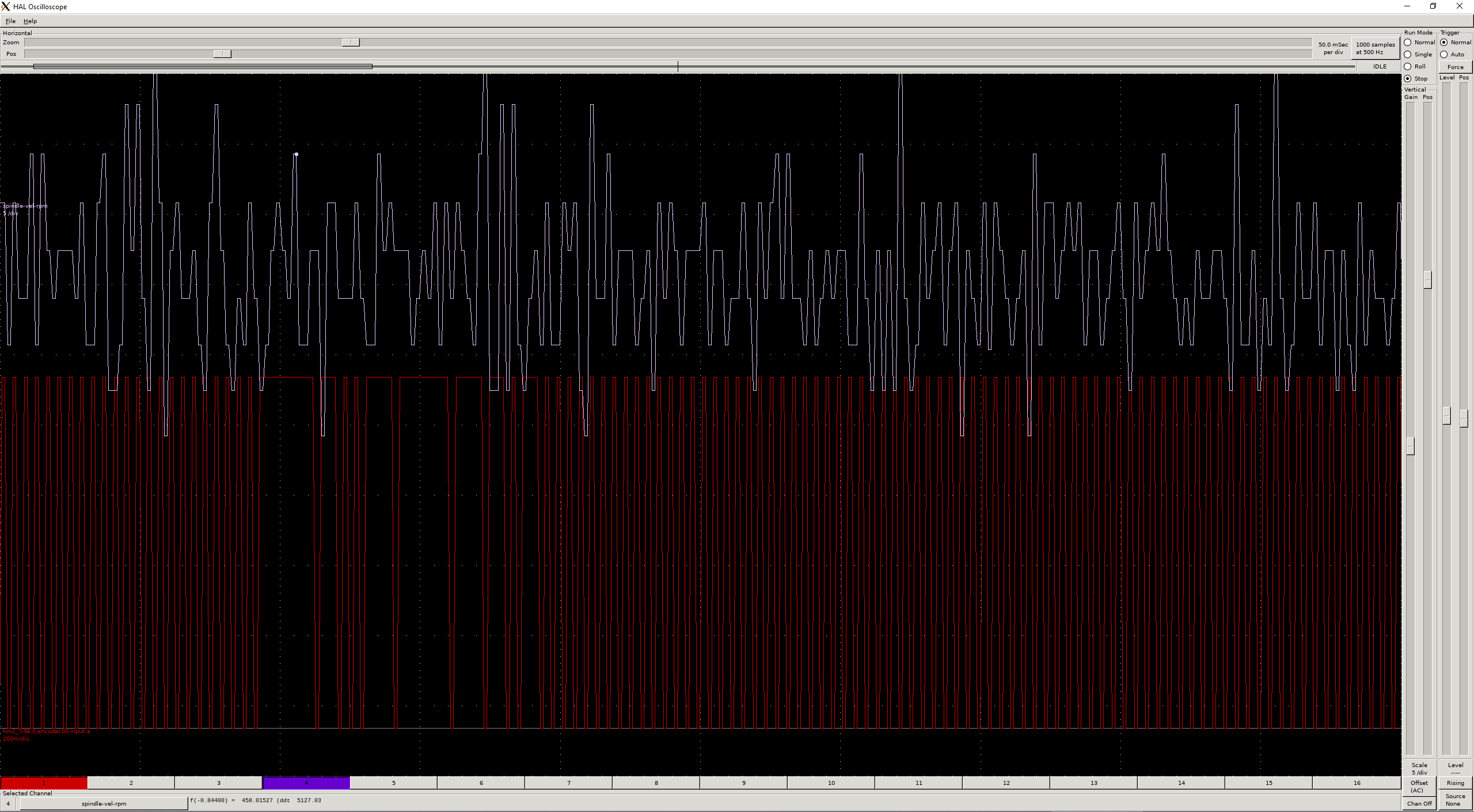

10 Mar 2020 21:24 - 10 Mar 2020 22:14 #159701
by alkabal
Wall adapter isolated found
Found the parameter
setp [HMOT](CARD0).encoder.00.index-invert 1
trying to sets spindle-index-enable 1, turn the spindle = does not reset the index-enable (sensor is ok checked by multimeter)
I have unconnected encoder B
set to counter mode 1
speed near 30rpm
200 ohm resistor for led
speed near 450 rpm
Found the parameter
speed near 30rpm
speed near 450 rpm
Last edit: 10 Mar 2020 22:14 by alkabal.
- Posts: 18116
10 Mar 2020 22:31 #159706
Can you post your hal/ini files? looks like something is really broken there

- Posts: 18116
10 Mar 2020 22:52 #159708
Can you look at the encoder velocity pin to eliminate other possible problems
also, if you have a 1 KHz servo thread you should use 1 KHz for Halscope
so you dont miss things
