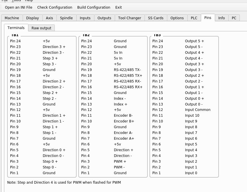

Not 100% sure how to enable it. From
BigJohnT
's 7i96 config tool, I am supposed to wire one of the outputs from the 7i96. I am not sure how to wire that to the SPINX, or the voltage. Each output has a + and a - side. I am not really sure at all what the voltage output would be or how to wire it.
Here is what I have wired:
-5v from power supply 1 GND
FREE 2 GND
7i96 PWM 3 PWM ACTIVE HIGH
FREE 4 ENABLE ACTIVE LOW
7i96 dir 5 DIR HIGH = CW
+5V from power supply 6 +5V
FREE 2 GND

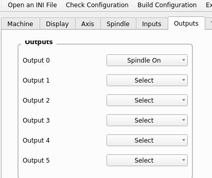

Since there are no free pins for the enable, I would drive it with a SSR output:
Say OUT5+ --> SPINX1 enable
OUT5- --> GND
OUT5- --> GND

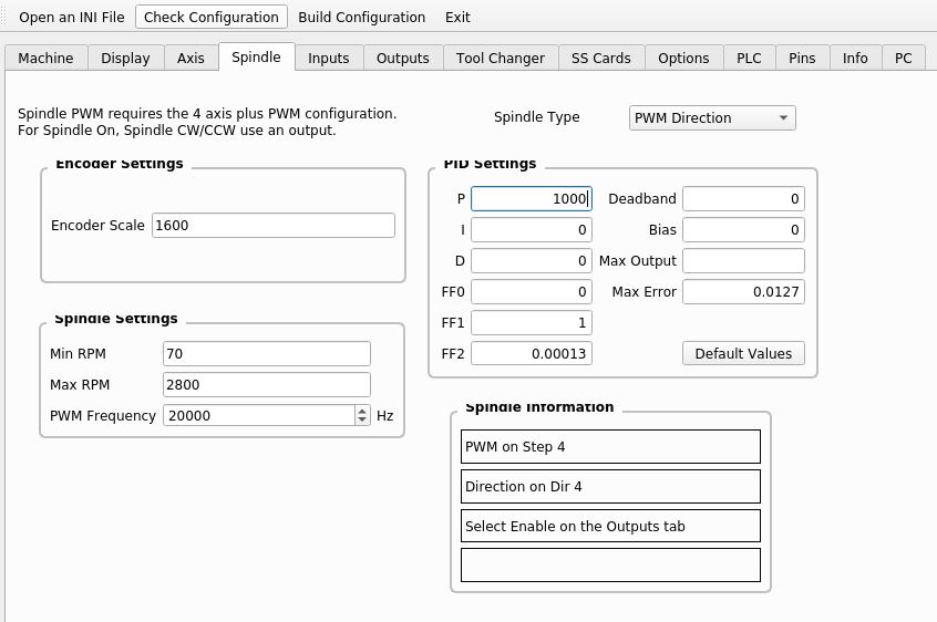

I have attached pictures how I have it wired, and how I configured it in the 7i96 config tool.
I am not sure about the frequency, since the mesaflash output in in MHZ, while the config tool is in Htz, is this correct? I am not sure what value I should be using.
The direction LED stays on, the enabled is on when I hit the turn CW or CCW button, enabled turns off when I hit the brake, but I am not seeing anything for the speed LED. I am assuming to use the positive DIR and PWM pins. I do see the speed increase in the Hal Watch, but it is as if the SPINX isn't getting the signal or processing it.
I am also having some issues with the 7i96 config tool I will put up another post dealing with that.
Thanks for your help

The PWM frequency should be set to 5 KHz in the utility
If you dont get PWM output, it would probably be best to
post your hal file here to see where the issue lies..
