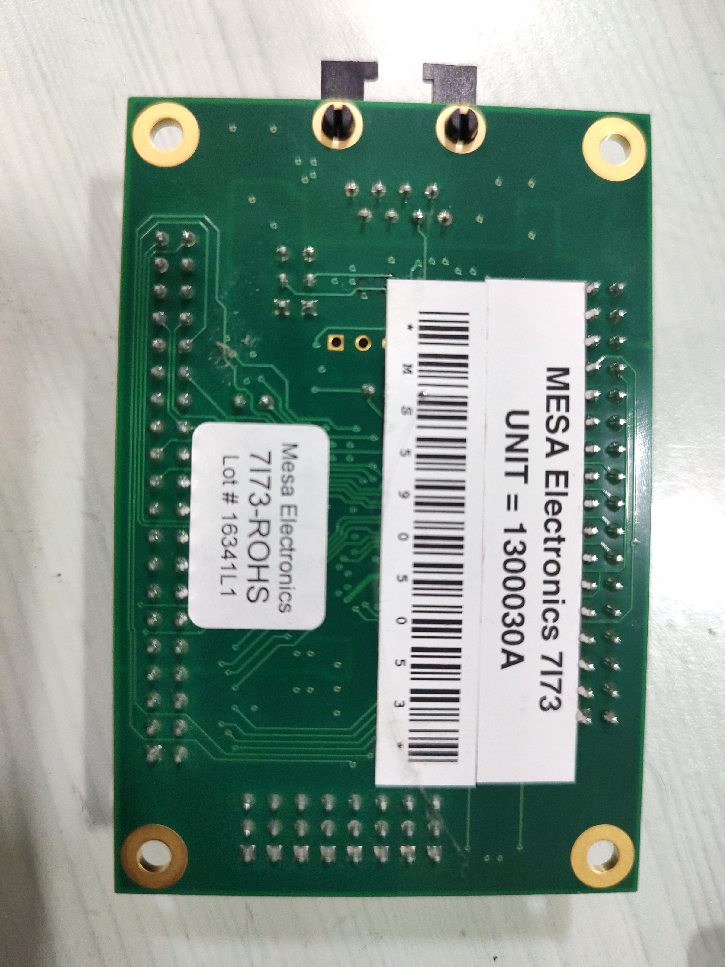

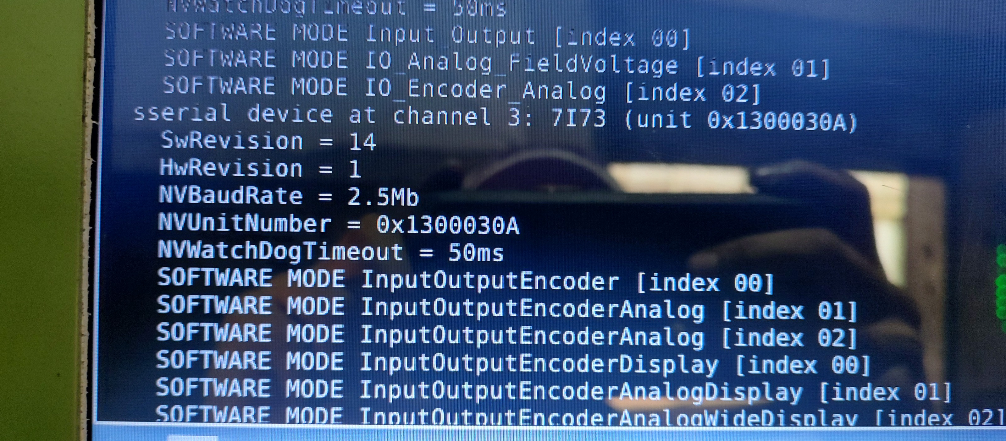

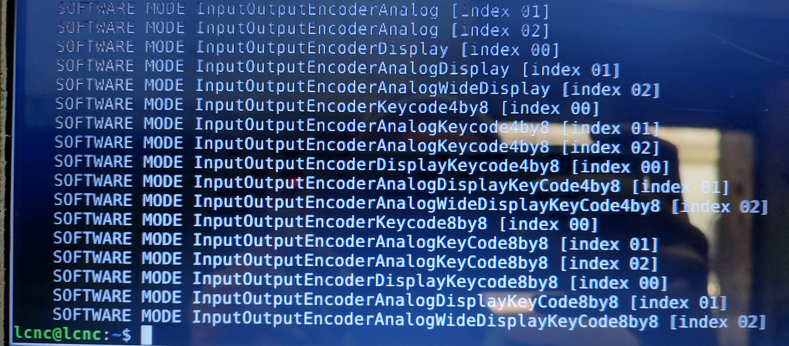

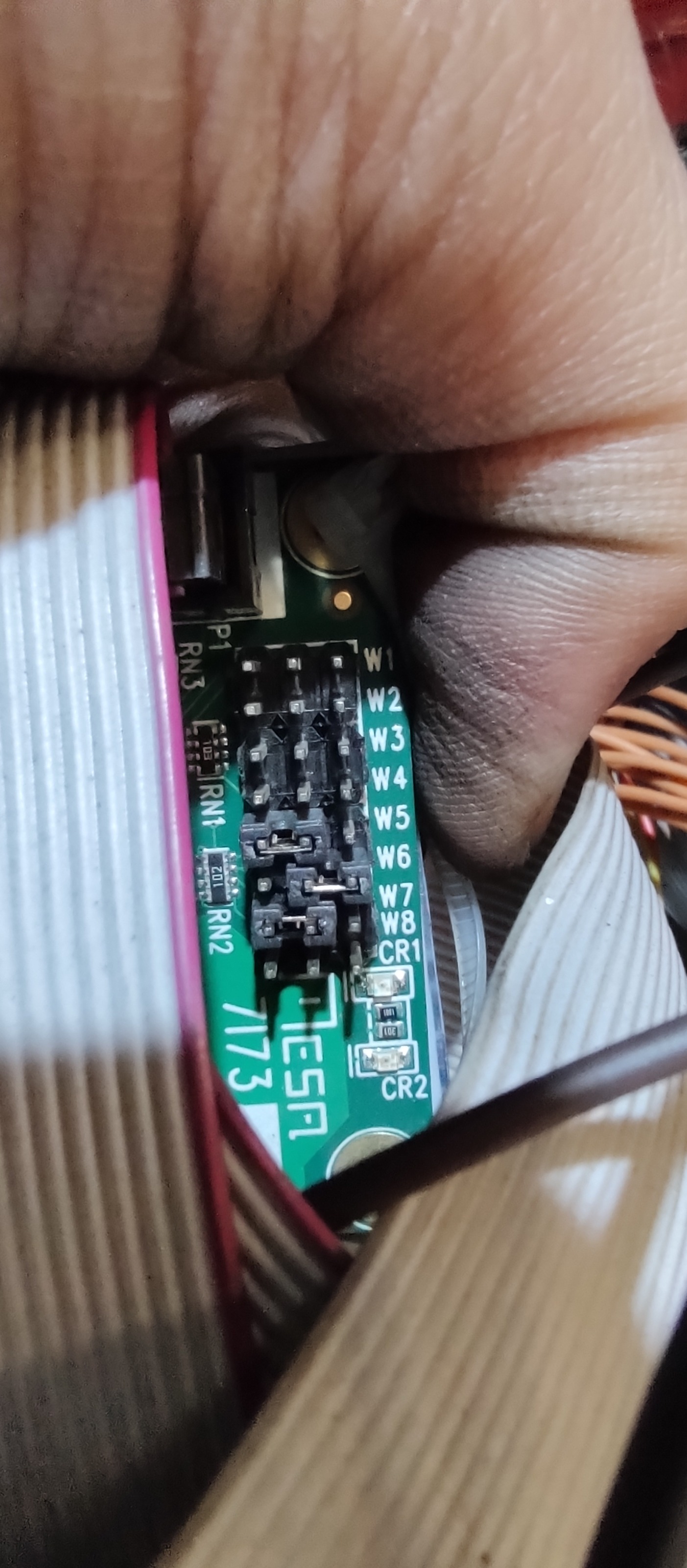

I have setup mesa 7i73 in 4x8 keypad no lcd mode but i am not able to get inputs that only associated with column 0(key 8 pin 11 of P1 connector) i have checked pin 11 is not shorted with any other pin and i also checked from switch to pin 11 (6th pin out side ) and it's show continuity on each switch here i am attaching some pics

24 Jan 2023 22:01 #262836
Replied by PCW on topic Mesa 5i24-25 stucked
Sounds like maybe a wiring error or cable issue

25 Jan 2023 03:25 #262852
by yrsiddhapura
Replied by yrsiddhapura on topic Mesa 5i24-25 stucked
@pcw yes it might be but like I said i checked continuity of connection from 7i73 pin 11(back side of 7i73 all cables connected) to switch and it shows continuity and 0.1 resistance which means there is no problem in connections and also checked if any pin is shorted but still it's there is no evidence of it so i swapped board with another 7i73 but still same problem

25 Jan 2023 04:59 #262857
Still sounds like a wiring error. I verified that all column 0s work
(P1 pin 11 to 7,8,9,10 =R0C0,R1C0,R2C0,R3C0)
