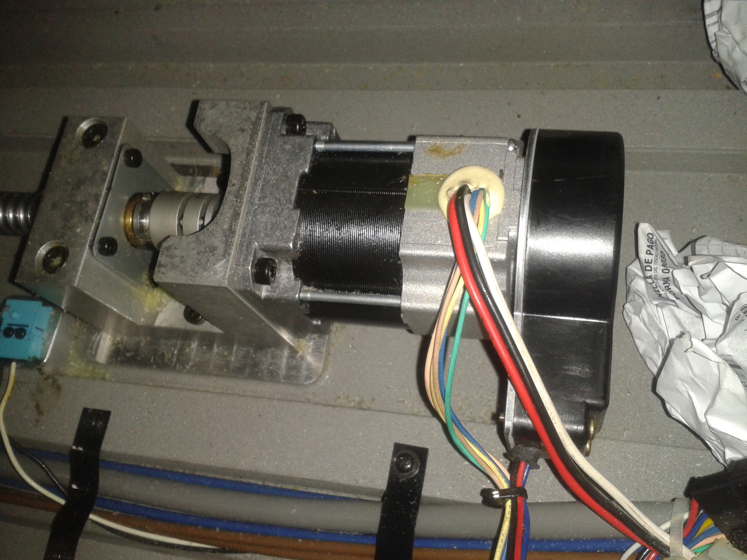

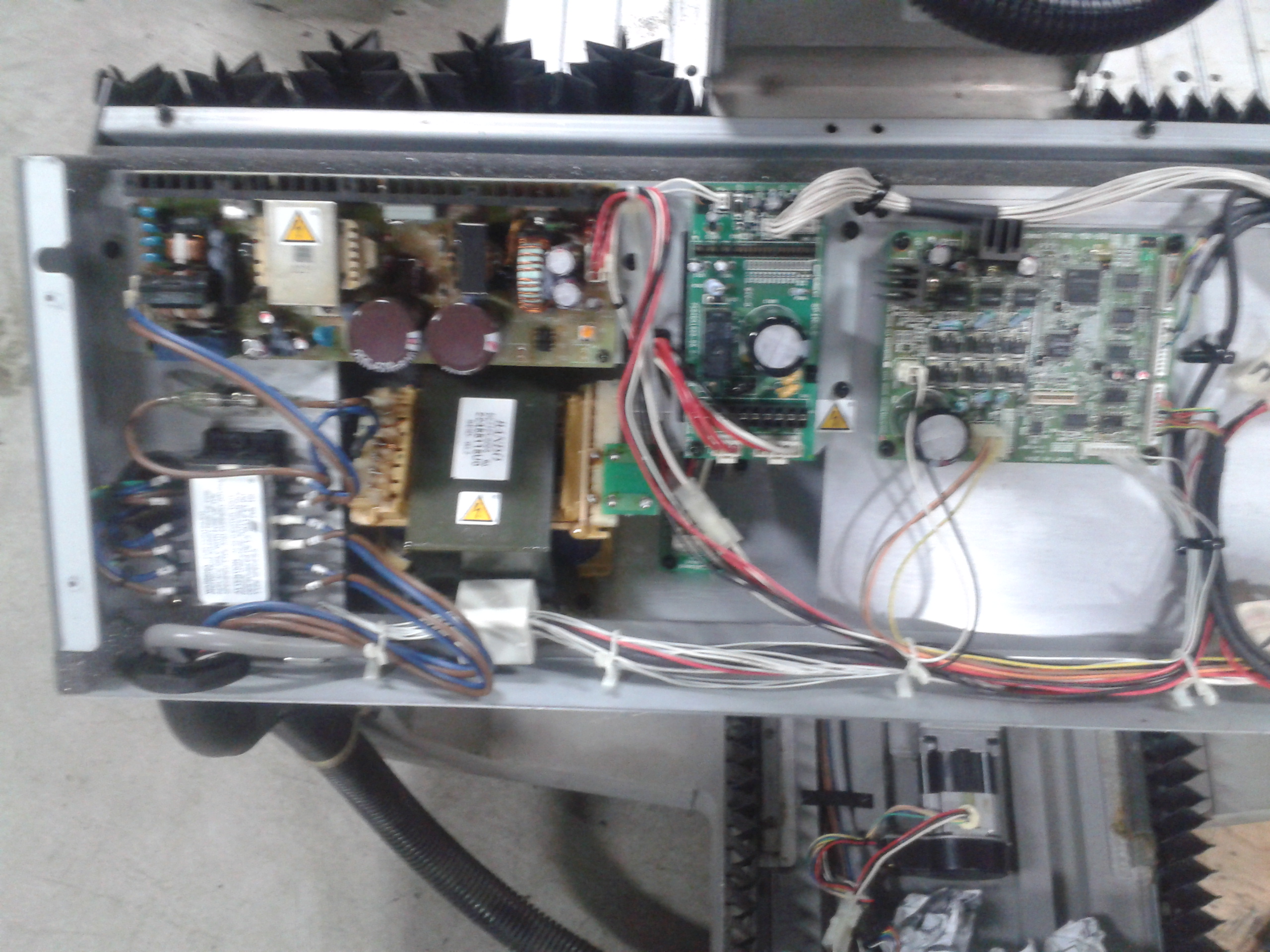

greetings to all.
Today annoyed with this little machine, buy it at a great price considering LinuxCNC ... as the solution.!
But I realize that not have the main card. This board controls all servomotors.
ac-servomotors
dc-spindle
so I have servomotors, encoders but I have no drivers.
my question is I can adapt some other drivers or is it better to buy servomotors and new driver.
roland consider the option, but I failed communication with them.
thanks in advance for your help.

Replied by andypugh on topic Roland mdx-650a question
They look like brushless DC servo motors with Hall sensors and Encoders.
Do you have any idea what voltage and current they work on?
[Edit]
A bit of web-searching says that they use AC servos on the axes and a 400W DC-brushless motor on the spindle.
As far as LinuxCNC is concerned a DC-brushless motor and an AC servo are exactly the same thing.
400W is a bit much for the Mesa 7i39, which would have been my first suggestion.
It also a bit low for the 8i20, espcially if the supply voltage is < 50V.
Maybe the Pico amps? www.pico-systems.com/acservo.html

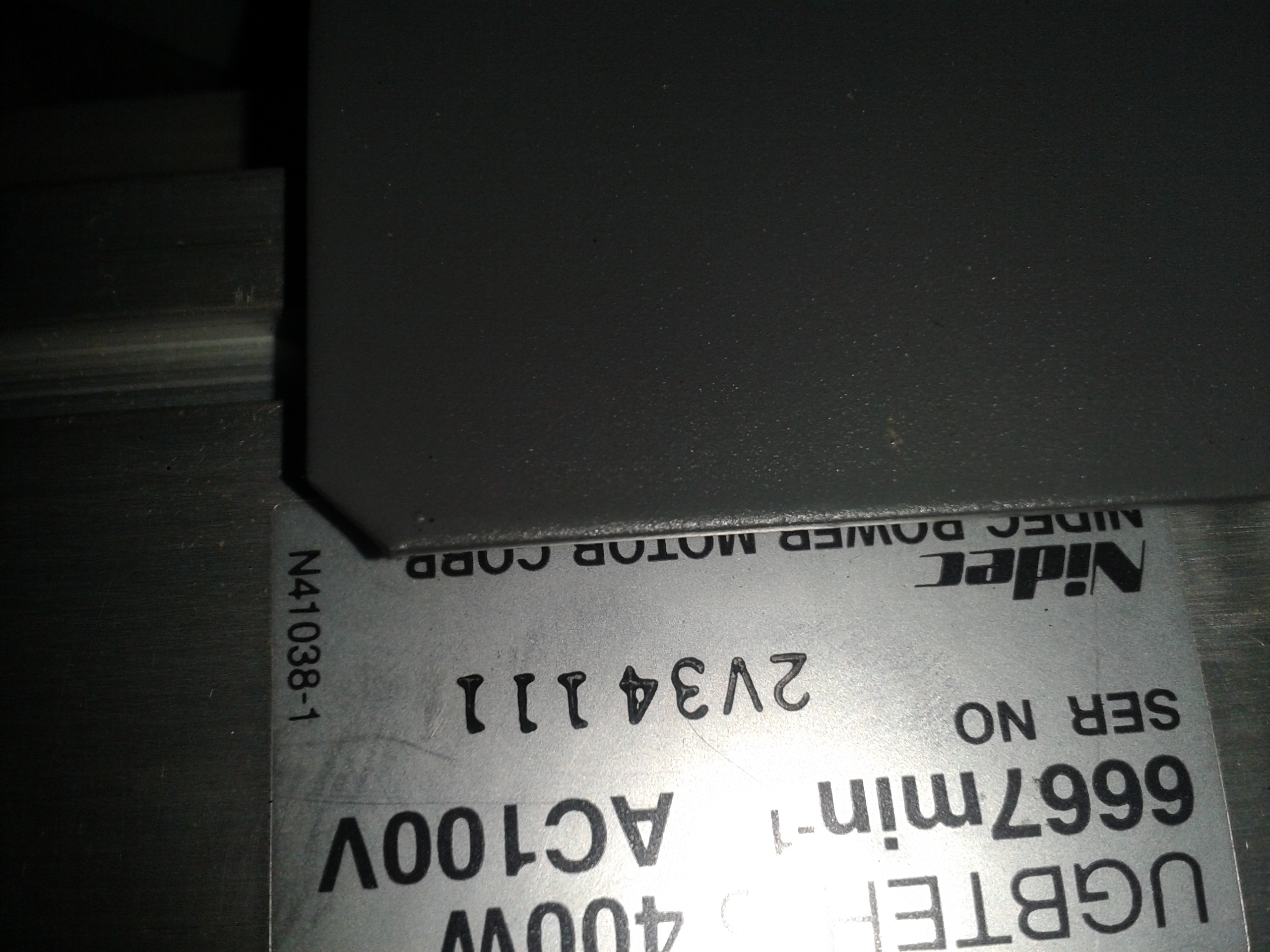

Andy, greetings .... thanks for your answer.
MIra this machine has information but nothing about servomotors have neither plate nor information anywhere.
in the brochure and internet product say they are AC-digital-servo and spindle is the DC-motor.
but looking at the spindle motor I realize that says AC100V 400W.
This totally confuses me. know I'm not the most expert in these matters.
the brochure accompanying the machine.
www.rolanddg.com/PDF/mdx-650.pdf

13 May 2013 00:10 #33963
The Spindle motor appears to run at 100V, so the 7i39 would not be suitable.
Do you still have the power supply? If so, what power was supplied to the missing driver boards?
Despite the difference in the names, these types of motor are effectively identical, and can be driven by the same drives.in the brochure and internet product say they are AC-digital-servo and spindle is the DC-motor.

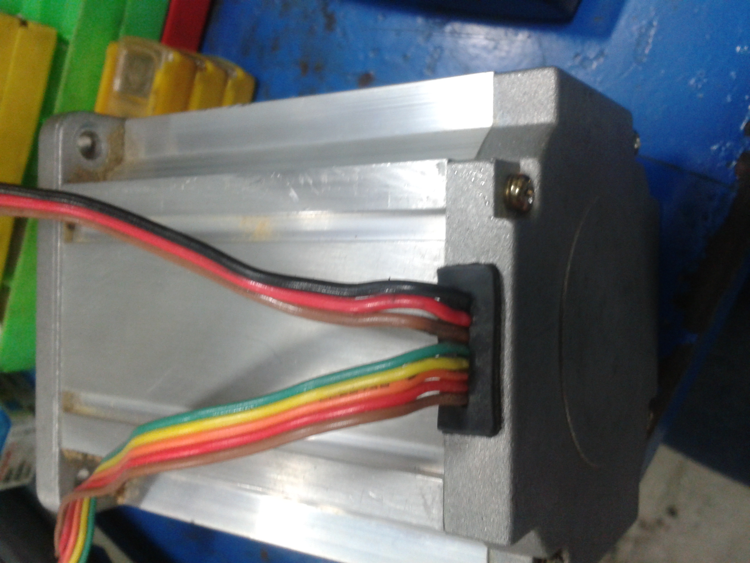

Hello,
I have a problem to connect my spindle motor.
REF = UGBTEH-5
400W
100AC
brand = NIDEC
is the one in the photo above,
is that the 3 wires (black, red, brown) are the power cables.
and the others are the SENSOR HALL.
Here is where I have the problem more I searched the internet, I wrote to the manufacturer and nothing I could define the configuration of the cable.
I have fear going to damage the motor, when connected wrong.
any idea how can know the configuration of the cables?
driver. = pwm servo de picosystem
any test?, or someone who has already worked with this brand?
thanks,
Jorge Viloria

Spotting the motor windings is easy with a resistance meter.
I am not sure how to identify the Hall sensors. Perhaps it is worth buying a hall sensor and seeing what it looks like to you muiltimeter in diode mode?
(You can also try connecting +5V to the output pin, and see if it damages it.)
If I had to guess, it would be red +5V Brown 0V, and Green, Yellow, Orange as the Hall outputs .
