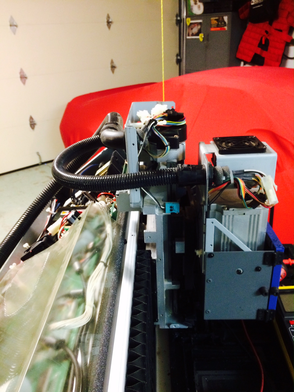

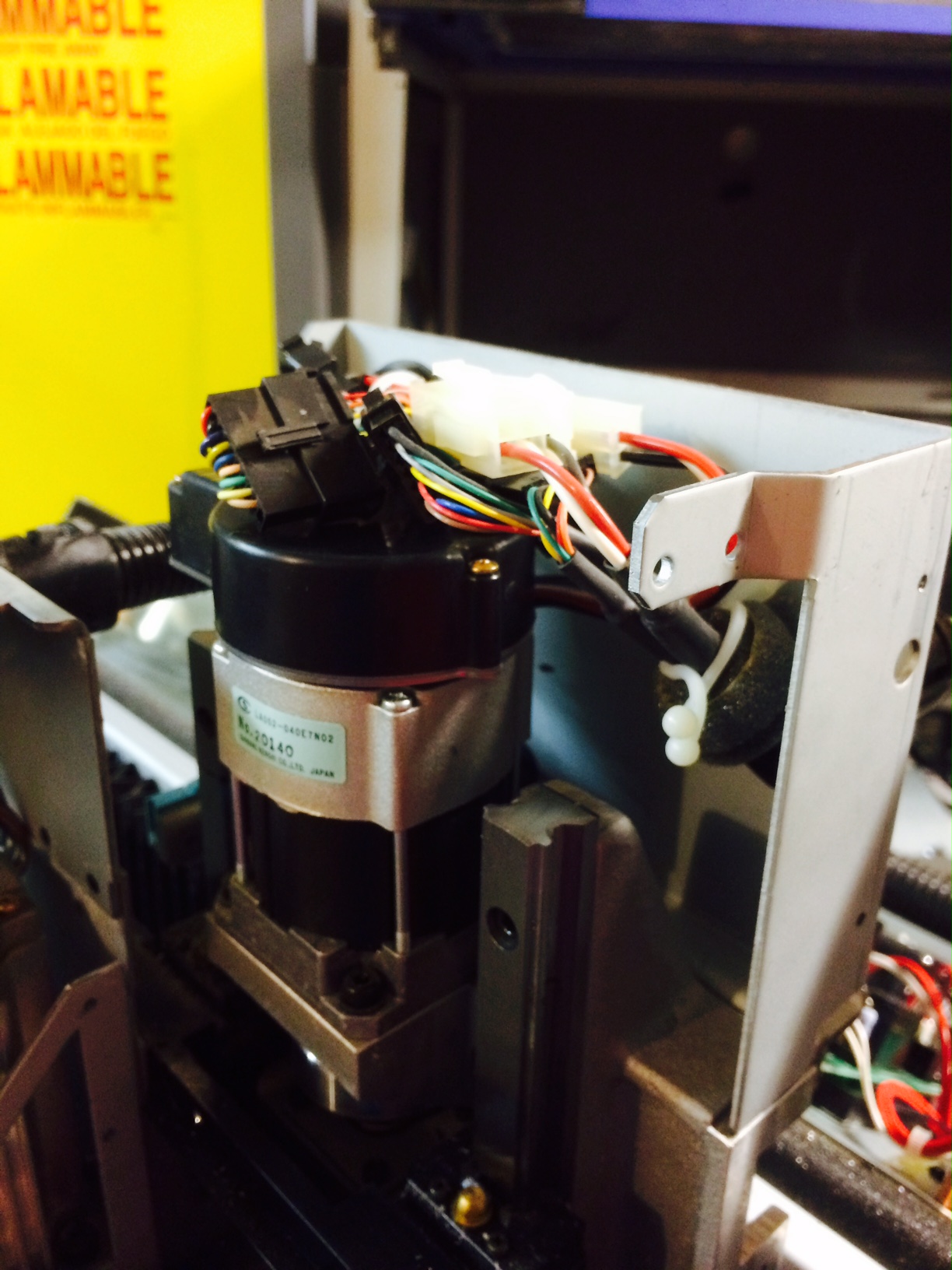

Also want to add that when I push the RCML or NC code button when the fault occurs a very slight motor clunk sounds appears on the z axis or x axis etc.. Knowing this is why I swapped the servos from the X and Y axis to eliminate those servos in trouble shooting...

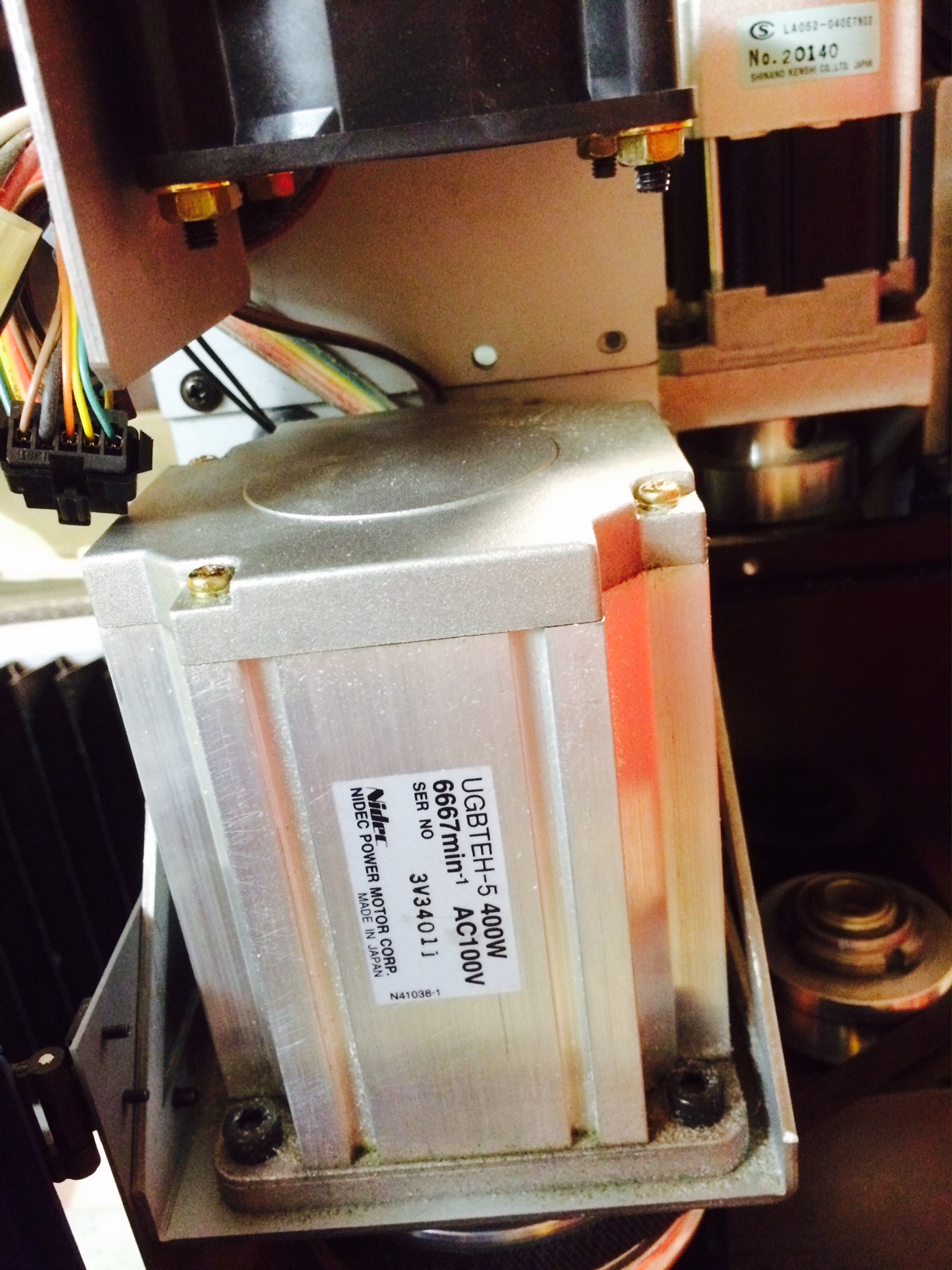

Yes either selection yields same response... I already checked all the limit sensors(switches) and they are all functioning properly. I want to possibly beef the spindle motor up. When you mentioned to disconnect the spindle motor which plugs were you referring to?

the rainbow coloured ribbon coming out of the spindle motor. Try disconnceting it

okay I disconnected the ribbon color cable and nothing changed so i reconnected it back to the spindle motor. I then removed the solenoid brake and stared the unit but same motor lock error occured. all of the positions are pretty much in neutral position so it has not triggered any switches nor is bumping into anything to give the motor stop error to occur.... yes the cooling fan does run on the spindle when the spindle is operating.

is your information on a 650... blinking does this mean an error or the board is waiting for the next step on the z axis pulling up etc.? the lock up is the main problem and the fact that the indiction on the lcd screen says the XY but the z does not move....i know that the z axis needs to move before anything else starts moving and maybe this unit errors on the XY even though the Z axis might have a problem? I am wondering if I should take the z axis servo and swap with the Y servo to check and see if this might be happening....Your thoughts.....
