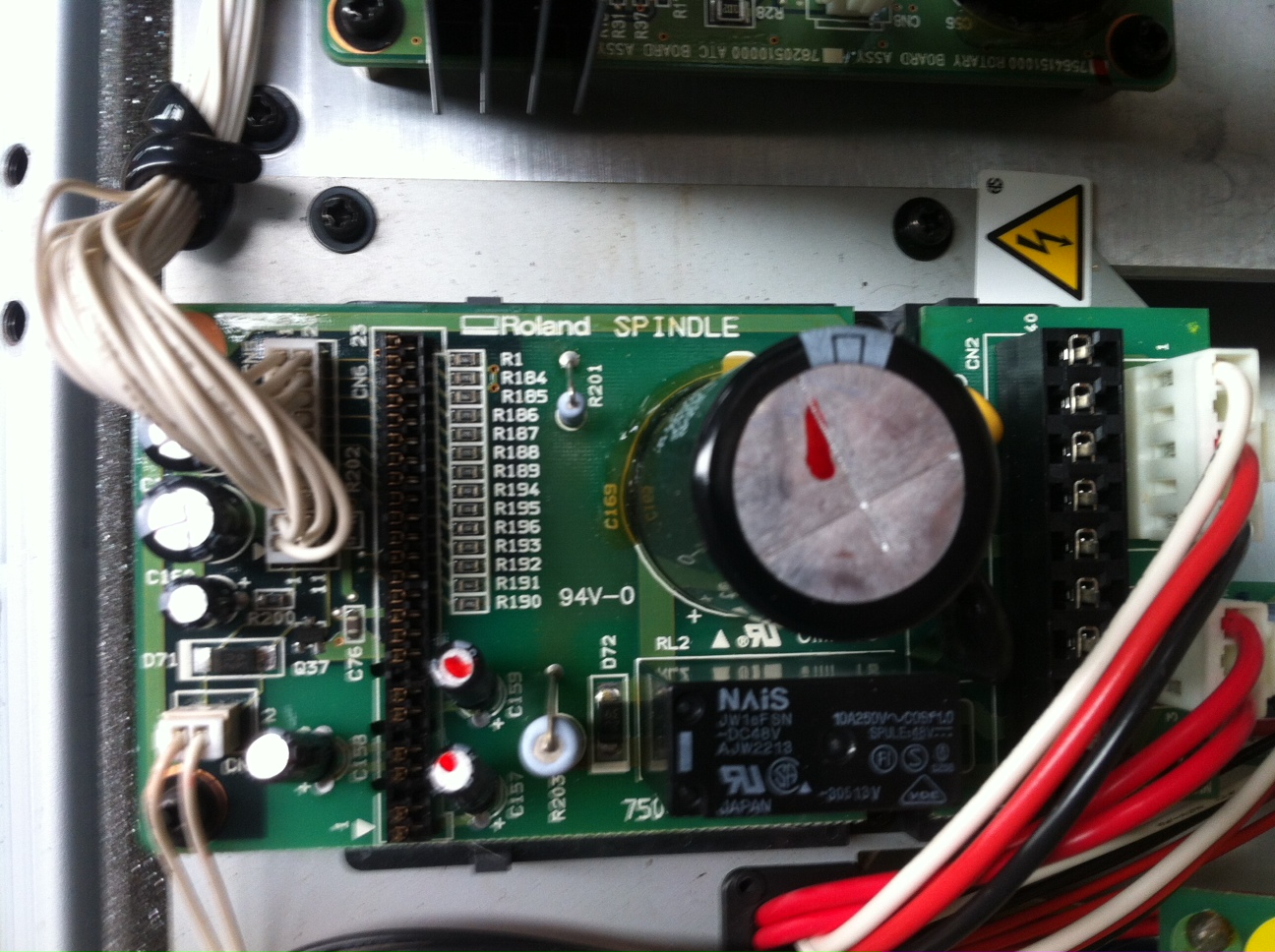

16 Nov 2013 22:13 #40879 by nick gill
Replied by nick gill on topic Roland mdx-650a question
Hi Andy and Jorge !
by chance the board does not indicate what the 5 + and GND spindle hall sensor ?
Do you want to see a picture of the spindle control board Jorge?
I am just converting my machine from 115V to 240V right now. Should be finished changing the internal configuration today.
in my case the main board was damaged
You mean the really big logic board? Do you know how this happened?
but I did it with the help of the guys
So you now have the Picosystem controlling the XYZ axes ? Can you show me a schematic (wiring) of how you did this and what the servomotors require?
Peter Urban from USOVO replied to my 600W ATC Spindle inquiry. He said "the WZW104 works with 24V and 30A. It is a different technic. You should use it almost near the top speed, less rpm are not good for use over many ours."
So I think now this is not the best spindle for me. I don't want to run 20000RPM all the time. So I am now looking for another ATC spindle. Ideas?
My current spindle (Nidec UGBTEH-5) is 100VAC , 400W, and only 6700rpm. It has 3 power wires + power/GND/3 Hall-effect wires.

18 Nov 2013 04:51 #40914 by nick gill
my mission right now is to run the Nidec UGBTEH -5.
What I need is to identify which are the hall sensor wires to know which is 5vdc and GND for connection to the PWM -drivers
Hi Jorge
I will start my machine and run it for you, looking for the wire designations.
How much was the replacement quote for mainboard from Roland?
I really hate the Nidec, it really needs to be 600W. A wimp, and slow.
What I don't understand is why does the spindle have hall sensors? It is acting like a big high-speed servo motor? If the spindle slows down, hall sensors tell controller to apply more power until the correct power/speed angle is reached ?
Do you think the Jaeger spindles have hall sensors? I wonder if the hall sensors can be adapted to another spindle?
Many questions.....
Thanks, Nick
