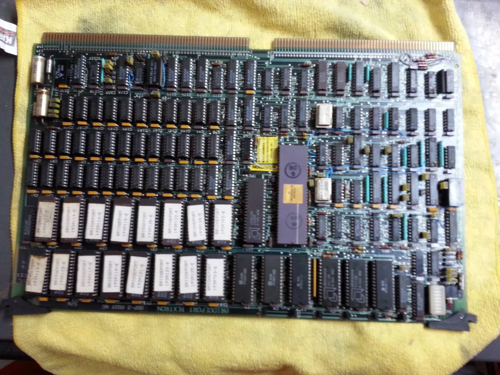

can you send pics of your drives and the the control boards on the right of them?

13 Mar 2014 16:05 #44752 by TheWylieStCoyote
Replied by TheWylieStCoyote on topic Bridgeport Boss 9 R2E4 convertion
View with the door open
First board of the controller from the left.
Second board from the left
Third board of the controller from the left
I am having a little bit of trouble getting the servo drives out, I will have some pictures in a couple hours
