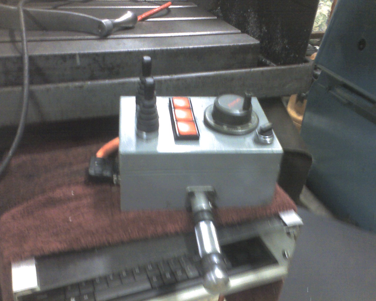

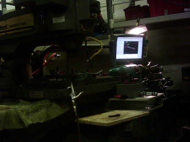

Interesting conversion. I've done 2 Bridgeport Boss conversions, they all went smooth. Your doing alot more work then I did.
I scrapped the entire electric cabinet. Used Geko 203v drivers on the original stepper motors. Removed the old-fashioned pinball control panel and fitted that with a lcd screen. Both machines worked flawless after the conversion was complete.
