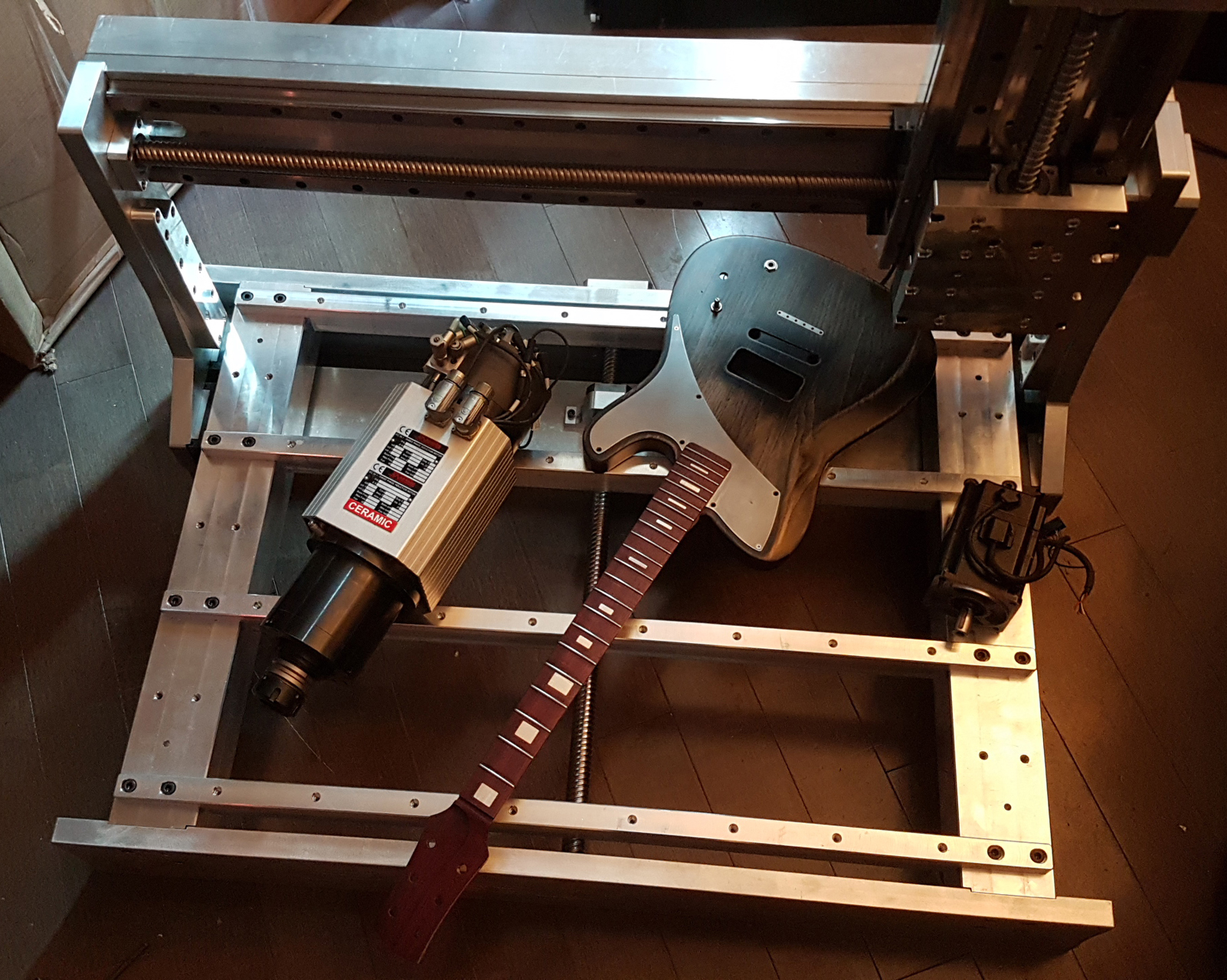

MiniMonster's bigger meaner brother progress.
This machine already exists, but I need to modify it and repair some flood damaged parts. *finally* all the parts seem to have come my way to get it back going.
I am going to use the sanyo denki servo sets I originally bought for my brother machine. They run on either analogue or step and direction. I already have a mesa 7i77 for analogue use.
Does anyone have any opinions on whether I should stick with that, or move it to step and direction. There are a number of benifits to going with analogue, but my last experience tuning analogue servos on linuxcnc went poorly. These are very different drives this time though on a very different machine.
Drives are sanyo RS1, and the motors are sanyo P5 with 2000 line encoders.

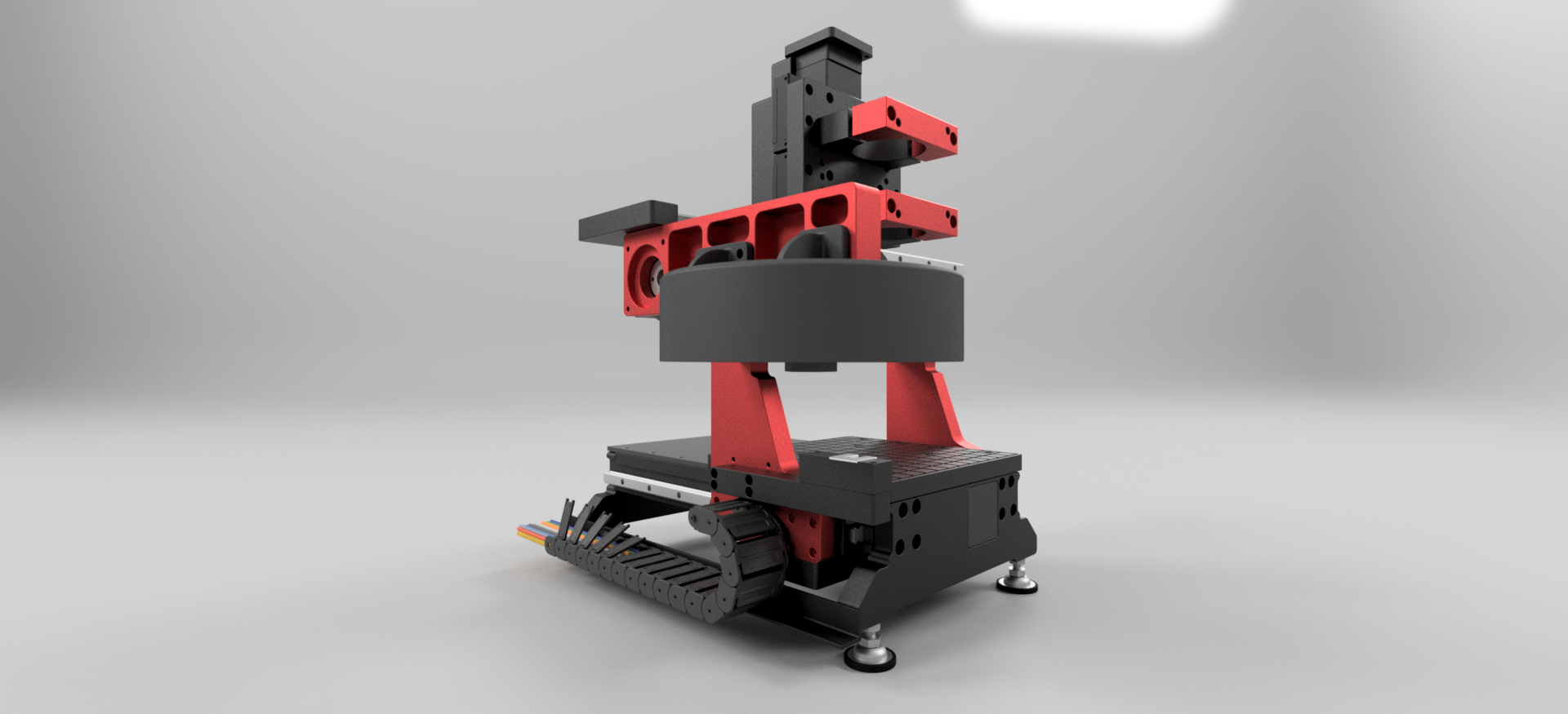

23 Dec 2024 07:37 - 23 Dec 2024 07:37 #317180
by ihavenofish
Replied by ihavenofish on topic Mini wannabe datron build

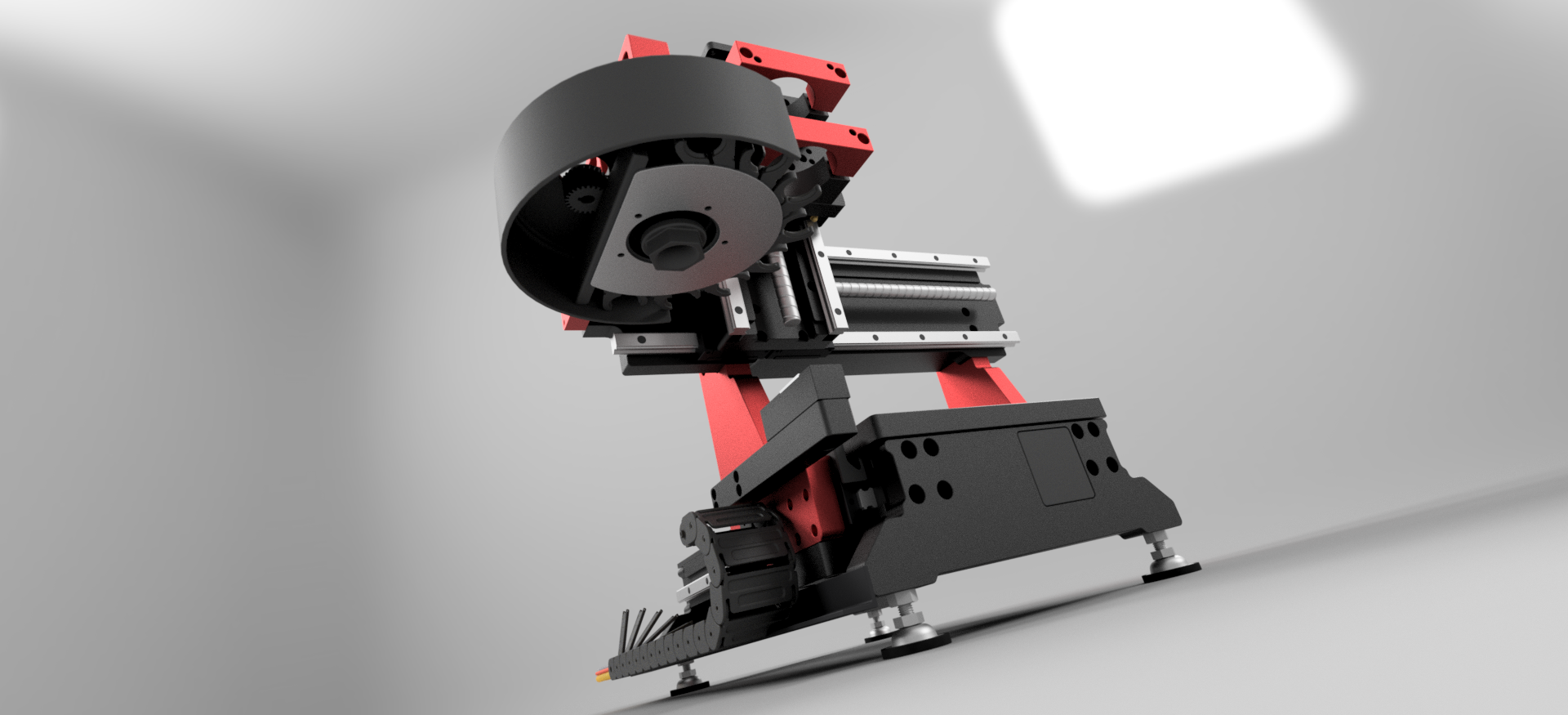

A silly diversion while I wait for things.
I saw how an arm atc mechanism works, and thought "how hard can it be?"
Turns out... quite hard. haha. I found it basically impossible to designs a cam path in fusion. It might be doable somehow,. but it could not think of a way. So, instead I dumped it into my animation software (3dsmax) and animated the motion as I would like it to be. I then basically drove the rollers into the drum wheel using a voxel based volume tool and it ate out the paths (not unlike a cam simulator). Neat trick, but its not super precision because the voxels are only 0.1mm. I think it might still be worth doing some 1/2 scale resin test prints to see just how much play is tolerable in the system. The end goal would be to make most of the mechanism in SLS nylon.
