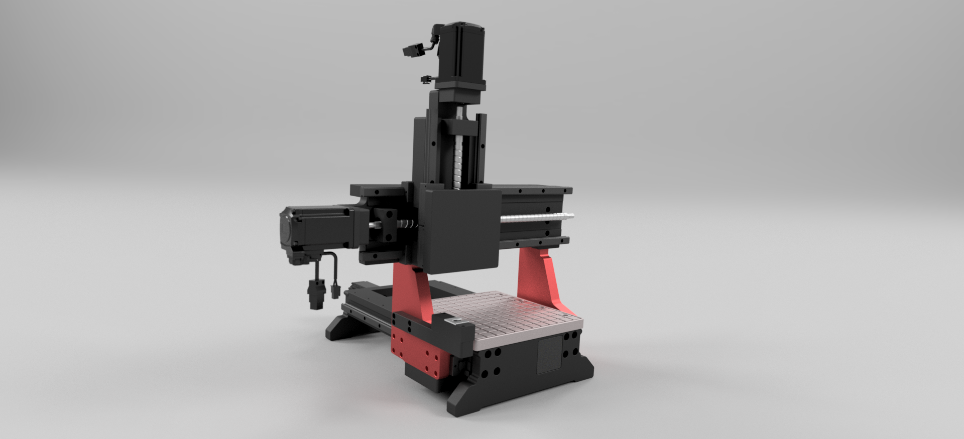

ATC placement on the v1 machine (functionally the same as my current prototype). It's barely bigger than the servo.

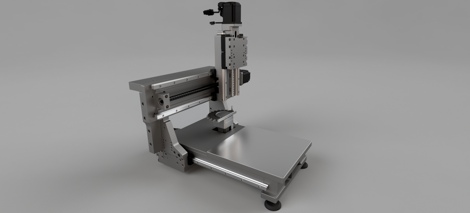

12 Sep 2024 15:10 #310031 by ihavenofish
Replied by ihavenofish on topic Mini wannabe datron build
Progress on the design. Refinements, Tweaks. I got some quotes from JLC for machining and it might be viable to make these for people one at a time, complete with bead blasted anodised finishing. Frame kit with screws and rails, but nothing electrical. Need to get all the prices to the penny and then I will see if one adventurous person would like one. :)
