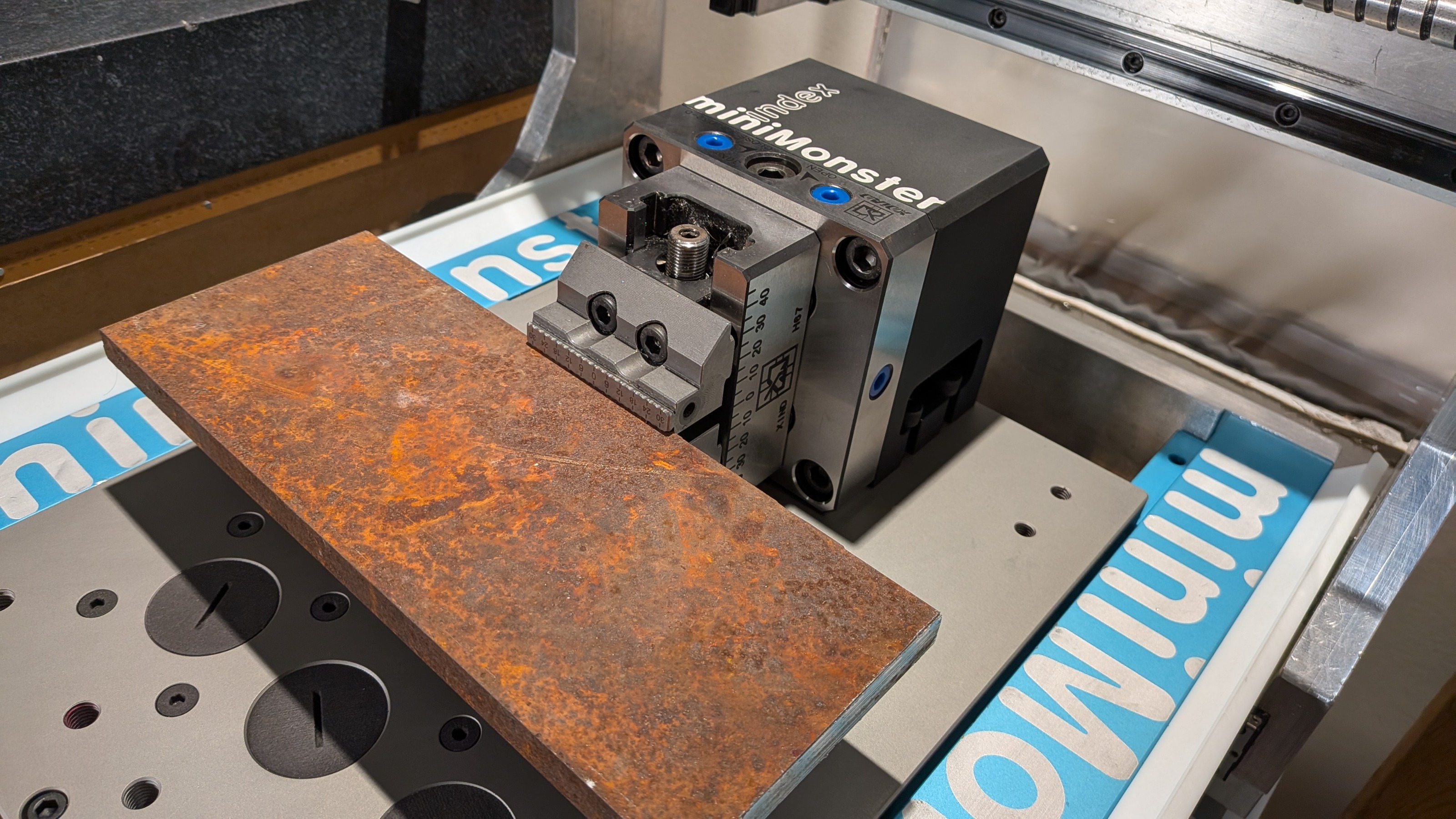

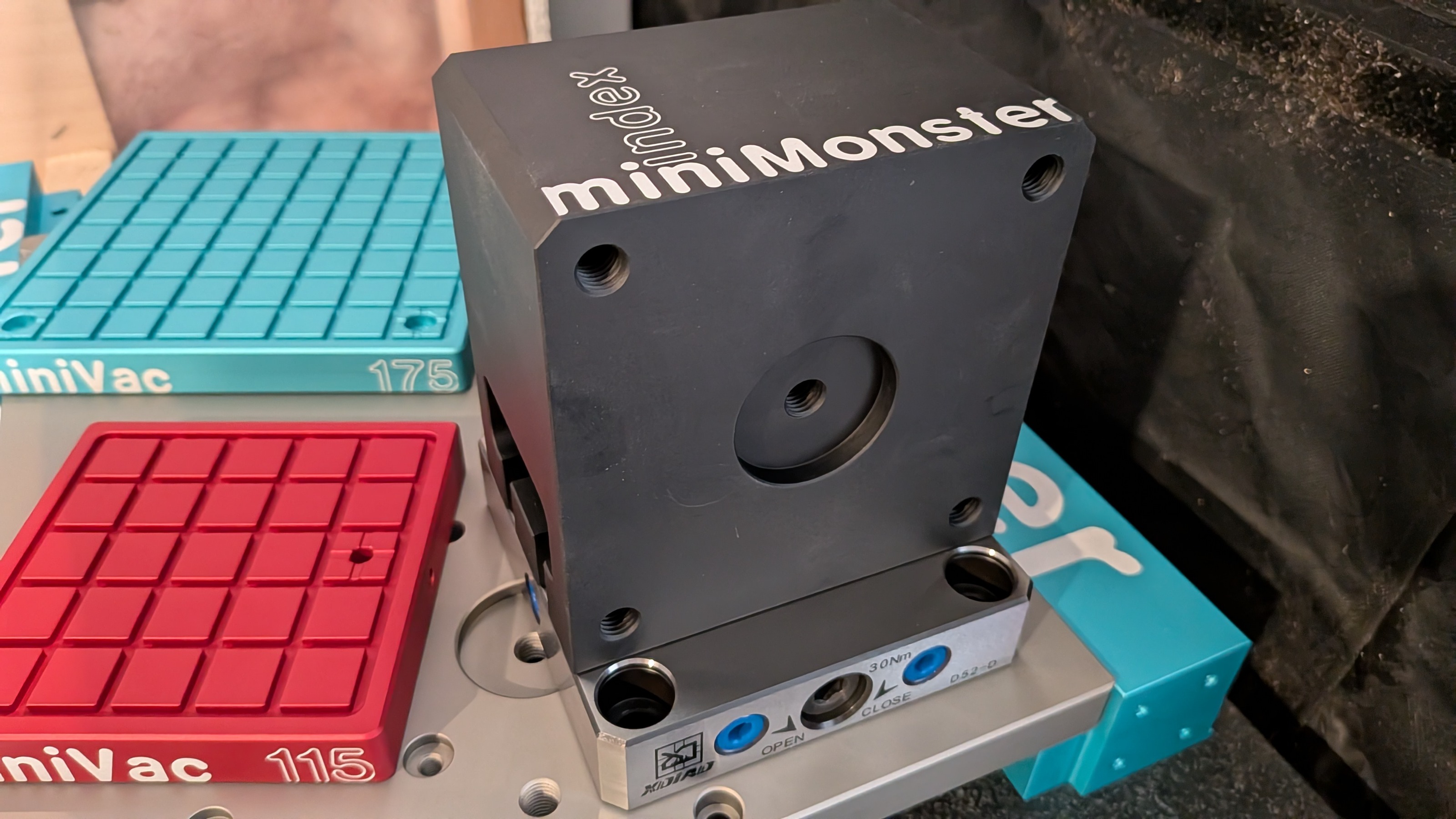

Replied by besriworld on topic Mini wannabe datron build

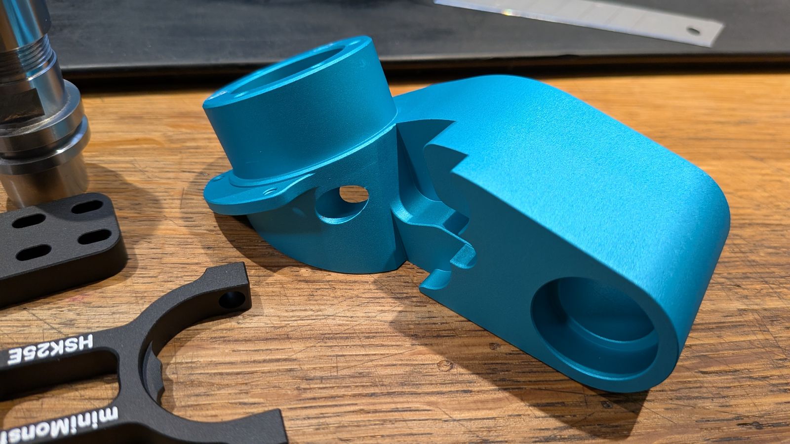

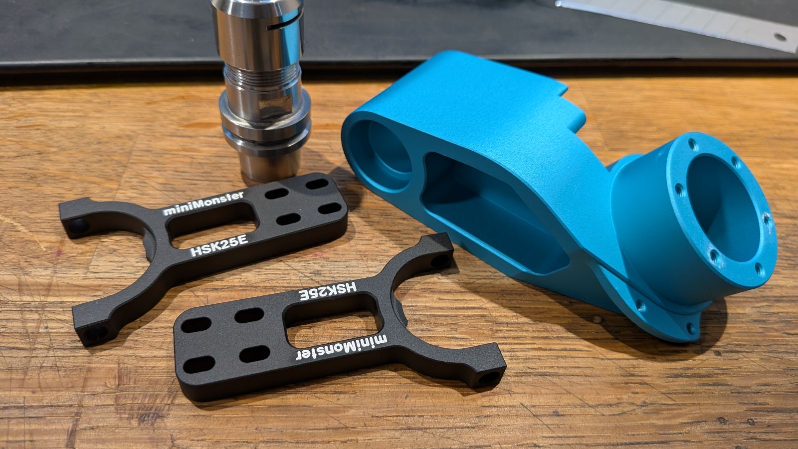

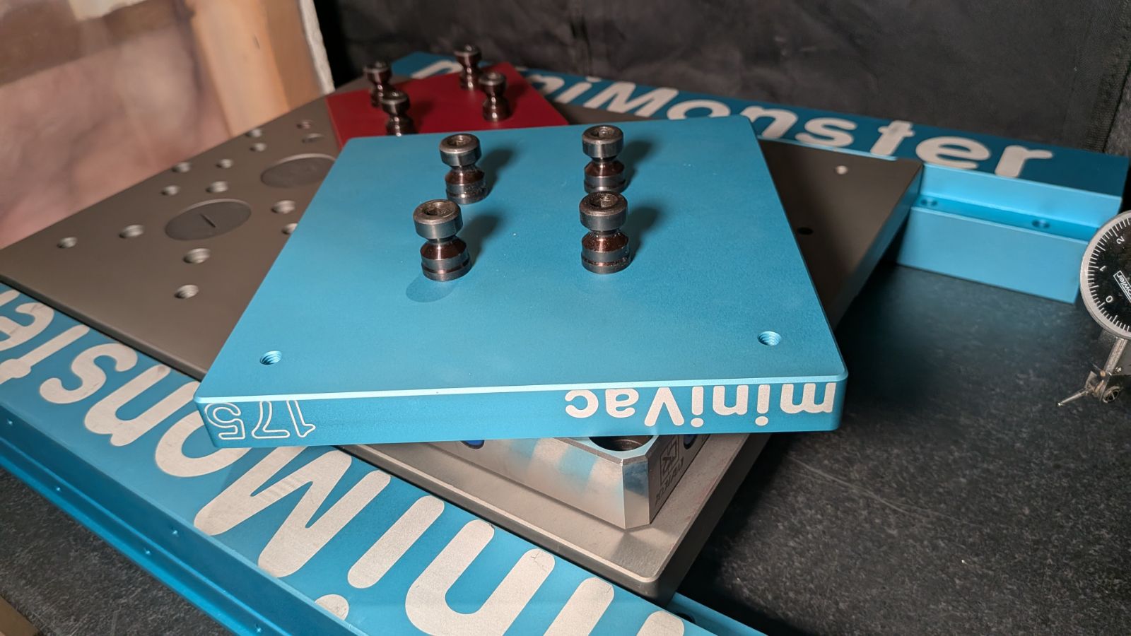

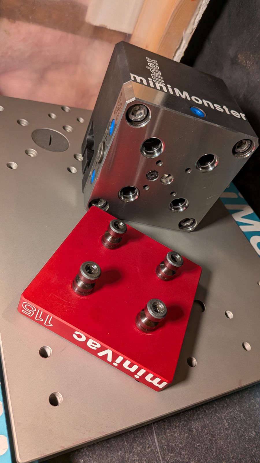

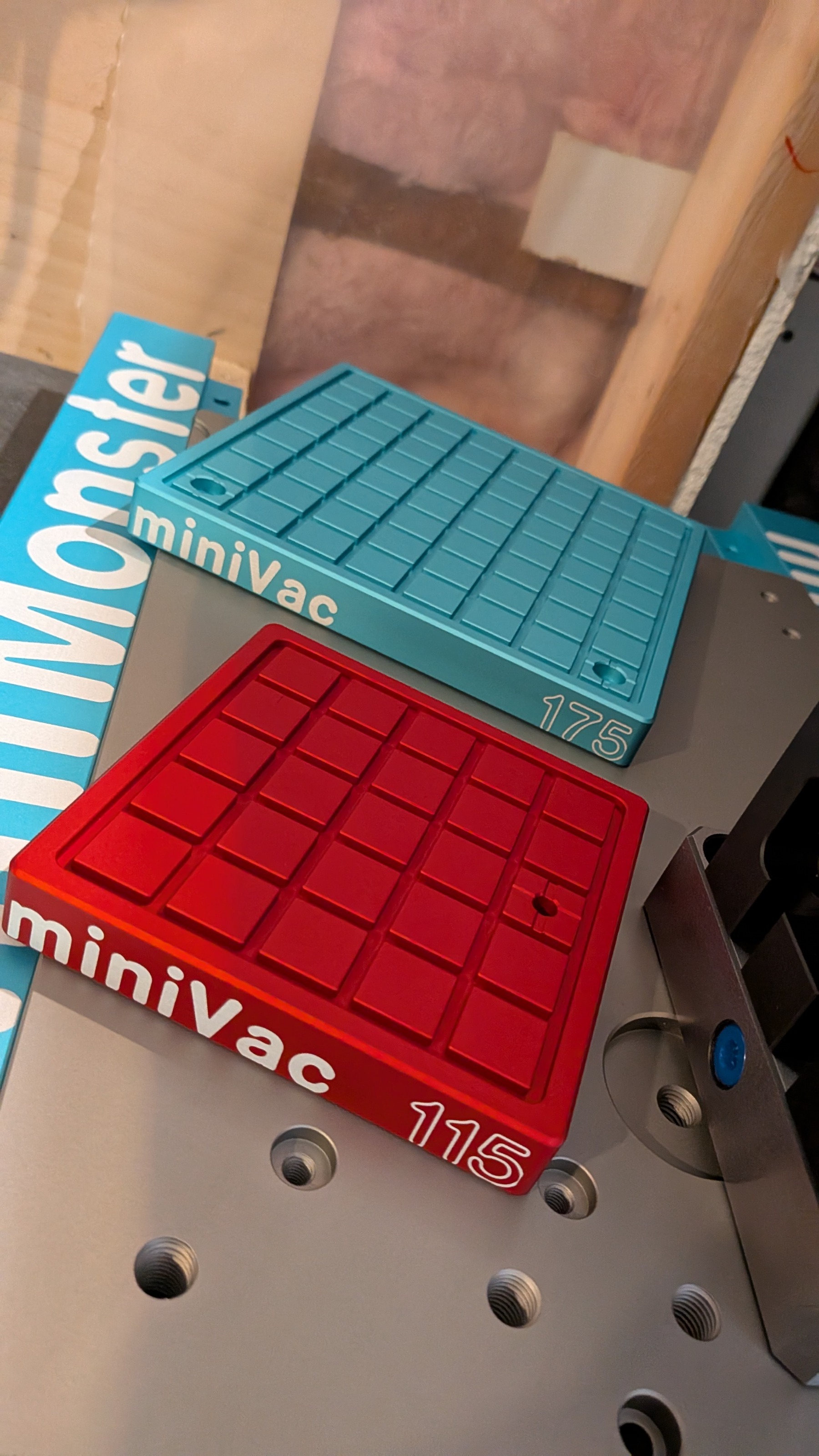

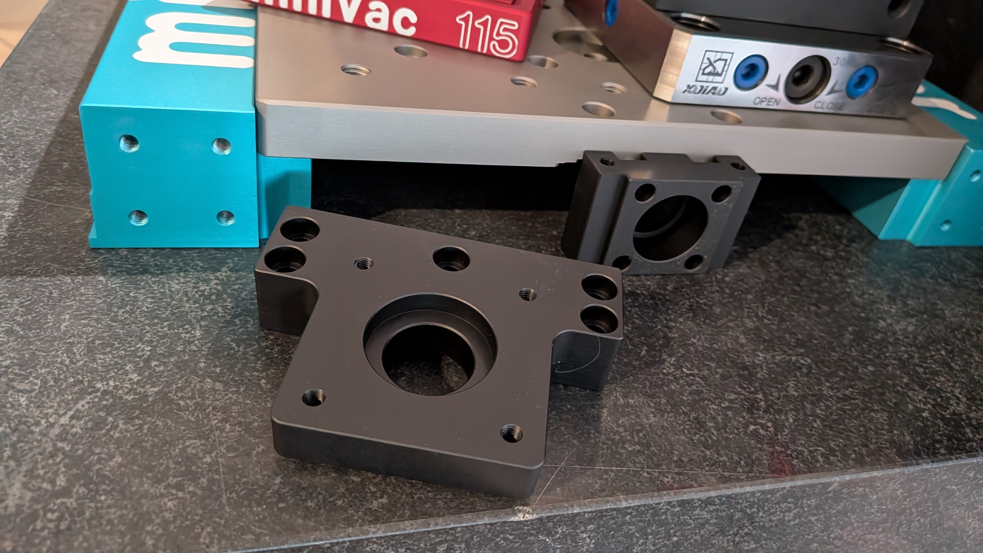

Great job. It just looks like a drawing
How much did it cost to make that blue part?
- ihavenofish
- Posts: 1029
- Thank you received: 286
19 Aug 2025 10:34 #333688
by ihavenofish
Replied by ihavenofish on topic Mini wannabe datron build
Blue part was I think $86cdn. The grippers were $25cdn each. Now that I have it in hand and see what they did, I can see some things I can change that should make it a little cheaper.
For example If you model impossible chamfers someone will hand file them right to the edge. We don't need none of that silliness. So I guess I need to either model accurately, or make a note "only cnc the chamfers as close as is reasonable"
Ove time I will bring all the small parts in house, but its pretty cool that i can affordably do one offs to start.

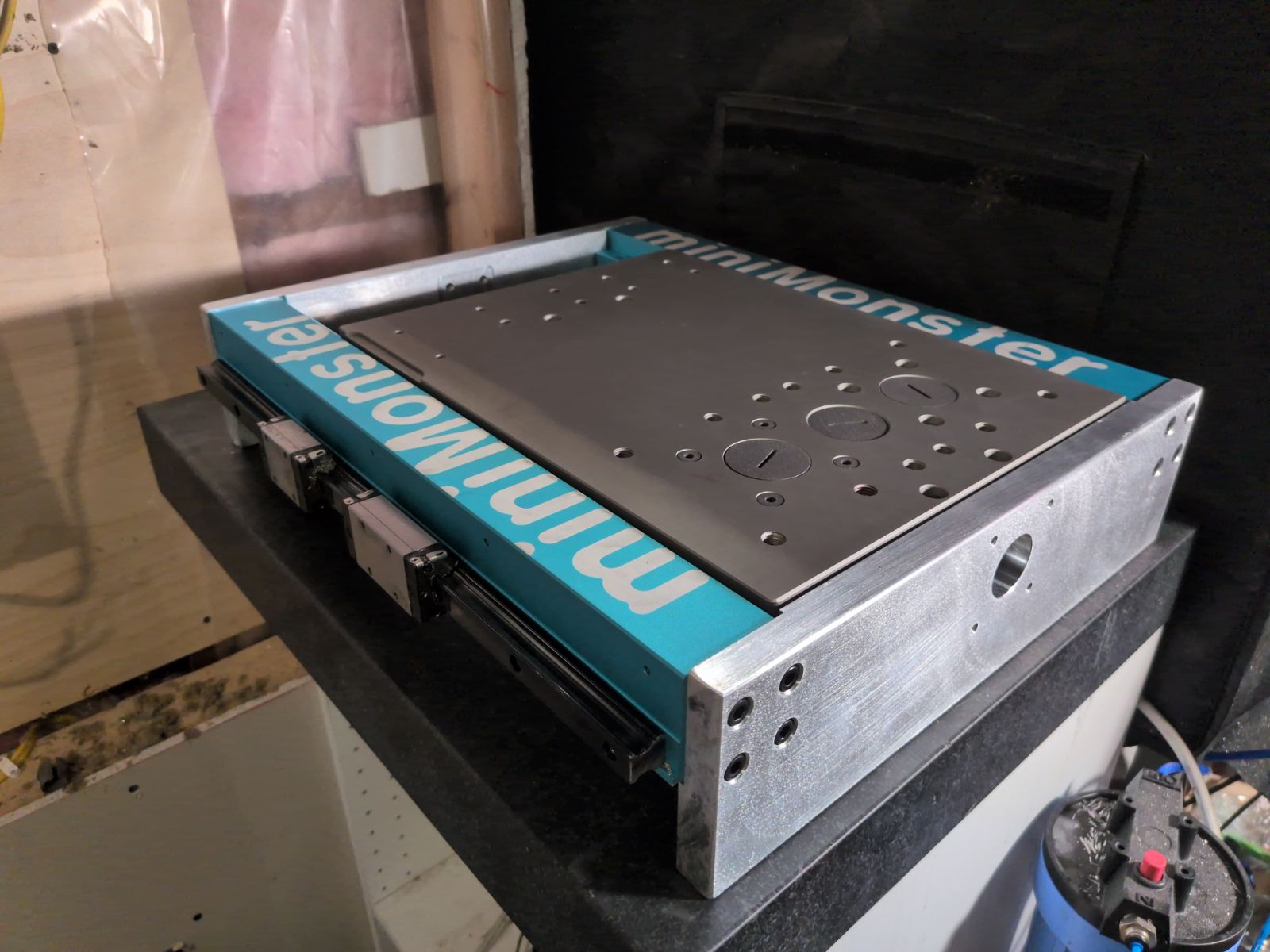

by ihavenofish

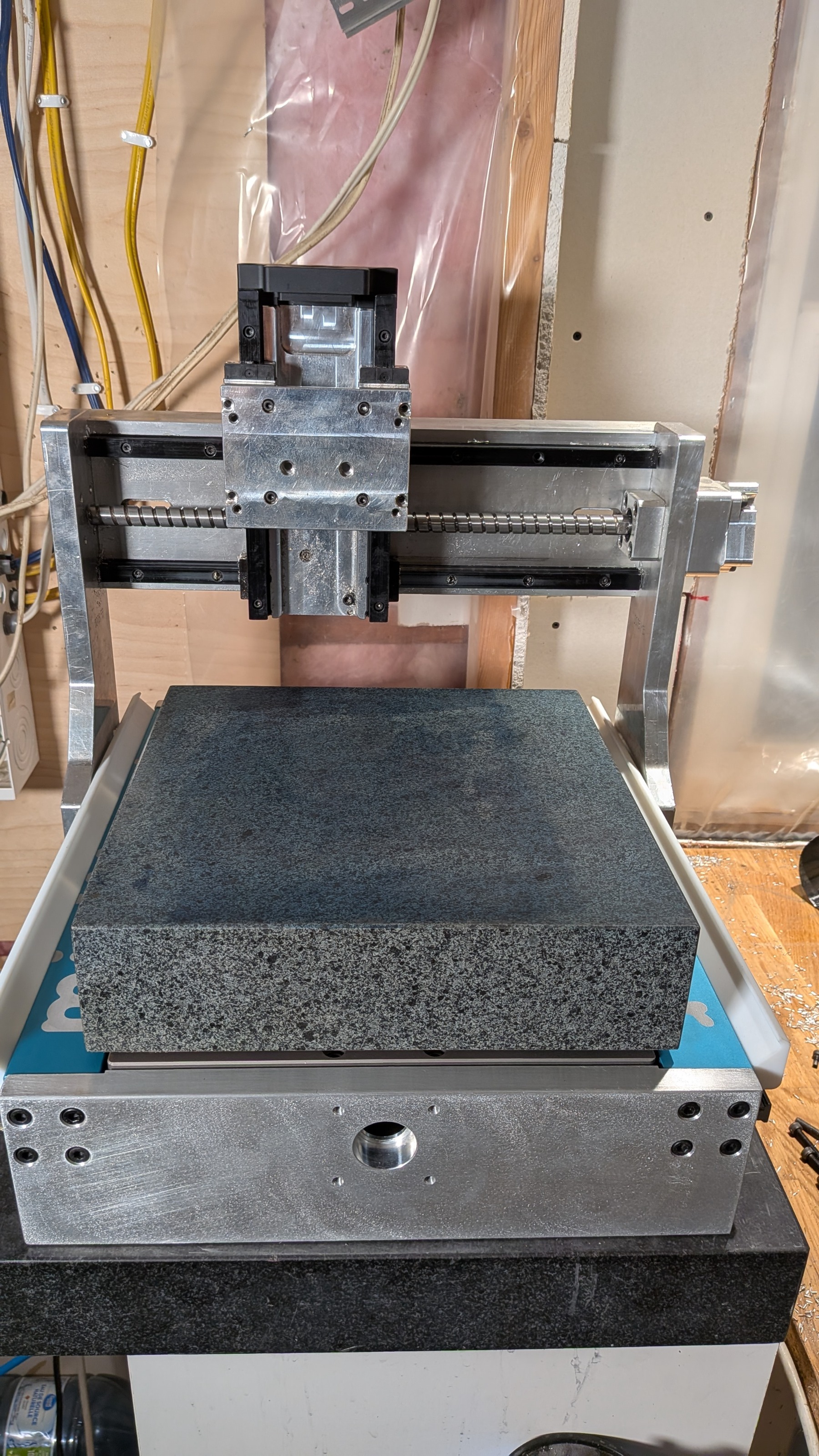

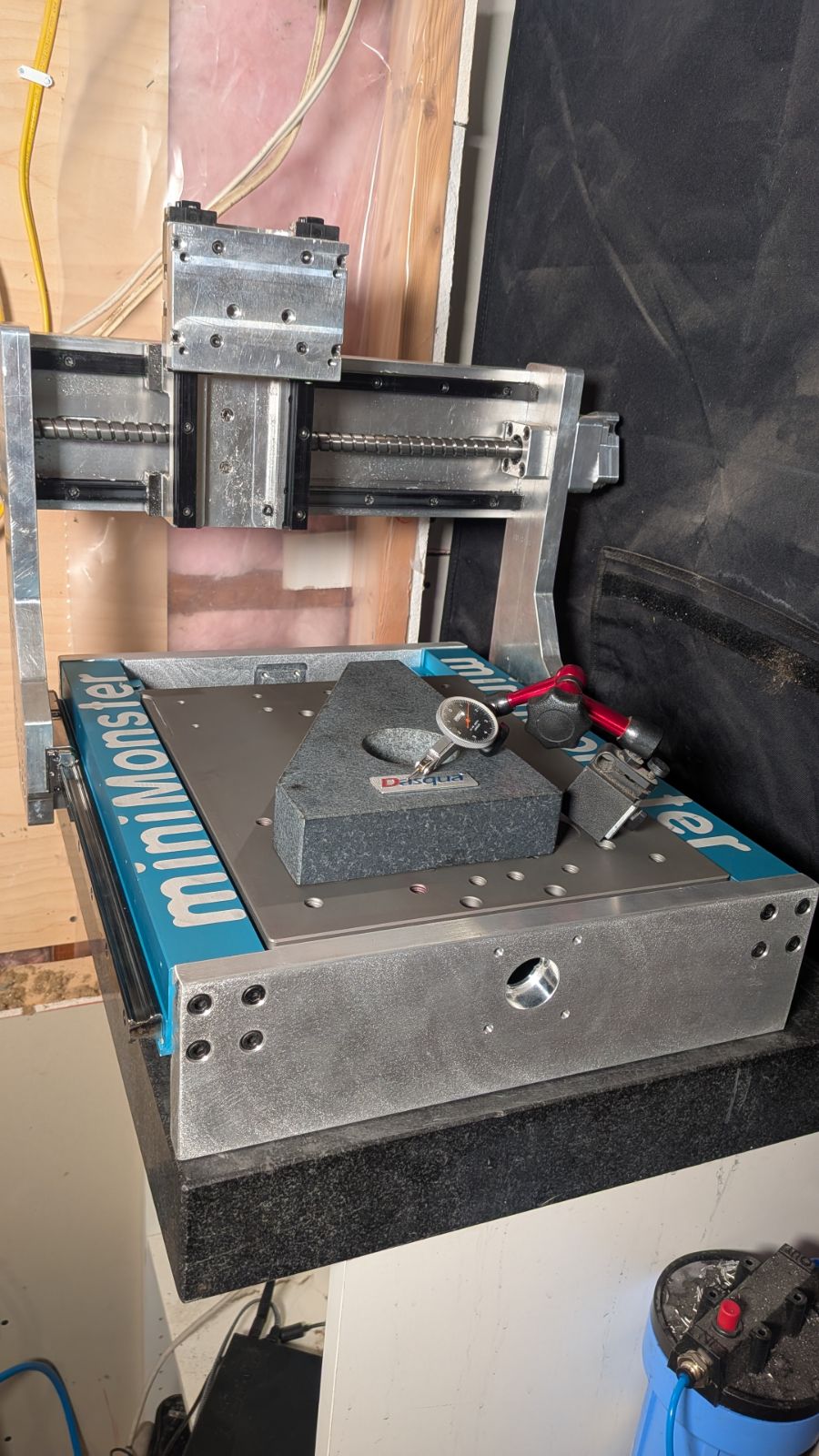

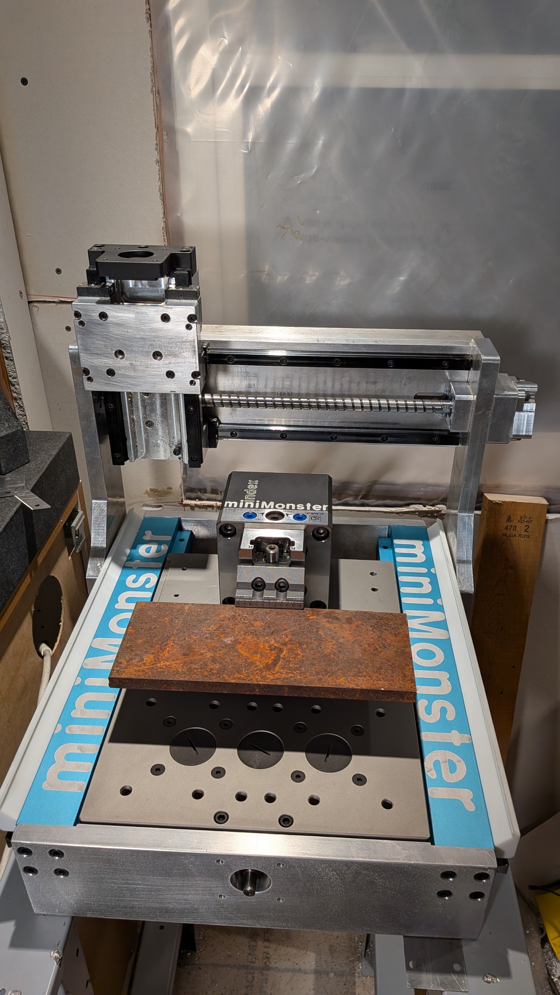

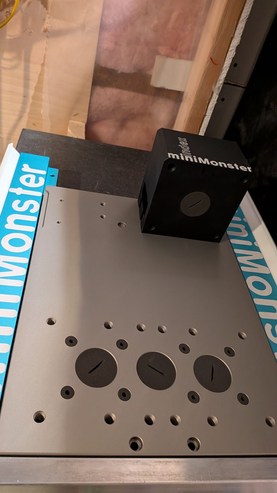

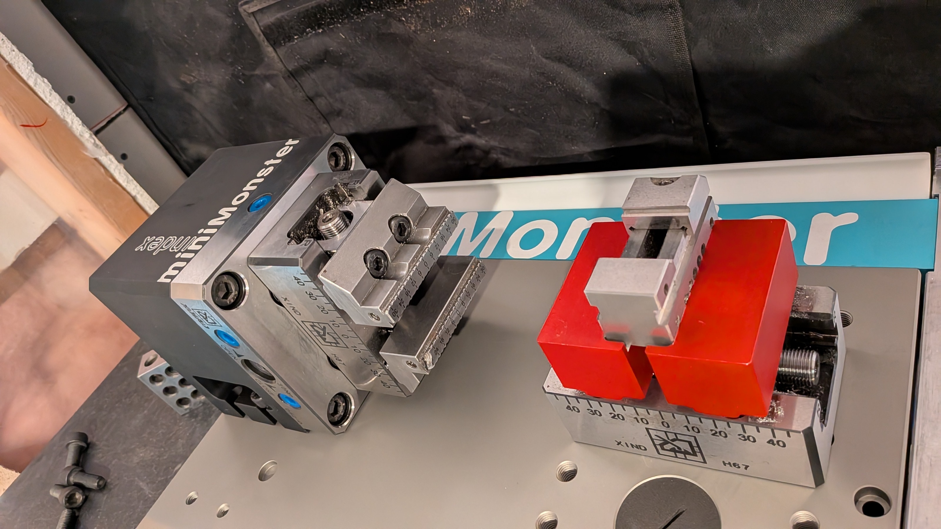

Progress. I cut the end frames down from the old machine so chips don't build up at the ends of the rails. this lets me reduce the safety margins and I get about 310mm y travel now. Also made a new top plate for the Z which increases clearance 10mm, and ups the travel to 112mm. Much smaller than the new version, but we don't have that yet sooo
