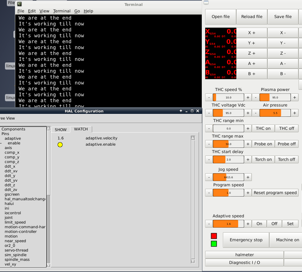

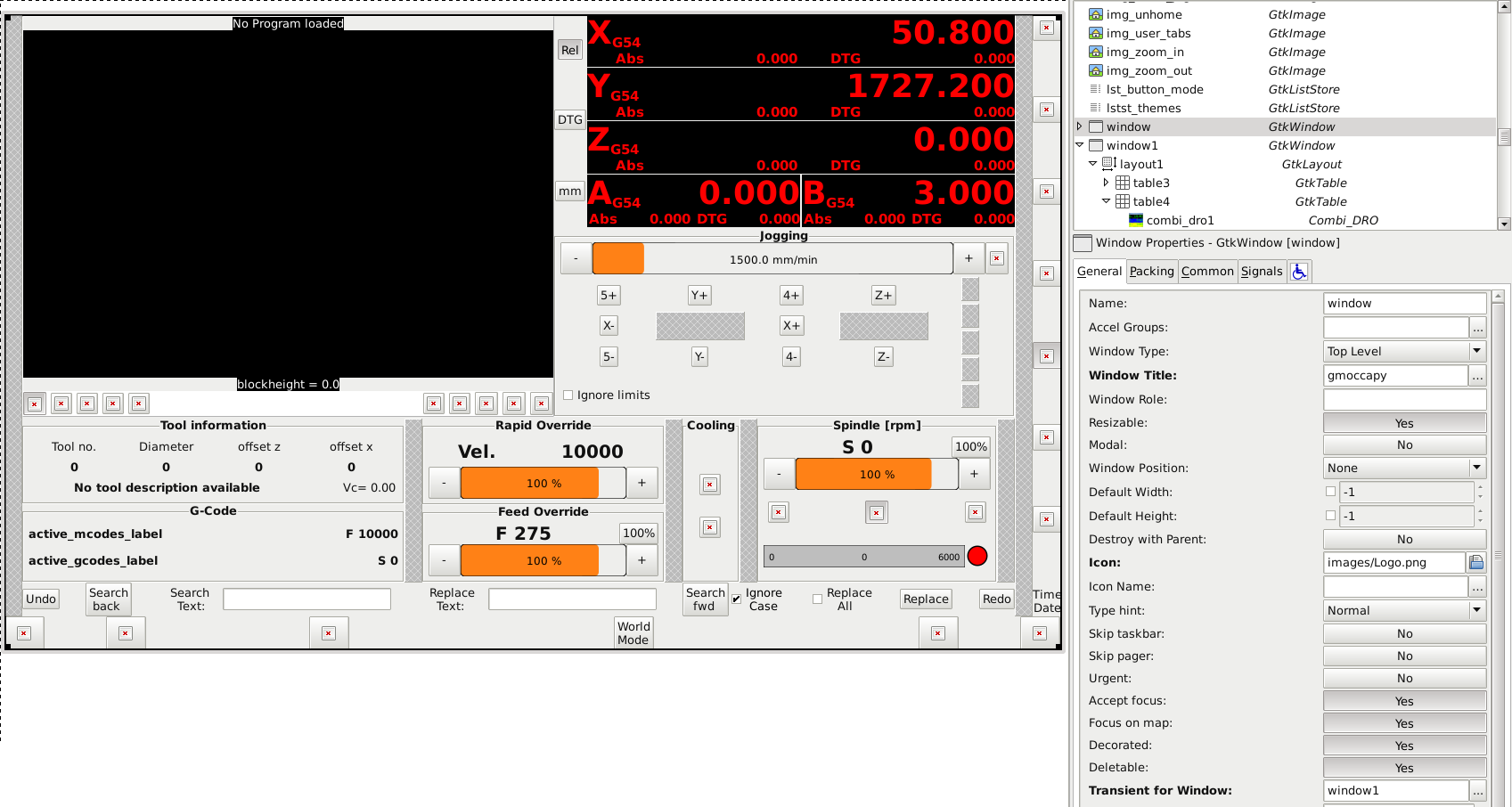

Hi linux users,
I have a idea and a question. Maybe difficult question to solve simple.
I have a custom screen made for test. Loaded in Gmocappy by the trick transient for window1. See picture right down corner
how to add extra window and rename window....
Okey test screen lookes like this, it will be a plasma screen in the future with plasma system coupled on modbuss :
No button's are working at this moment. So what we can do is add some code to the Gmocappy python file.
But that is lot's of work, and changing orginal code is not alway's the best way. The code is good written, so in my opinion for
now better stay off i think. Maybe solve connecting button's other way.....
Now the question :
How to make this screen button's working with the orginal Gmocappy code?
Maybe the best way is :
from gmocappy import chakazulu
And than in the chakazulu python file, make all the connenction's.
How would you do that?

IMHO you are doing this in a hard way.
Rather then trying to change Gmoccapy to a completely different screen,
Why not use Gscreen to learn how screen building works.
Gmoccapy was in the beginning a Gscreen skin - they work at the core very similarly.
Gmoccapy by now use much different code to do the things it does but it still is basically a very fancy GladeVCP panel.
If you build a small basic screen in Gscreen, you would learn a lot about how PYGTK based screens are built.
This in fact what Gscreen was built for - for people to build custom screens.
After that, then If you decided that you would prefer to use Gmoccapy's code to build a custom screen you would have a pretty good idea how it works.
Between the linuxcnc manual example and the sample screens plus a few questions, I'm sure you could get your sample screen to do some useful stuff with not a lot of work and infact the GLADE work you have done doesn't have to go to waste.
And also Gscreen was made so you can keep yor customizations separate from linuxcnc code changes so updates would erase your work.
Norbert and I put a lot of work into Gscreen and gladevcp widgets, i hope others find it useful.

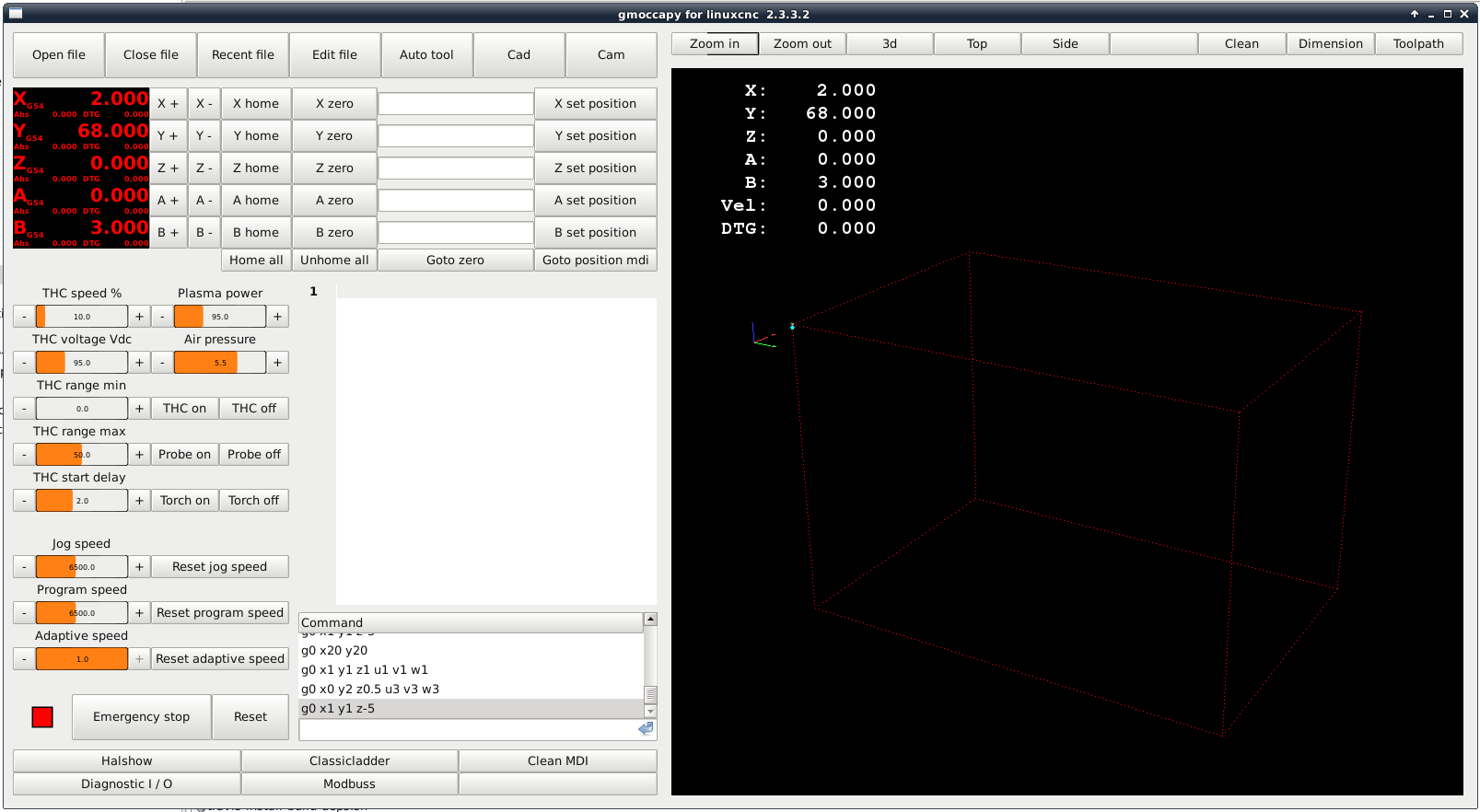

Hi Chris,
Many thanks for your time. You are a good guy, i like that !!
Today i have worked for several hours to set up the custom gscreen tutorial.
That is working good. The screen works directly with a glade screen. The difficulty was for me the tester.py file.
Did not get the keybindings working, in the terminal they have callback. Also the jog function's where to difficult to
copy from orginal gscreen or my jt tutorial. The way of direct jogging with one button was problem for me to solve.
Later this day i started again with a gmocappy screen replacement on the transient way. This was working directly.
And adding function's go's very rapid. Now i got things working in 30 min, see picture.
What i don't like at the ini file is alway's error's on the limit's if you run a example g-code. My prefer to linux is to set the
limit's to -1 (unlimited) User's can bring limit's theirselves with setting up. Also confusing in the ini file is multiple max and min value's
on one axis. This is very confusing, because double value's why that? If there are comment's in the ini user's can understand why....
I would prefer to stay simple.
This program was running in about 30 minutes, without changing any python code.

Hi Chris,
Many thanks !!!
Now also the program override widget is working include a program speed reset button.
It was not easy, but in the end it is working. I must search and interact (make a code combination) with your gscreen.py and jt-tutorial and previous grotius.py program. It takes some experience to solve the code.
Also added zoom_in and zoom_out and view_3d button. Also added view 3d to startup screen. This looks nice.
Also halshow and halmeter is working. Classicladder i must first load real time in Hal file to get working. This i do later.
For external program halshow i had to add :
Thanks to error report's while loading linuxcnc program, solving of problem's go's quite good.
Okey, tommorrow i wil add some more funtion's to the screen.
The ini file is working good. i have disabled shared home. This give's errors when you do multiple homing commands.
Many thanks, Chris
Hmm, now i see the difference in dro and gremlin dro. It is not important at this stage. In glade the dro is in metric.
So i think this is good. Tomorrow i will look if the gremlin (screen plot) is set to mm.
Chris, what about your opinion. Norbert also want's to help. I think he could do the Hypertherm Modbuss connection.
Then i send him the hypertherm for testing and setting up. How do you think about that? I don't know exactly how to do
this from a standard desktop pc with serial port to the hypertherm and setting up the connections, read in .. read out. etc.
Maybe buy a modbuss test device. I can also sent the hypertherm to you. You can also do this if you want. I will make
a financial support, also for your help. In wich country do you live at the moment?
If that it's working, that would be great. I will test the adaptive speed later this week.
Update :
I solved the gremlin dro to display in mm unit's.
Update:
In program the adaptive speed is also working.
The code :
Many thanks !!!
import os
# path to TCL for external programs eg. halshow
try:
TCLPATH = os.environ['LINUXCNC_TCL_DIR']
except:
passThanks to error report's while loading linuxcnc program, solving of problem's go's quite good.
It works good !and tell me if the metric settings are reasonable.
Many thanks, Chris
Update :
def initialize_widgets(self):
self.gscreen.init_show_windows()
# set the initial linear jog rate at the jog_speed initial value.
self.emc.continuous_jog_velocity(self.widgets.jog_speed.get_value())
# set the initial program speed override.
self.emc.feed_override(self.widgets.program_speed.get_value())
self.widgets.gremlin.current_view = 'p'
self.widgets.gremlin.set_current_view()
############ here i solve the mm gremlin dro : ##############3
self.widgets.gremlin.set_property('metric_units',True)Update:
The code :
self.h = hal.component("adaptive")
self.h.newpin("enable", hal.HAL_BIT, hal.HAL_IN)
self.h.newparam("velocity", hal.HAL_FLOAT, hal.HAL_RO)
#adaptive_speed section
#turn on/off the adaptive speed widget
def on_adaptive_speed_on_pressed(self, widget, data=None):
self.h['enable'] = 1 #adaptive_speed.enable must be coupled in custom_hal file
def on_adaptive_speed_off_pressed(self, widget, data=None):
self.h['enable'] = 0 #adaptive_speed.enable must be coupled in custom_hal file
# Hal example :
# net systemlink0 adaptive.enable motion.adaptive-feed
# motion.adaptive-feed : http://linuxcnc.org/docs/html/man/man9/motion.9.html
def on_adaptive_speed_value_changed(self, widget, data=None):
print " It's working till now "
#self.entry1 = self.widgets.get_value("entry1")
self.h['velocity'] = self.widgets.adaptive_speed.get_value()
print " We are at the end "
