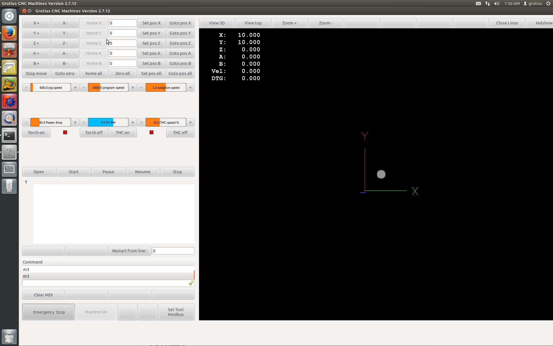

@Project update :
Tonight i have made most button's working.
I have to implement some code for the separation of manual, mdi and auto mode button's to avoid overloading and protect
the system for error's coming out of clicking on every button multiple times. I know customer's will do this.
Linuxcnc is only working fail safe if you seperate this function's. Gmocappy has solved this to use switch screen's in combination
with some smart code.
I will give it a try !
There are plenty examples how to do that, but if you start with linux one year ago. Now is the time to expand some features.
I know the led's are very ugly. But the speedcontrol widget color changing give's error's while executing linuxcnc.
The error is : bad drawable pixmap.... or something like that.
For this moment the led's are the fastest solution.

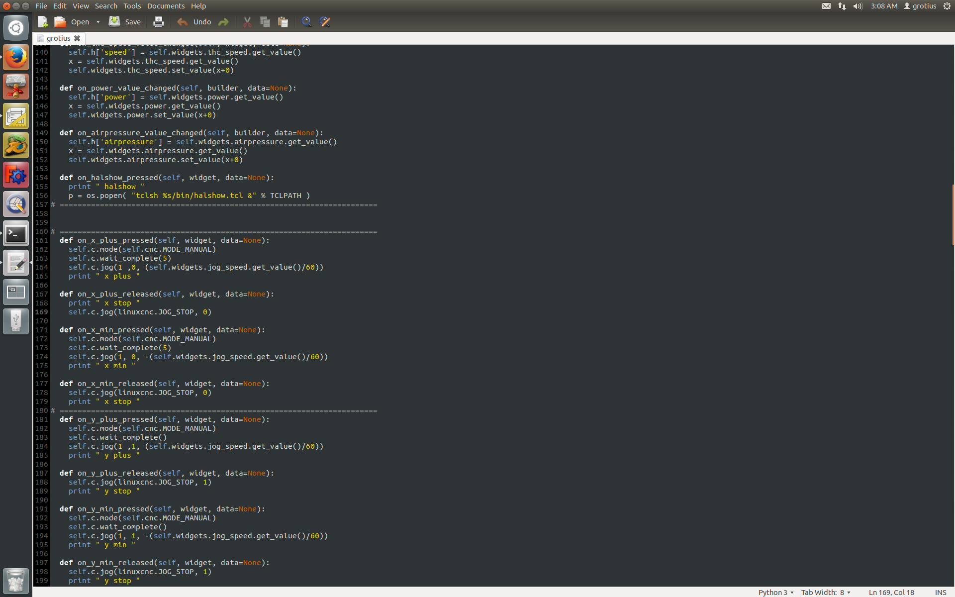

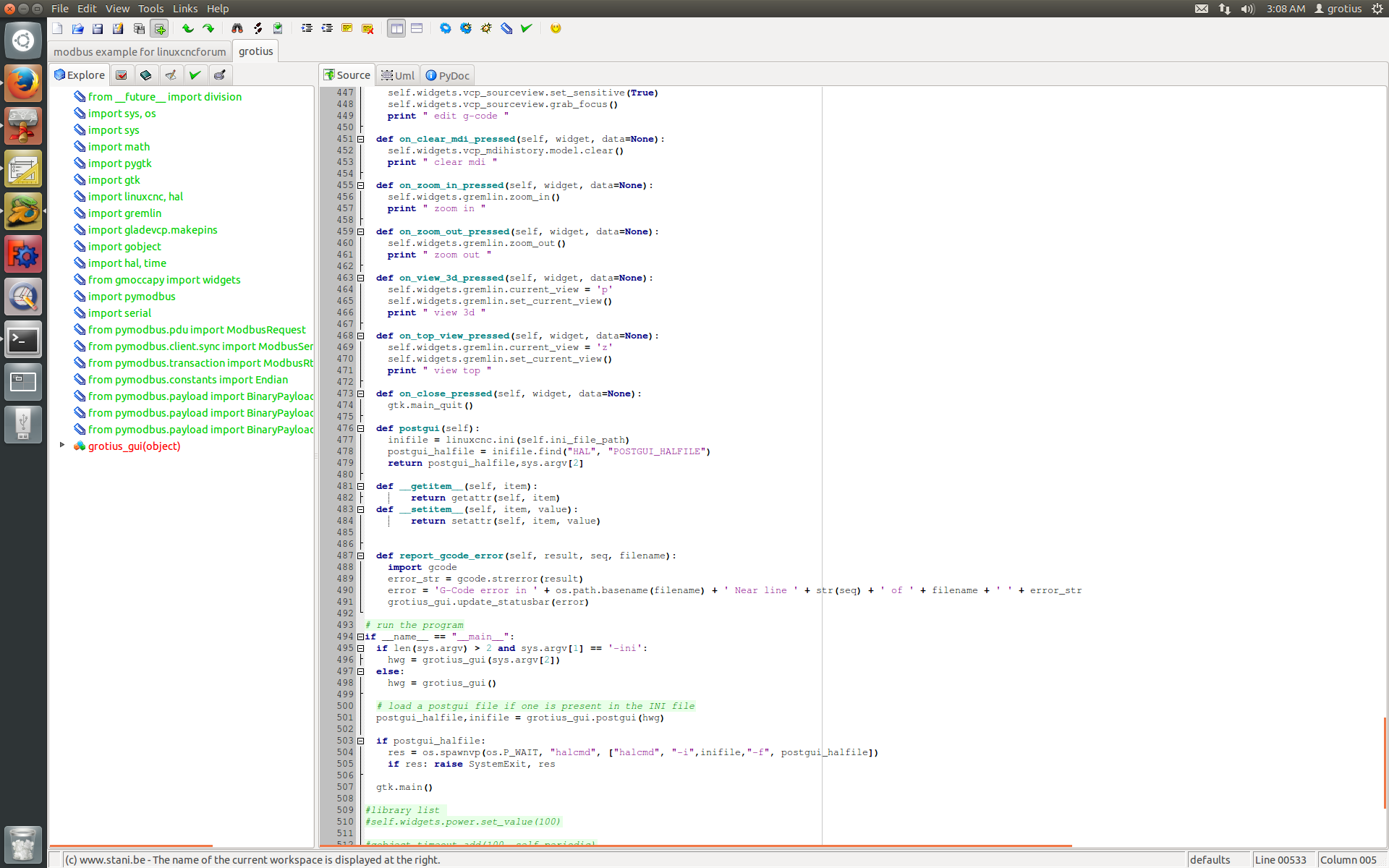

Looking for nice text editor's.... I just want you let this know.
It would also be nice if the professional editor's are usable within this forum.
Maybe update the forum format.
Stani's text editor, nice to use and also you can test the code.
Gedit text editor, also nice to use. I learned this from John Thornton's examples.

I am getting confused with all of the changing hats in this thread!
Try Geany text editor. Much nicer than gedit.

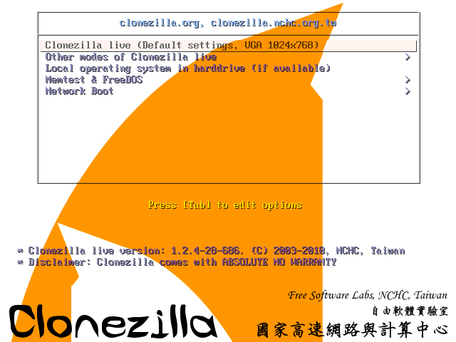

The plan now is to make a full ubuntu install with all the benefit's and then try to clone the disk.
I have seen a linux distribution specially for cloning. So i can try this out.
I like gedit.
I have a project update. I have made several install's off ubuntu, linux mint and debian just too see the difference in distribution's.
Last week i was fighting to learn how to make a install file of the kernel's and linuxcnc in .deb format. Also the glade program was not complete working, now i solved this issue's, i think.
I think i go for ubuntu 16.04.04.

Sounds great. You should be aware that there are some licensing issues within the open source movement to consider before you make a an .ISO publically available. I know that has been a problem for LinuxCNC and I think why they can't use Mint.
You would also need to be able to provide all of your source code in line with the open source movement.
But if you were sharing with your customers, I don't think it would be a problem.
Google says there are quite a few sites that tell you how to build a distribution ISO.
