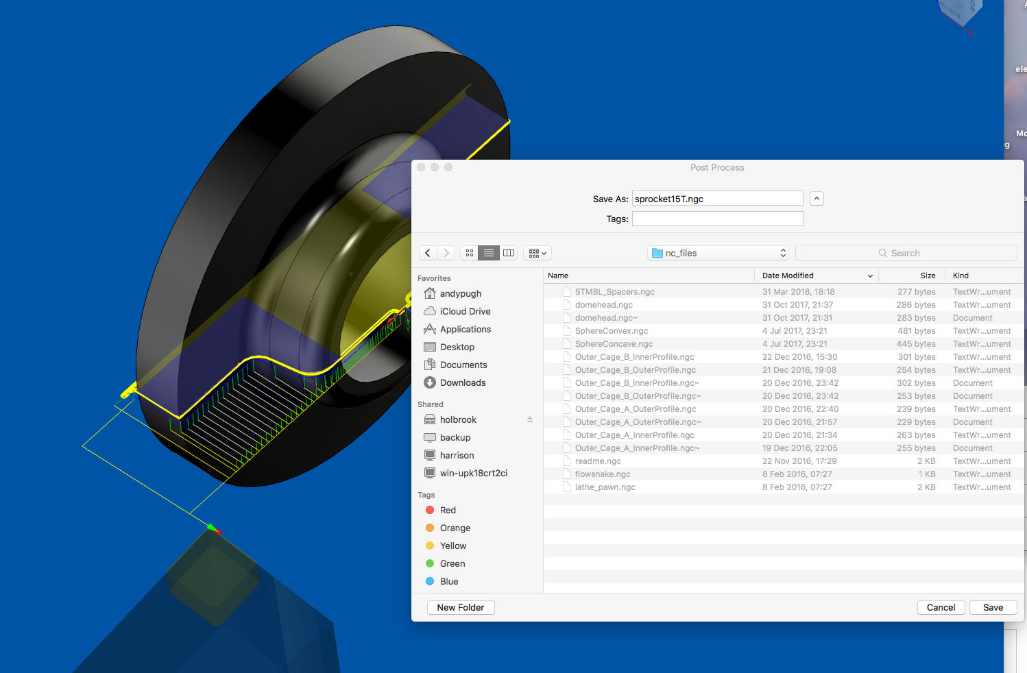

Something just occurred to me and you might be a good person to ask.
My original intension was to save all my .ngc files from Fusion 360 to a folder on Dropbox, I could then access them from LinuxCNC and run those files there. They would be saved, safe, and accessible at Dropbox.
With this Debian/Dropbox issue where they don't play well in the sandbox together that is not going to work.
However:
If I save my post files (.ngc) to the cloud at Fusion 360, can I get to them from LinuxCNC file picker somehow?

I just save from Fusion directly into the NC-files folder of the machine that is going to make the part. The .ngc files do not need to go via the Cloud.
Replied by andypugh on topic Gcode sharing folder ( Debian / Windows 7)
