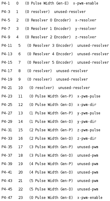

05 Jan 2019 00:13 #123518 by hatch789
Replied by hatch789 on topic PID issues or calibration help
guys does this look right to you for my setup? I know that PCW said there's not much point to going back to a pncconf starting point but I feel like my setup has been hosed from the beginning. The below pic is from my 7i49 daughter board for my resolvers.
Look at GPIO 0 and also 23? Why would these both be Gen-E with x-pwm-enable? Maybe it's right but I want you to verify.
Also, if I want to watch my voltage for X and Y which pins would I watch?
