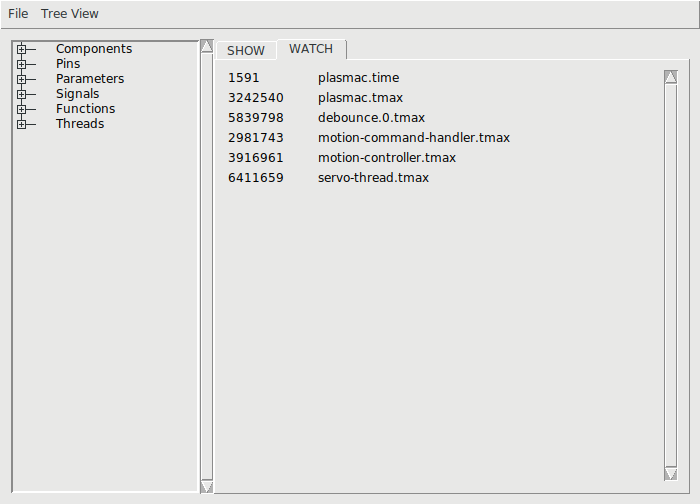

05 Mar 2019 01:39 - 06 Mar 2019 02:42 #127743
by phillc54
Replied by phillc54 on topic ESCape key issues in Pre1-4587 build ???
see this post
I can confirm that similar behaviour exists on configs run with my
experimental plasmac component
It is identical behaviour using either Axis, GladeVCP, Gmoccapy or QtVCP.
Up until a M3 command, ESC, F1 & F2 behave normally.
As soon as a M3 is issued then none of the keys work.
After issuing a STOP from a button then all the keys are active.
If I PAUSE the program then all the keys are active.
If I comment out the M3 and run the program then everything behaves as it should.
This seems to point to something in the component stopping keypresses getting to the GUI.
Any ideas on what could cause this???
Cheers, Phill
Edit 1: The halshow window is while running a normal program
Edit 2: To further confuse the issue, if I let a program run to the end the keys are still inactive, but... if I then wait a couple of minutes they then become active again.
Cheers, Phill
Last edit: 06 Mar 2019 02:42 by phillc54. Reason: More info

05 Mar 2019 22:13 - 06 Mar 2019 02:44 #127834
by phillc54
see this post
It is up to date (28th Feb) master with reverse-run as well.
I will try later today with a vanilla master version.
Cheers, Phill.
Edit: I have just tried with 2.8.0~pre1.4625.g8f279b835 which I just upgraded to from the buildbot (stretch master-rtpreempt) and it still showing the above behaviour.
I probably should add that all this is being run on a VMware Fusion virtual machine.
