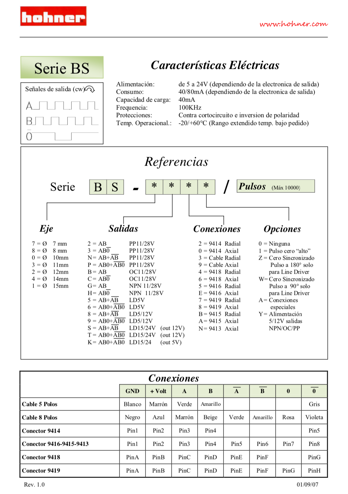

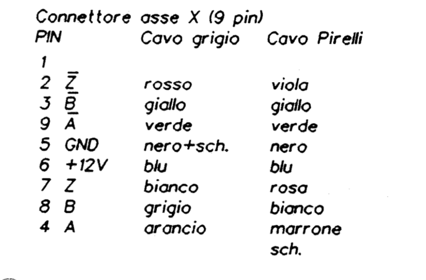

Yes, I bought the Mesa 5i25/7i77 Plug 'n' Go kit, and they work great out of the box!
My biggest problem has been the encoders - the original Lika encoders were 12V supply and 12V single-ended output; the 7i77 provides 5V and expects 5V. I was going to provide 12V externally then opto-shift the output to 5V, but then I broke one of them and decided to replace all 3 to work with the 7i77, and take advantage of differential signals with index (not necessary though). I've had a mixed bag of success with encoders bought off eBay, but I think I'm at a point to start tuning the servos. I'll start with a single spindle as I work out how to control the multiple heads.
