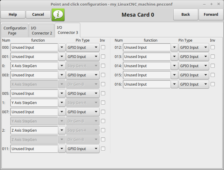

On the configuration page, make sure you select only the number of stepgens,
pwmgens, and encoders you will use (to free the pins for GPIO use)
pncconf lists both the GPIO numbers (3 digits) and module numbers ( 1 digit like stepgen 0,1,2,3 etc)
in the first column so its a bit confusing. Normally standard firmware will assign stepgens in a sensible
fashion so 0=X on BOB, 1 = Y, 2 = Z etc

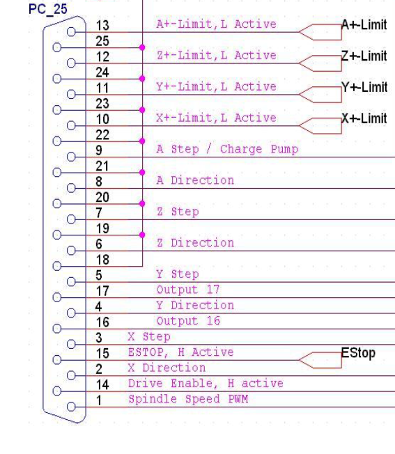

i dont think this is going to work for the dmm pinout. its missing pin 2 and pin 3

DB25 pins 2 and 3 are assigned to stepgen 0:
IO Connections for P3
Pin# I/O Pri. func Sec. func Chan Pin func Pin Dir
1 0 IOPort PWMGen 0 PWM (Out)
14 1 IOPort None
2 2 IOPort StepGen 0 Dir (Out) <<<<<<<<<<<<<<<<<
15 3 IOPort None
3 4 IOPort StepGen 0 Step (Out) <<<<<<<<<<<<<<<<<
16 5 IOPort None
4 6 IOPort StepGen 1 Dir (Out)
17 7 IOPort None
5 8 IOPort StepGen 1 Step (Out)
6 9 IOPort StepGen 2 Dir (Out)
7 10 IOPort StepGen 2 Step (Out)
8 11 IOPort StepGen 3 Dir (Out)
9 12 IOPort StepGen 3 Step (Out)
10 13 IOPort None
11 14 IOPort QCount 0 Quad-A (In)
12 15 IOPort QCount 0 Quad-B (In)
13 16 IOPort QCount 0 Quad-IDX (In)Please Log in or Create an account to join the conversation.

thank you. I don't understand what the purpose of IO connector 2 and IO connector 3 is? some "Num:" are in both. maybe I should remove the keyed molex connectors on the board and replace it with screw terminals. otherwise im stuck with that pin configuration. or make a new db25 cable

IO connector 3 is P3 on a 5I25 or 6I25 (the DB25 on the bracket end of the card),
which in all you need to configure unless you are using 2 BOBs
The pinout should be correct, why would you change any wiring?

on I/O conector i only have

it should look like my image
if you
1. Select 5i25 with internal firmware prob_rfx2
2. Set the number of encoders and PWM gens to 0
3. Select accept component changes
4 look at the IO connector 3 tab

ok that looks to be the same. not sure how it will work with my pin out
