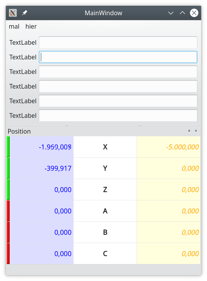

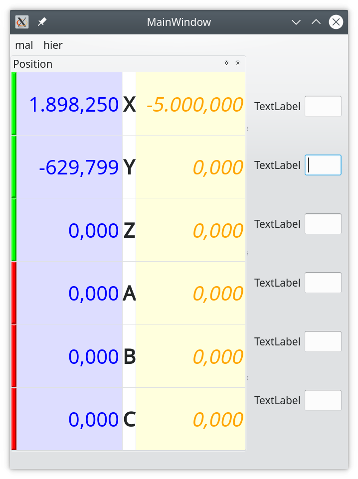

25 Aug 2021 03:59 #218671 by Reinhard
Replied by Reinhard on topic QT C++ graphics display WIDGET
looks like you're talking about a successor of gremlin ...
> Showing the dro's with background color is possible as a % transparant local widget overlay.
If overlay with qt is possible, I'd like to offer my position widget.
I'm actually playing with mvc pattern in qt and have a dockable widget, which handles all position stuff
> CurrentSelectedLine of the wishlist is the hardest part i think. Not the line selecton an sich,
> but giving the selected gcode line number back to lcnc. Info about this is welcome.

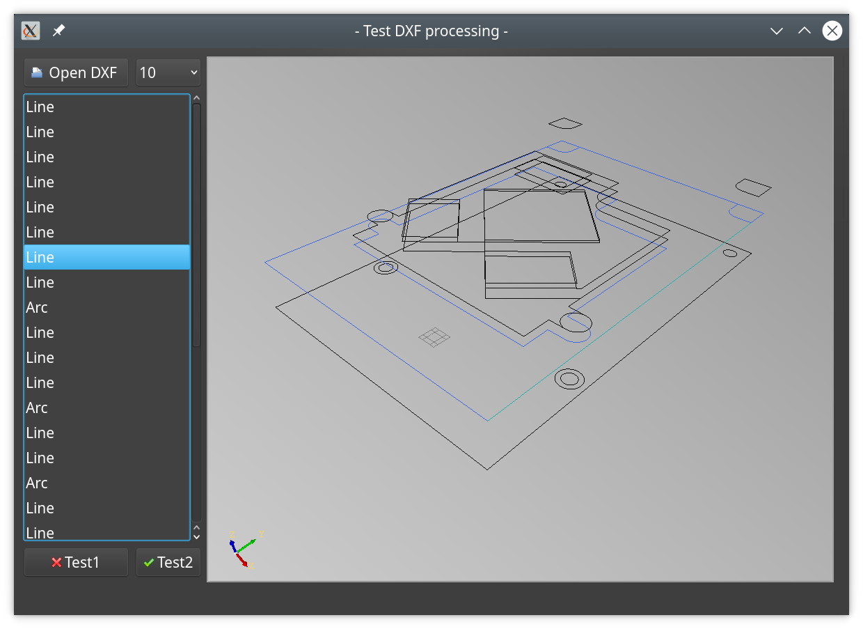

When I extended your dxf-viewer, I implemented selection of elements - together with repainting of selection in different color.
In this picture, combobox selects the active plane which fills the listbox with the elements and selected item from listbox is selected in graphic view.
Usually selected element is an information, that comes from linuxcnc backend. When I developed the graphic view in java, I worked out that too. The problem is, that status from backend does not really contain the information needed to update display according to expectations - especially if exact path is not enabled.
Only CAM needs to determine selection from graphic view. But CAM does not need to send that info to linuxcnc backend.
I think, the really hard stuff is no widget requirement, but model related. Means: getting the model information from backend as well as getting up to date informations about backend progress. So this work could be splitted into model tasks and view tasks.

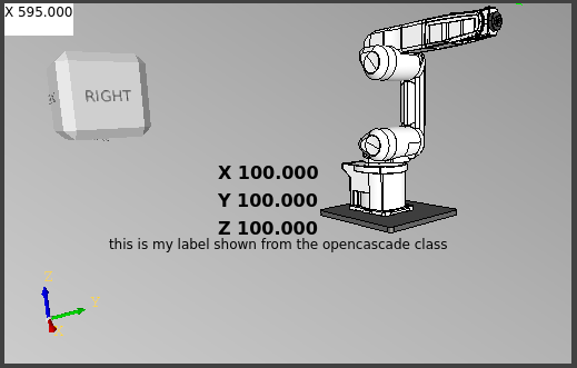

I was investegating the widget overlay.
The label with the white background is a child widget of the opencascade widget and is raised().
The same result we get with qtstackedlayout.
The black text can be a QLabel, QPlaintextedit, added in the source code of the opencascade widget.
So far as i can see, a nice methode to go on with.
