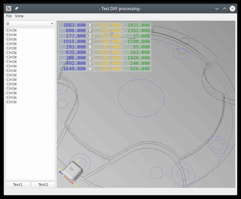

originally I had assumed that we could work together. But when grotius scrapped his project, I realized that I was on my own.
That's why it took a while. After all, I had to learn Qt and Opencascade first.
But now I'm to the point where I can say I have the same functionality in Opencascade than with Qt.
This is what it looks like when the dro are combined with a viewer:
Of cause, colors and fonts can be changed as desired.
If there is interest in this, I could still round it out.

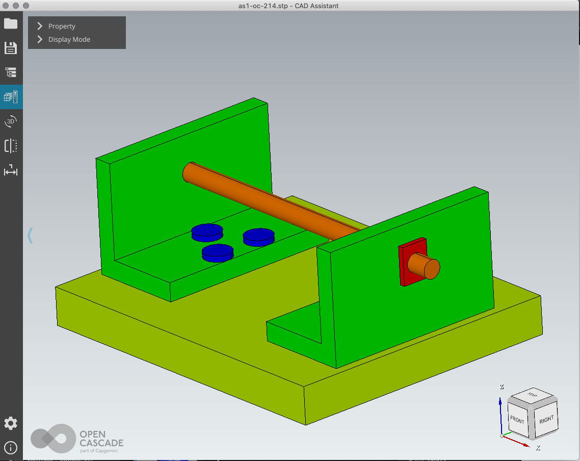

One thing: are you aware of that OCC Viewer ?
Best Regards. udo
Hallo Reinhard
I think I'm ready to give it a try now.
Where could I get that app.

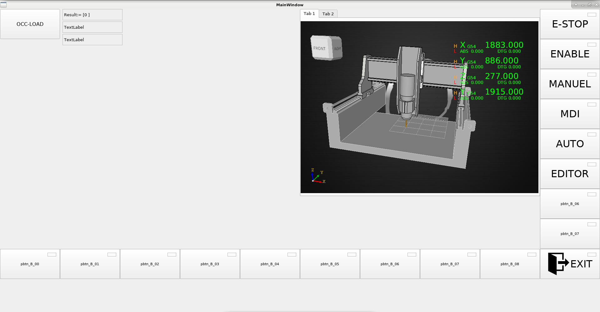

A little progress with the Graphics widget.
Still - rotation is not clean -jumps- and g-code part is not compiling yet.
and . and .and
and . and .and

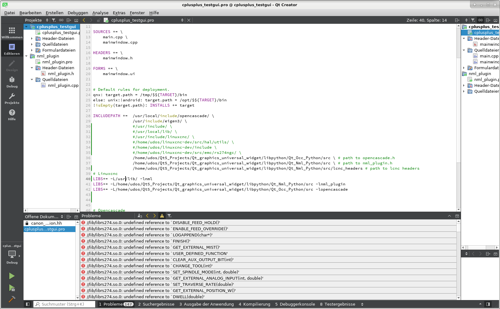

I dearly need some help here. The testgui with the occ goes fine.
If I try to compile your nml_plugin it compiles BUT the testgui from the nml_plugin fails. Always.
Please have a look. What do I miss here.
best regards
Hi Grotius
best regards

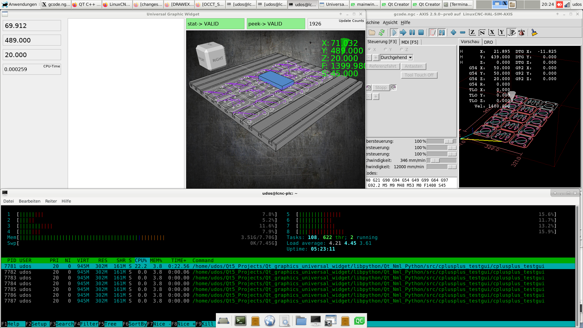

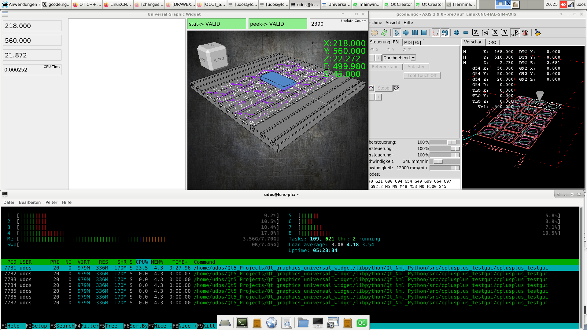

is there a memory leak in the widget.
Building up some SHR usage you can see in HTOP and then crashing after a while.
See attached images.
Hi Grotius

Hi Udo,
I expect you have a nml issue somewhere. In my situation the widget was tested ok for several hours.
For this previous question :
Qt is searching for a librs274... but can't find it. Solution is to link this lib into the qt .pro file. The lib can be found in
the linuxcnc path.
the linuxcnc path.
