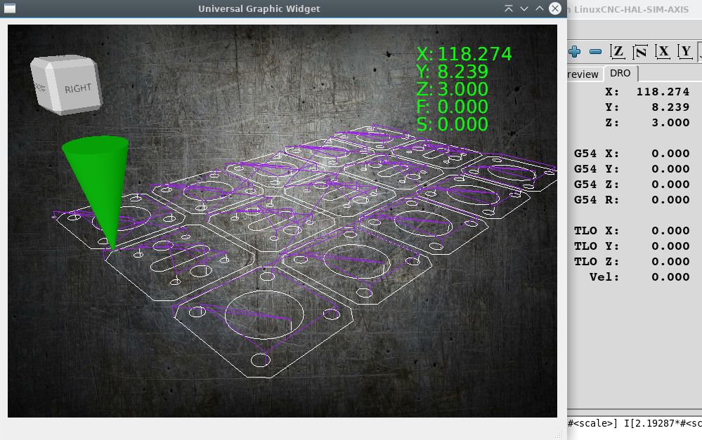

Hi Reinhard,
I have no clue how to rip out the lcnc interpreter haha.
Now the tool is moving, with on and off colors. Tool stepfile's are welcome.
If no stepfiles are given, the tool is the old style cone.
The toolpos can be updated by direct function call from Python or C++.
The tool is translated, rotated by a quarternion with xyz and eulers.

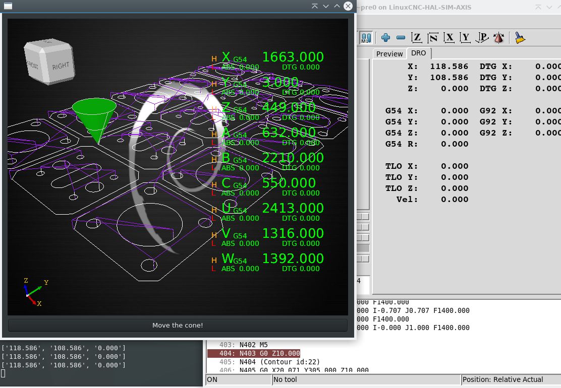

*Ok, I only referred to you proposal to add nml functionality to the grafical widget.
I think if we demonstrate how to pass the nml trough python to the widget it's ok for Chris. Then your proposal is applied.
It is a complex widget, with many configuration options, it is more work at the python side to setup.
But it only takes about ~300 lines of templated python code to configure the widget once.
I was thinking at the moment also other programs can use this. For example machinekit could use it.
For udo, he can pass direct function calls to update the tool.
For halcore, the same, we update the toolpos from the golden ring.

Today i made a extra Python module for nml.
For Python users to run the Graphics app inside your program only 2 modules have to be loaded :To initialize the nml :To initialize the Grapics Widget:To get the toolposition xyz from nml.Then to update the graphics widgets toolposition from the nml
Video ufile.io/0c9sao8h
Total ~90mb project archive we.tl/t-iiVWHpoXET
Python gui with "graphic widget module" and "nml module" at work.

Latest project archive: we.tl/t-3bzfbHvt4Q
The project includes :
- Python gui example
- C++ gui example
The project includes librarys for Python and C++ :
- Opencascade
- Nml-plugin
Both Python and C++ gui examples will update tool + dro's if lcnc is running a program.
The Universal Graphic Widget (libopencascade.so) is strictly seperated from nml.
The Nml-plugin is a stand alone library, used as helper to get the nml values.

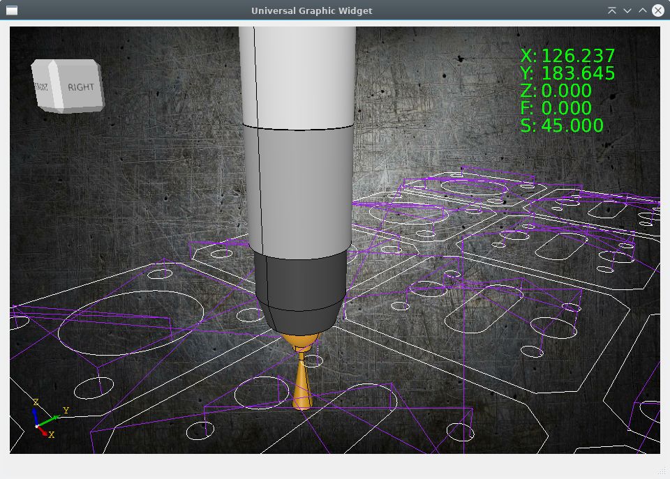

My latest archive, including tool preview. User can give a stepfile for tool on and off.
In this case the plasma flame goes on and off during the program. Very nice to see this happen.
This tool is now working in the c++ example gui. For the python gui i have to compile it yet.
Project archive:
we.tl/t-gJ8SnJ265p

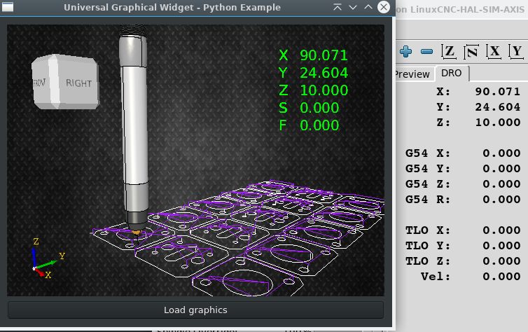

The Python users can try this archive : we.tl/t-l1cvYH9XyK
Python modules:
Qt_graphics_universal_widget/libpython/Qt_Nml_Python/PyNmlPlugin.so
Qt_graphics_universal_widget/libpython/Qt_Nml_Python/PyOpencascade.so
If you want to recompile the above modules yourself :
$ ./python3 configure.py # In each of above directory.
$ make clean
$ make
$ sudo make install
You can also sent nml commands to the nml-plugin, like start, stop, estop, etc.
Python gui runtest, shown at the picture below, loads stepfiletool and show's arc-on while program is running :
Qt_graphics_universal_widget/libpython/Qt_Nml_Python/./runtest_custom_tool.py
I will now leave the code as it is for a while.
