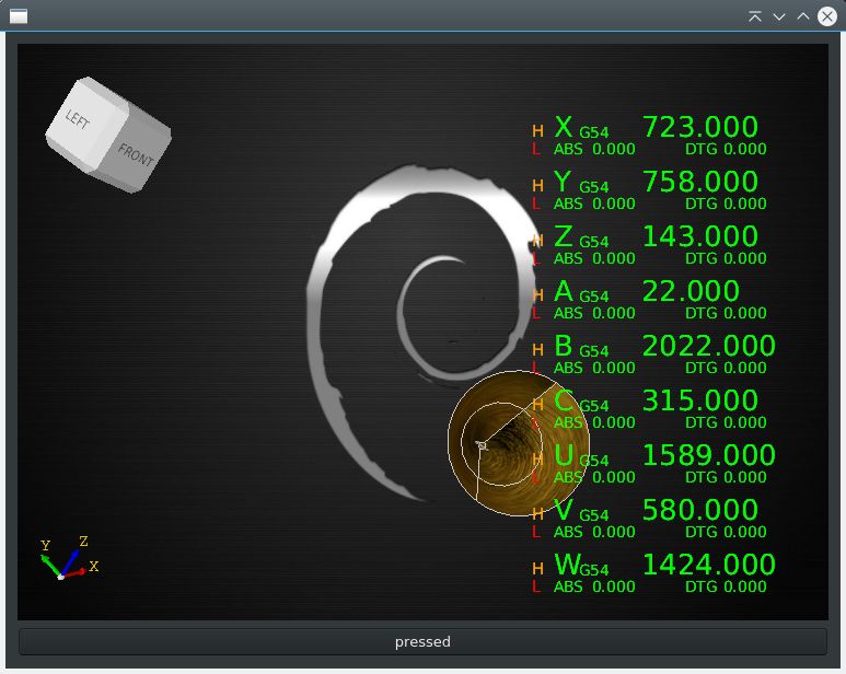

05 Sep 2021 19:09 #219689 by Grotius
Replied by Grotius on topic QT C++ graphics display WIDGET
Hi there,
O my god, my python knowledge sucks. I was doing struct's for Python. But in the end i ended up with a QVariant.
Today i managed to send multiple values in one Python function to the C++ widget.
self.occ.test1(QVariant(['one', 'two', 'three', 'four']))
And i managed to talk to c++ function from Python directly without using the Qproperty system.
class Sample:
      name = 'name_test'
      id = 'id_test'
ok = Sample()
self.occ.test(ok.name)
This Python code piece :
is most interesting and sent to the c++ opencascade widget.
By the c++ widget the value is recieved by a QVariant :
void Opencascade::test1(QVariant data)
    QStringList l=data.toStringList();
    for(int i=0; i<l.size(); i++){
        std::cout<<"list at i:"<<i<<" value:"<<l.at(i).toStdString()<<std::endl;
Where above the QVariant is converted back to a StringList, but can be a type float, int, etc.
You can also sent different types in the stringlist.
This code example is nice when we have to setup multiple user defined DRO textlabels at once, when program starts.
Attached the current C++ Python code archive.
Now we are ready to design the DRO setup.
Ok. Have a nice day !

05 Sep 2021 19:19 #219692 by Grotius
The actual Python gui :
Extra info for interested Python users:
1. Example python commands by QtProperty system:
property_id_0 = "property_background_picture"
property_value_0 = "/home/user/Qt_graphics_universal_widget/libpython/Qt_Occ_Python/Debian_Wallpaper.jpg"
self.occ.setProperty(property_id_0, property_value_0)
2. Example python commands by direct function call :
self.occ.FunctionName()

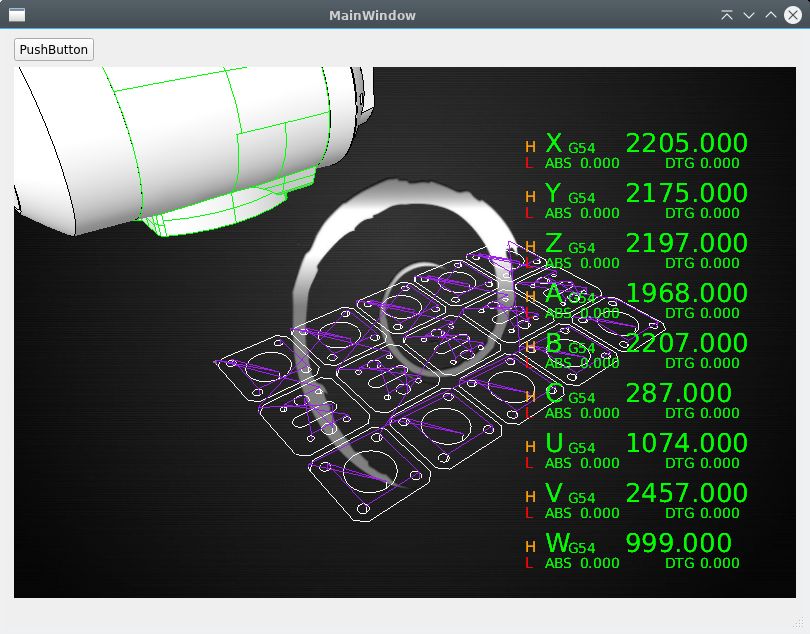

06 Sep 2021 15:51 #219768 by Grotius
Hi Reinhard,
Current status :
Can display a gcode file. (worked on today)
Can load a 3d stepfile. (working on displaying a tool_on and tool_off file)
For the dro's please take a look in the runtest.py file
There is a beginning made how to setup universal dro labels wich are sent by a variable of type : QVariant. to the c++ widget.
This seems to work nice.
Archive :
we.tl/t-PtJmdPFQor

06 Sep 2021 17:35 #219775 by Reinhard
Replied by Reinhard on topic QT C++ graphics display WIDGET
Hi Grotius,
its a really nice parser you used, but I'm quite sure, that it does not work identically to the linuxcnc interpreter. So better use linuxcnc interpreter to get reliable results (in the sense, that the grafical widget displays, what the backend tries to work out).
In the Python code, nml is already available.
Ok, I only referred to you proposal to add nml functionality to the grafical widget.
cheers
