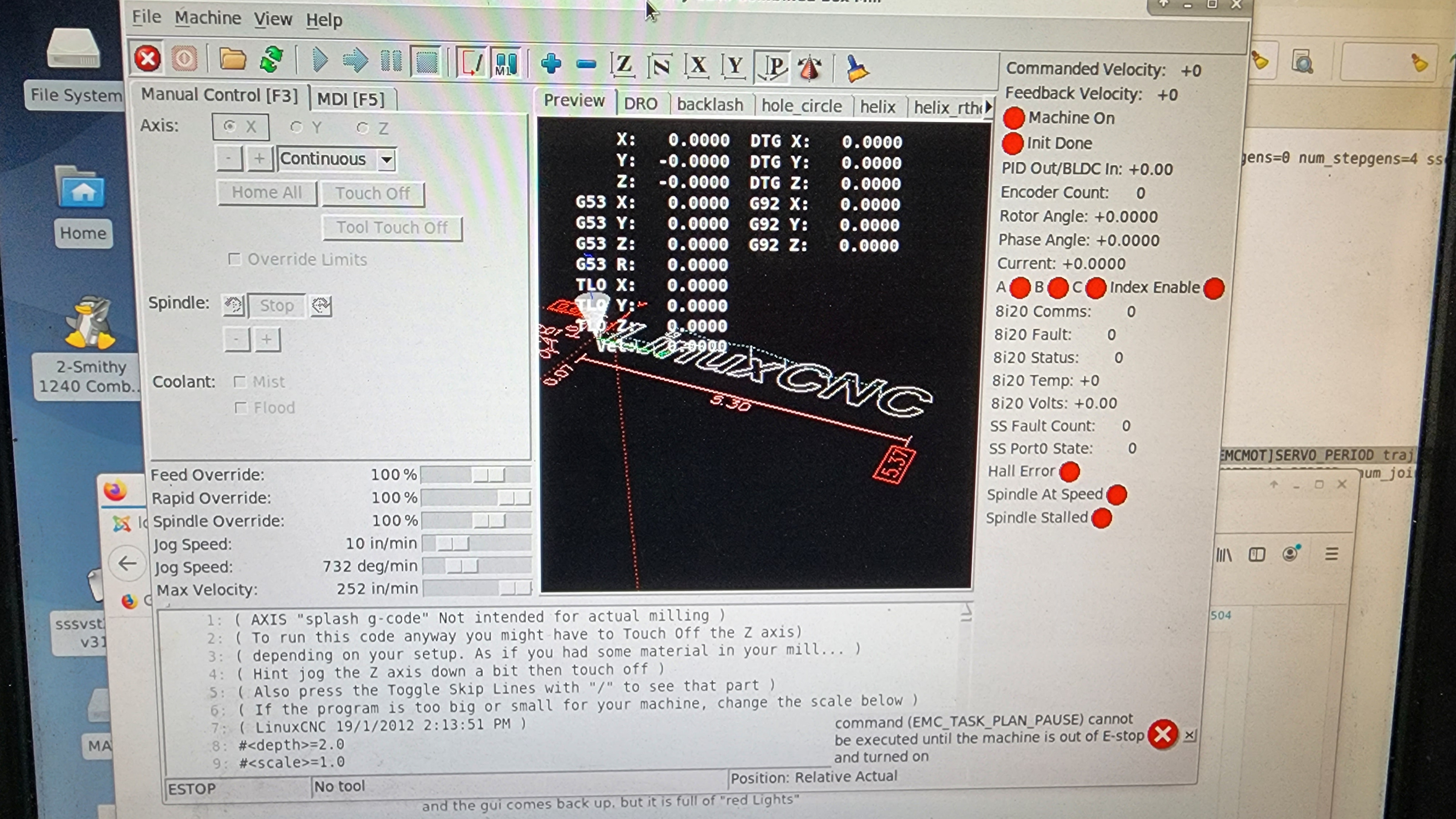

I changed the loadrt [EMCMOT] line back to what it was
loadrt [EMCMOT]EMCMOT base_period_nsec=[EMCMOT]BASE_PERIOD servo_period_nsec=[EMCMOT]SERVO_PERIOD traj_period_nsec=[EMCMOT]TRAJ_PERIOD key=[EMCMOT]SHMEM_KEY num_joints=[KINS]JOINTS
and the gui comes back up, but it is full of "red Lights" although the start button now works it won't let the home button become active.
I'll attach a pic
I'll attach a pic

- Posts: 19899
30 Oct 2022 22:45 #255506
Replied by andypugh on topic loading LinuxCNC on old smithy 1240
Has a line-break been introduced by accident into that line?
What are the "red lights" ?

- Posts: 19899
30 Oct 2022 23:12 #255511
Does it come out of e-stop?
The 8i20 side panel is all red because the 8i20 HAL (postgui hal) was disabled. You can try uncommenting that.
- LPMattei
- Posts: 58
30 Oct 2022 23:30 #255516
by LPMattei
Replied by LPMattei on topic loading LinuxCNC on old smithy 1240
yes, it came out of estop. I'll look for postgui hal.

- LPMattei
- Posts: 58
30 Oct 2022 23:49 #255518
by LPMattei
I enabled that line, it came up with 2 green lites this time, but when I tried it again to make note of them, it won't start gui again
- LPMattei
- Posts: 58
30 Oct 2022 23:58 #255524
by LPMattei
OK, so enabling the original line
gui comes up and 2 lites are now green "C" and spindle at speed
