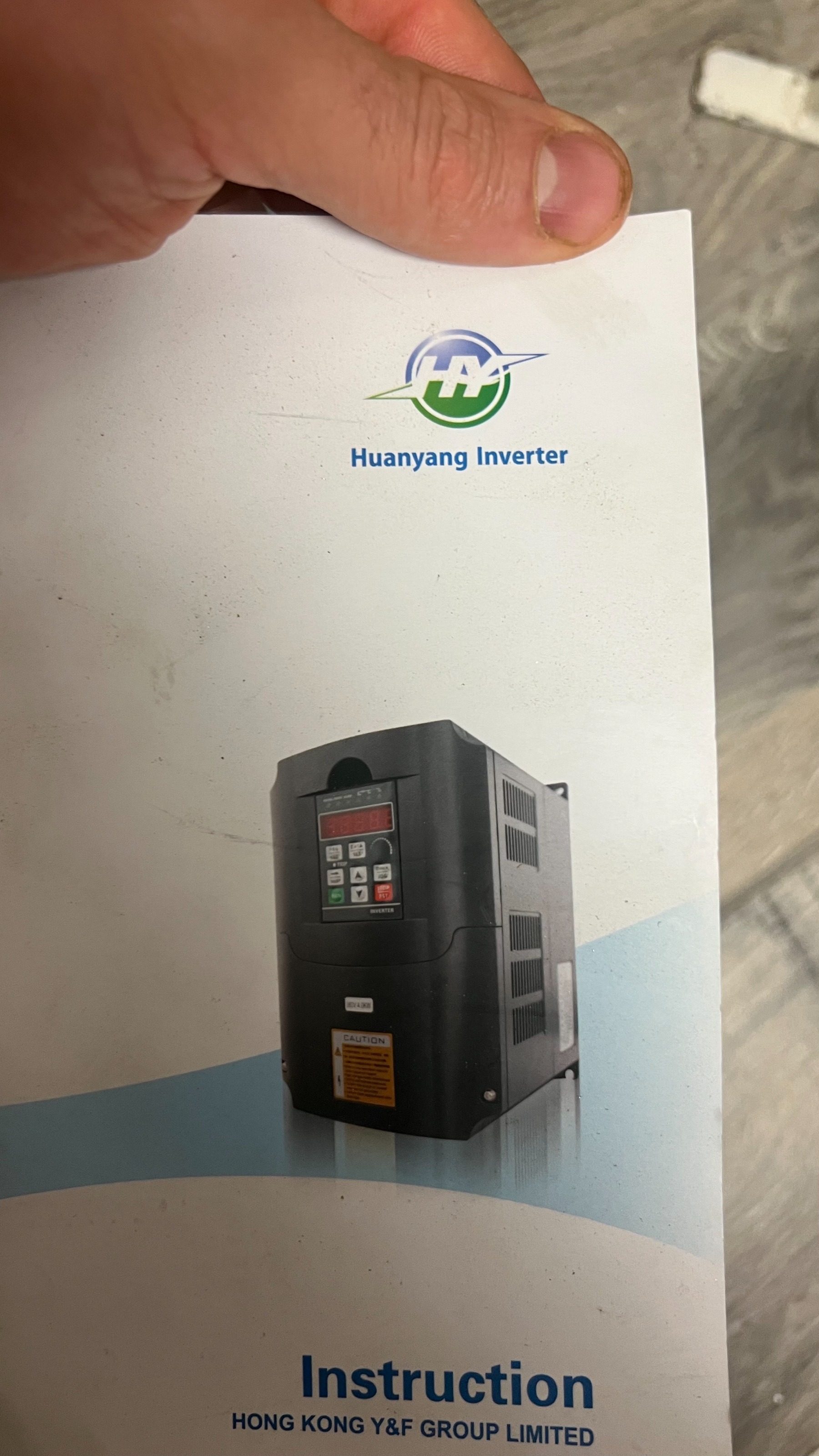

So what is the 7i84 doing exactly? It is essentially just a breakout board, it can take the inputs from the ethernet and output to the steppers?
The only thing that I am running off the machine is 6 stepper drivers and output for spindle speed control. the stepper drivers are just normal old stepper drivers. 3 of them are from steppermotor online and 3 of them are some other company that I don't know the name of. I currently have 4 inputs going into each driver (DIR+, DIR-, PUL+, PUL-) I believe that the PUL pin is also called the step pin on some drivers. So 24 output pins minimum I guess. Though I know that these can sometimes run off of 1 step and 1 dir pin too. I may want to add an output to control a solenoid at some point so 25. None of my motors or spindle have encoder feedback.
Then I have homing switches on each axis. 2 of them are your old school limit switches. I believe those are just wired to 5 volts and then have their input going to the board. So 2 inputs there. I have a probe that is just a simple switch. So 3 now. Then I have 4 hall effect endstop sensors. Those have 3 cables, but I believe only one output pin that goes high when is in proximity to metal. So 7 inputs total. Lastly, I wouldn't mind adding a handwheel at some point, but that isn't pressing or necessary. Idk, how many inputs they require.
Looks like the 7i96S is just 5 axis, and I will have 6 in total. So I am looking for another mesa board but there are like a million of them. Is it better to find a board that has step & dir in the name?

- Spindle - you mentioned 'speed control'. Do you have a VFD driving the spindle, and using a 0-10v analog for speed, and perhaps 1 or 2 "FWD" and "REV" outputs?

Spindle. I'll provide a picture of the VFD I have. My manual says that it can take either a 1-10v input or a 4-20ma input for speed control, and I believe a pin for reverse, then the grounds are wired together. I think forward is default but I can check on this.

VFD: you have two options to (easily) control that VFD. 0-10v (plus FWD/REV signals) and Modbus.
- Some people on the forum aren't too keen on using modbus for spindle control, and others love it.
- Modbus can have some latency which isn't good for tight spindle control (rigid tapping).
- However, it saves a bit on wiring, and you can use modbus data from the VFD back to LCNC for spindle speed, spindle load, temp, etc.
- As usual, read the manual - there's a modbus driver specifically for that brand VFD.
- If you don't know what modbus is, search the forum and user manual. There are also some good YT vids on LCNC and modbus for VFD's.
