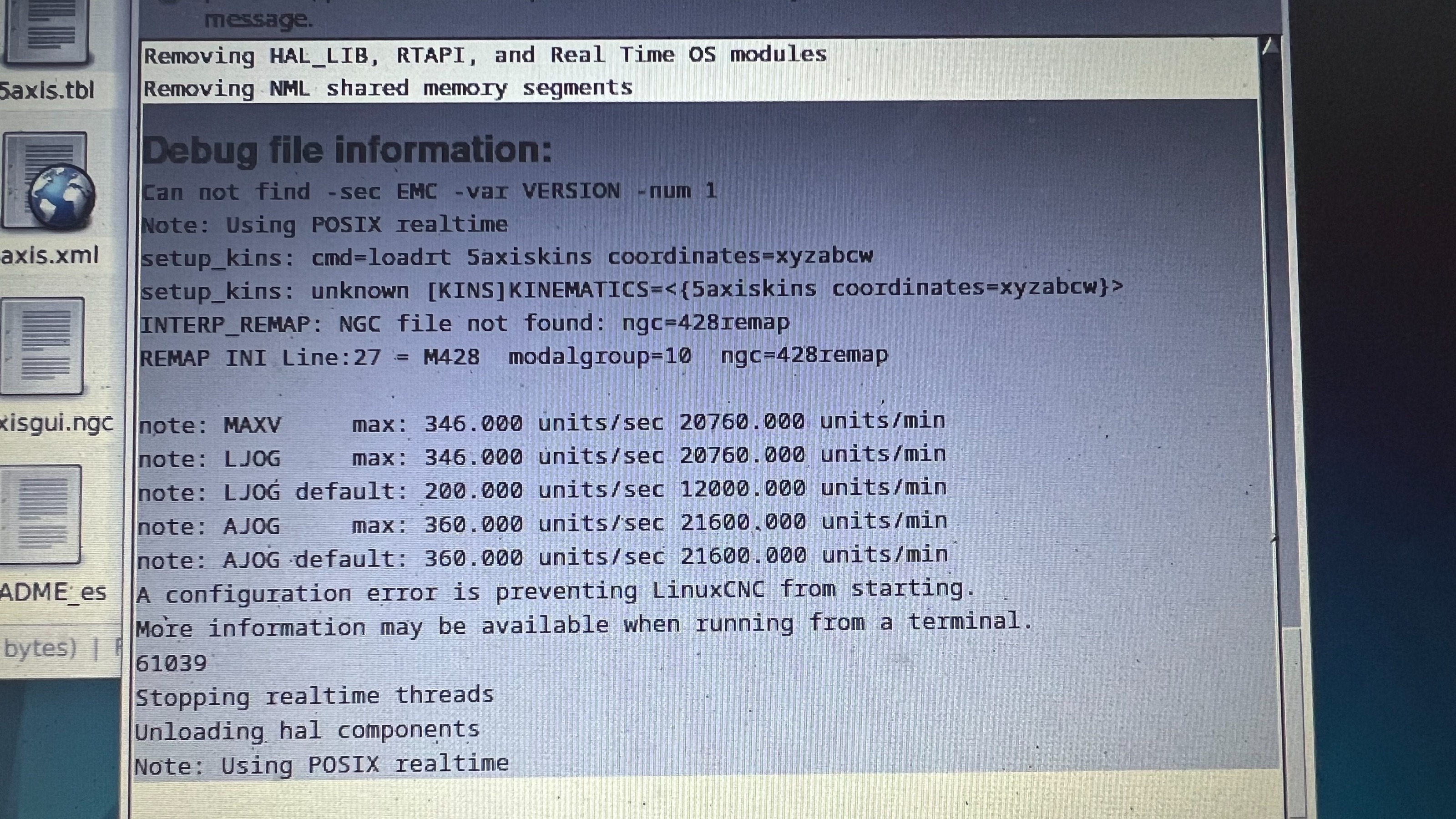

I tried altering the ini file as you suggested. There were a few places where I added to the xyzabcw config that weren't where you suggested. As well as moved a few other things around in the axis configuration file, mostly with setting up the joints and axis. But I ended up getting an error when I tried to launch that configuration. I have attached a picture of the error below as well as the full ini file. Note: I did not add the first line of code you specified as I did not know where in the initiation file to place it, perhaps this is the issue.
I do not consider myself a shy person, but I also have been working on this machine for so long and really just want to see it running right now if thats possible, even if it is a little hacked together. I have plans to build a more substantial machine in the future and would like to get deeper into writing kinematics then.

- The first line of code I posted is from the kinematic file indicating that an A axis can be added, so this is purely informative.I tried altering the ini file as you suggested. There were a few places where I added to the xyzabcw config that weren't where you suggested. As well as moved a few other things around in the axis configuration file, mostly with setting up the joints and axis. But I ended up getting an error when I tried to launch that configuration. I have attached a picture of the error below as well as the full ini file. Note: I did not add the first line of code you specified as I did not know where in the initiation file to place it, perhaps this is the issue.
- Note that in the hal and ini files any line starting with a '#' is a comment.
- The error in your screenshot indicates that a remap file was not found. Not sure as to why that happened but starting linuxcnc from the terminal ($ linuxcnc) may give you more information in the form of terminal output.
Below is a modified ini file for the bridgemill simulation that adds an A-axis as tested on my system (using master version but should also work in 2.9):
