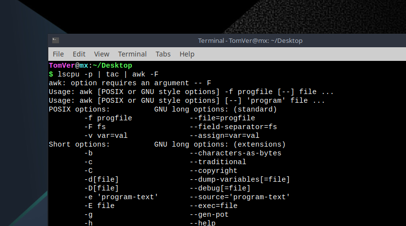

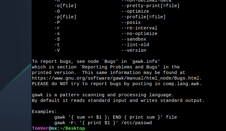

Ok I tried to get the info about the last core with this message.
lscpu -p | tac | awk -F
As stated I am very green with LinuxCNC so maybe the command or location in the terminal may be wrong. But the info was not gathered to make changes to the Gurb file. Attached screen shot of terminal results. I did try with --F and -f and -F,
Help.
Tom
Help.
Tom

Ok I see my error in the command for the core info and it showed 1,3 like in the other post. Now I just need to learn how to make the change in the grub file to see if that changes my Latency issue. One step at a time. (: (:

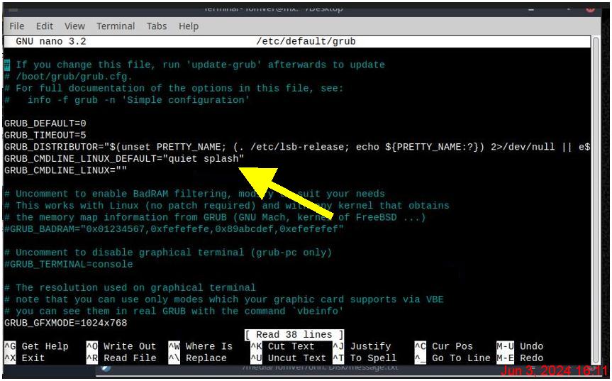

Once again I need help from the LinuxCNC experts, I got to the point of changing the Grub file, I have an Intel so I use the 3 for my printout.
I don't know how to make the change in the Grub file, I looked on line and on YouTube no help for this dummy, so please explain (simply for me).
Back space and retype don't get me there

Many ways to solve this
For beginners I recommend installing visual studios code as it can edit things in sudo mode
code.visualstudio.com/
1. Download the .deb file
2. It will show up in your downloads folder
To install it
3. Navigate to downloads folder in terminal or by going to the file explorer and right clicking when in downloads and select "open terminal here
The type "sudo dpkg -i code" then hit the tab button and it'll fill out the rest of the file name (it needs the entire file name, tab auto fills things once it only has one option)
That should install it
Now navigate to the grub file in file explorer, right click and select open with code.
Now you can edit like any text editor. When you save you will get an error saying run as sudo and click yes. That should solve it
Vs code is also great for editing gcode files and such

Why not simply use
$ sudo nano /etc/default/grub
edit the file
then hit <ctrl>+X and Y then Enter to save.
[edit]
Are you referring to this grub modification?
forum.linuxcnc.org/38-general-linuxcnc-q...-irq-affinity#292969
Not sure if you want that but there is also a script at the end of that post that should do it all automatically.

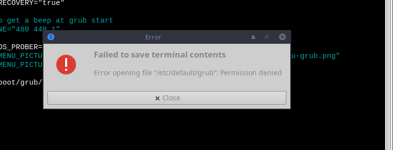

Thanks I have figured out how to make the changes in grub but not how to save it. I did see the options at the bottom, and thinking about it I was not having the complete keystrokes to do the write, Adding the ctrl key was what I was missing. When I tried a similar route to windows it get a denied message. I assume when I do the Ctrl^X it will then ask to replace the grub file with the changed one.

As Aciera suggested, you must use "sudo" when launching the
editor to edit system files:
