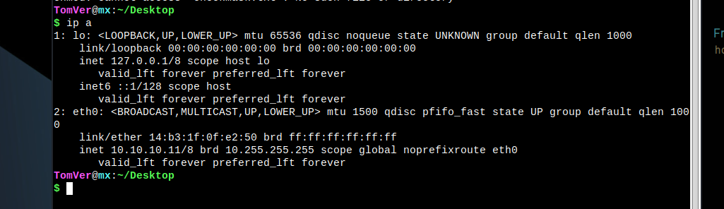

Can you run this script to check your setup?
Download
chmod +x checkmask.txt
./checkmask.txt ethernet_device_name
ethernet_device_name will be something like eno1 or enp0s25
You can get a list with the command
ip a
Download
ip a

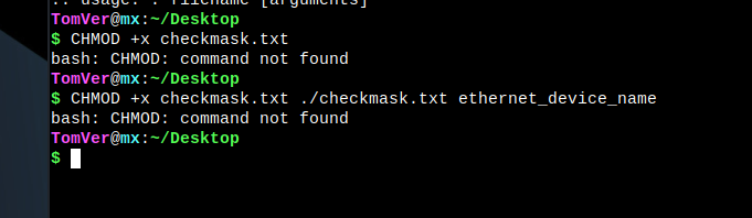

Well I am dumb and a stick, I got the ip a and attached it here.
But had no luck getting the other info you want, I am not a linux person so you will need to write exactly which the commands are needed for me to supply the info to you.
I tried to use the terminal but no luck, I did do file searches but could not find that file (checkmask.txt).

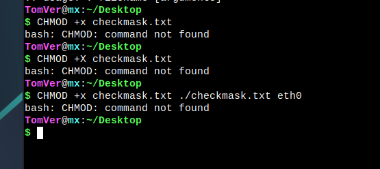

Case is important in unix/linux commands
(CHMOD is not the same as chmod)
./checkmask.txt eth0

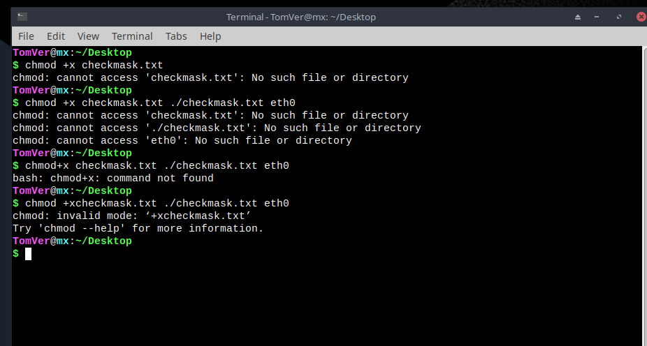

CHMOD is not the same as chmod,
That is, there is no CHMOD command
but there is a chmod command.
first command:
second command
You should be able to copy, paste these into a
terminal window (in the Downloads directory
since that's where downloaded files go)
first command:
second command

1. You have to know where you downloaded the file
Note, at least with Firefox, you can specify "Save link as"
so you know both the name of the saved file and where
its been saved.
2. chmod+x is not valid, chmod +x is (note the space between chmod and +x )
its been saved.
