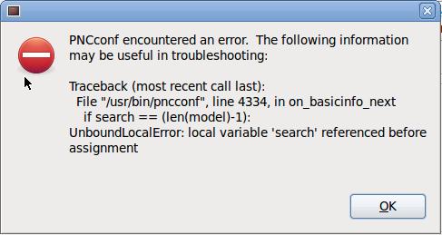

So I actually was trying to run pncconf over the weekend was getting the error below. After digging into the python I narrowed it down to the missing firmware files.
As a suggestion, can you have some kind of popup to complain when the firmware files are missing rather than getting this obscure error?
It looks like in on_basicinfo_next() method in the
for boardnum in (0,1):
when you attempt to enumerate the "model" list, the value of search doesn't get set because the "model" list is empty.

Drembedded exactly what were you missing? PNCconf does some checks for missing firmware so I need to know the special case you found.

Sorry, I wasn't very clear..
Over this last weekend I tried pncconf that was part of the 2.5 release. I wasn't aware of your zip file with the 5i25 firmware files. So when I tried running pncconf, I got that python error.
My suggestion is that if someone else tries to run pncconf with no firmware files in the /lib/firmware/hm2/5i25, we should catch that and complain to the user rather than letting python throw an error.
Just a suggestion
Just a suggestion
