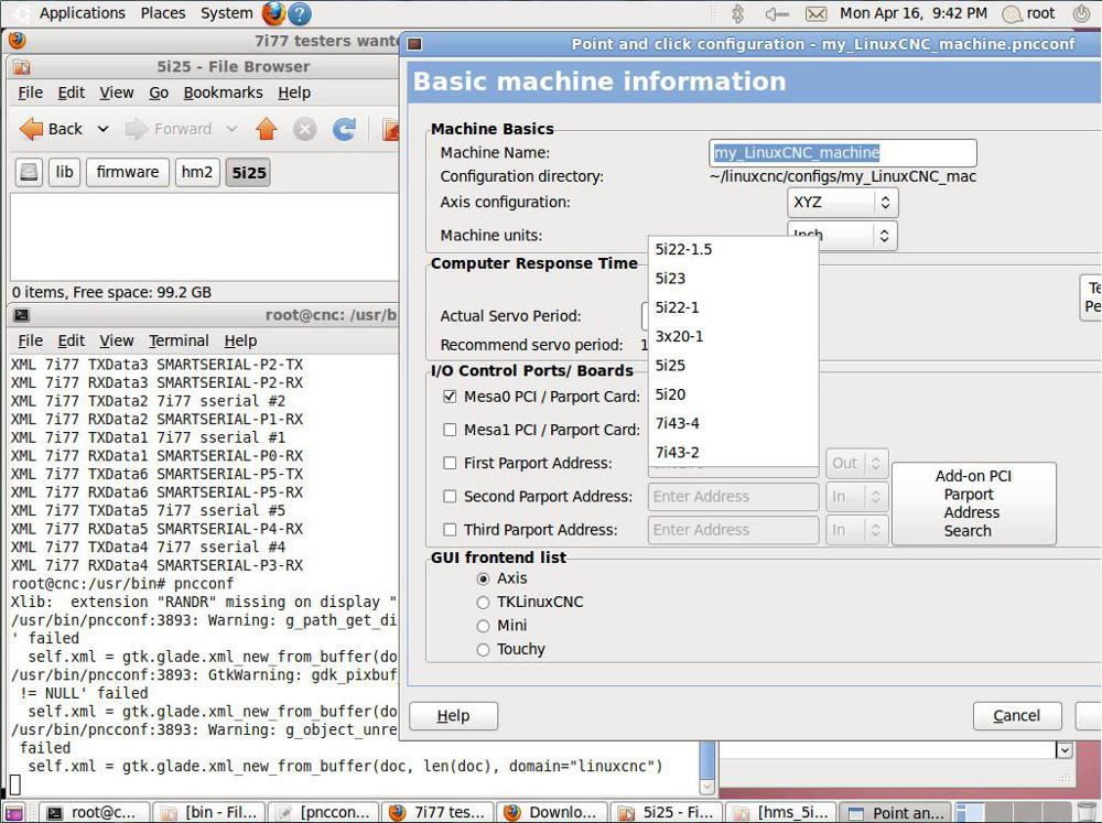

What I don't understand is you should not have seen 5i25 as an option without the firmware installed.
is that what happenned?

Ok thanks. Yes if the 5i25 folder is there but no firmware is in it, then pncconf would not catch that.
Did you add the 5i25 folder or did it come with the rest of the hostmot2 firmware. (it didn't used to come with them)
don't worry about those warnings.
The sserial tab1 (and 4 if you have two 7i77 cards) has the analog (pwm) output selections.
tab 0 (and 3 for two 7i77 cards) select the 7i77's I/O points.
Thanks for testing that for me.

To be honest I'm unsure how the /lib/firmware/5i25 directory was created. I went back and looked at the install packages for linuxCNC as well as emc and didn't find any references to this directory.
So it would seem that I am a victim of my own doing. I must have created when I first started working with pncconf several months back.
Sorry for the red herring.

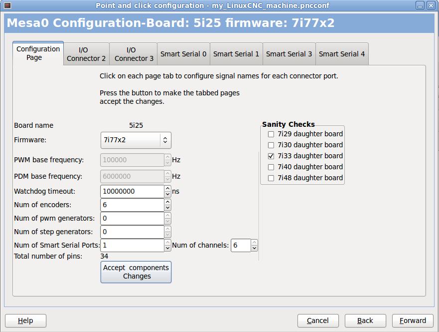

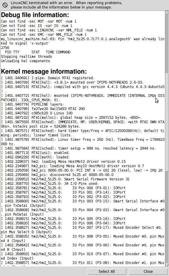

After updating linuxcnc I did get tabs for smartserial, which is pretty intuitive. I set the PWM outputs appropriately. When I finally get to the A axis config tab I am not sure how to use the open loop test feature - I get errors if I press either "Enable Amp" or "Reset Encoder" (I'm assuming this is because I haven't defined outputs for these functions). What do "Fast Dac Speed" and "Slow Dac Speed" mean? I'm familiar with the acronym but I see no units and I don't know what I should expect to happen when I do something with them.
I tried running LinuxCNC to check the HAL meter but I get errors when starting it too. Do I need to have a field power supply connected just to try to look at an encoder input or will the 5i25-supplied 5V suffice? I know the encoder is being powered and the lights are on.
Thanks,
Max
Thanks,
Max
- Posts: 7963
- Thank you received: 2164
18 Apr 2012 04:28 #19328
Replied by cmorley on topic Re:7i77 testers wanted
if you run pncconf from a terminal you mat see error messages while trying to use open loop.
slow speed dac and fast speed dac are just preset voltage outputs. select one and adjust it to a value you like.
I suggest a low number for the first trial.
could you post your HAL and INI files?
