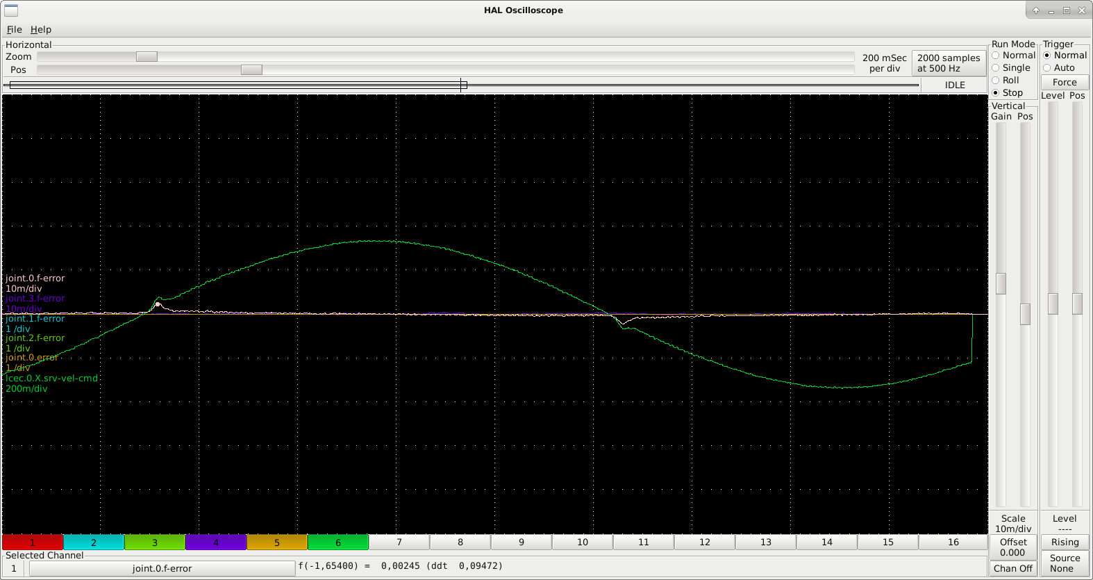

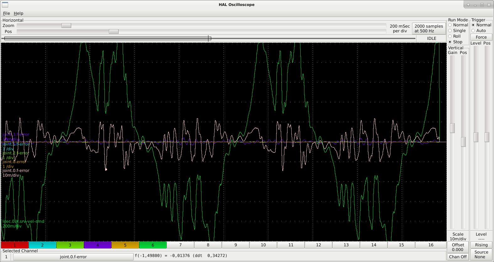

19 Aug 2020 11:51 #178701 by jirkam
Replied by jirkam on topic ASD-A2 EtherCAT on LinuxCNC
Hello.
I had a Delta servo service technician.
He tried to set this up.
Autotuning:
The axis portal
J-L = 4, Setting bandwidth from 25Hz to 150Hz, vibrations still occured.
Measured resonance frequency via Scope was 12,3Hz = setting parameters P1-25 = 123 and P1-26 = 1 (higher value causes worse noise) but it did not help. Then I set P1-29 = 1 to automatically find and filter low frequency vibration but vibration were still here with small movement command.
X axis
J-L = 4, Setting bandwidth from 25Hz to 150Hz, best result was around 70-80Hz bandwidth.
Measured resonance frequency via Scope was 2,5Hz = setting parameters P1-25 = 25 and P1-26 = 1 (higher value causes worse noise) but it did not help totally.
Also I tried to set P1-08 = 2 and P1-68 = 50 to make it more smooth, no big change.
When the service technician left, I tried to disassemble the servos and test them on the table.
The result is still the same:
The green curve is vel-cmd.
Is it possible that I have something wrong set up in Linuxcnc?
Thank you jirka
