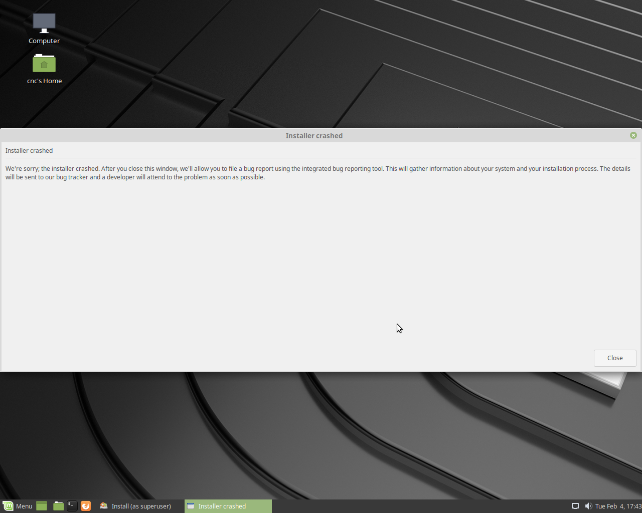

Tom I have followed the instructions but it bombed out at the end.
first message came up with a box copying files "install as super user"
then right at the end of the copying the message changed to "all most finished copying files"
Then it changed to installing files. that got most of the way through then a box with "installer crashed"
see screen shot:-
I tried it twice same result.
edit; I did not re: download the ISO again though

I haven’t tried it yet but was getting the same result. Installer must need some extra bits.

If the iso has changed please let me know and I will download it again.
I did this: downloaded the RT ISO via the forum link. . I then used balenaEtcher to make a boot usb. Etcher said that it had flashed correctly. The usb stick boots fine with mint on it as a live install. The I followed as above to try to install on the hard drive.

One thing to check regarding the installer crash, check the BIOS if the hard drive is set as AHCI.

Tom the bios was set as IDE I have changed it to AHCI and will try again in the morningOne thing to check regarding the installer crash, check the BIOS if the hard drive is set as AHCI.

I never had this issue, just read several posts on the net claiming it fixes the crashing.
