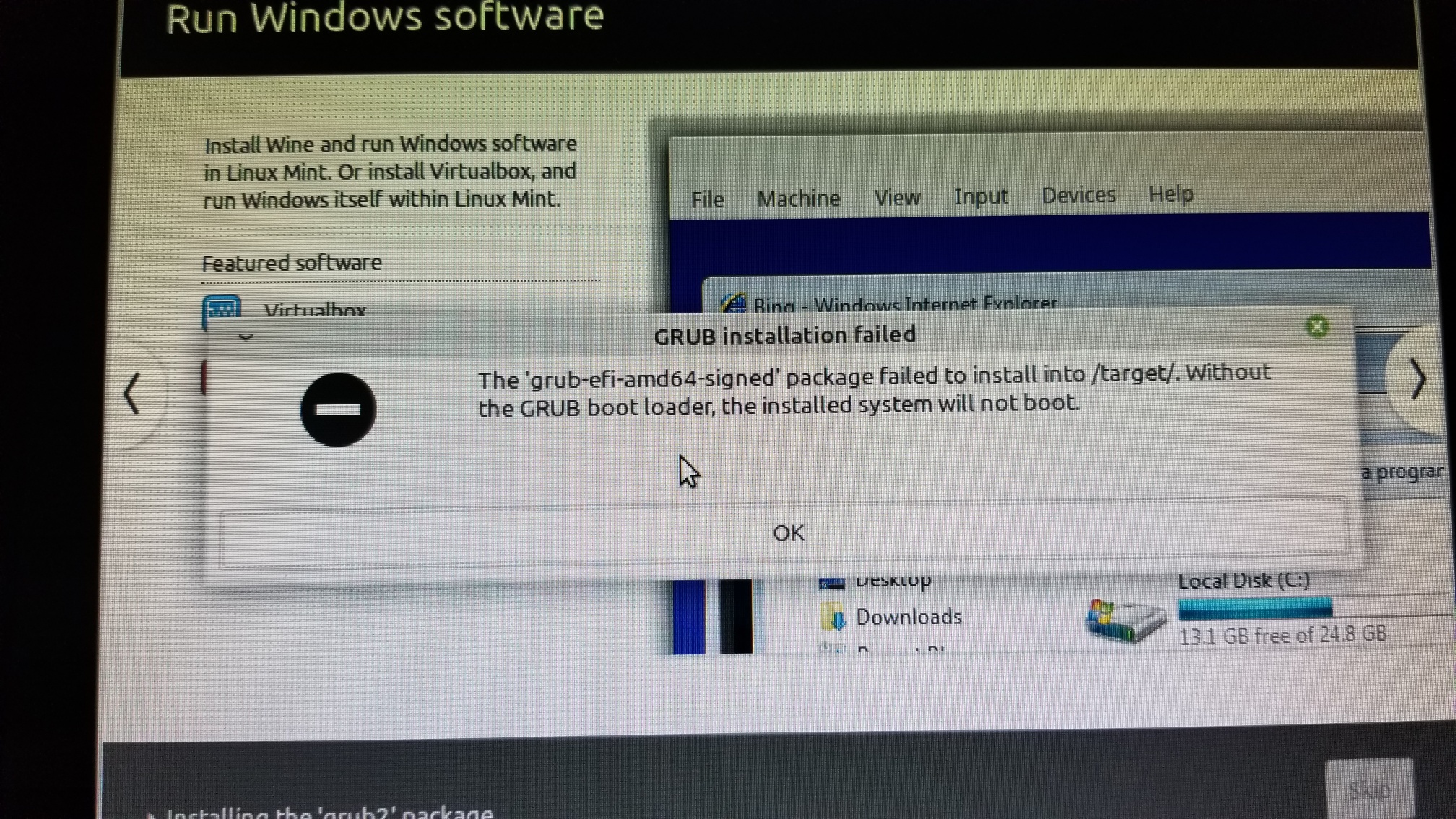

Look it's really important that you post the error, otherwise I can't fix the issue. As much we try to provide help sometimes we need help from you to fix things.
The 19.2 & 19.3 ISOs both are able to boot and install with an UEFI system.
For 19.2
When booting with UEFI the grub boot menu should be loaded.
When booting with a legacy system a isolinux boot menu should be shown.
The kernel command line for the grub menu will have the extra command efi=runtime
The kernel command line for the isolinux menu does not.
Could you try again and once in a live session runand runand post the output
And I have said in this post don't select OEM install.
For 19.2
mount | grep efisudo cat /proc/cmdlineAnd I have said in this post don't select OEM install.

Did you attempt to run the commands I suggest ?
This will let me know if eifvars has been mounted.
What wifi adapter are you using ?
Best option is to reboot, open a terminal and run lsusb
or runcopy the file, attach it here and I'll have look, it maybe just a case of rebuilding the ISO with the correct driver & firmware in there.
or run
sudo dmesg > dmesg.txtPlease Log in or Create an account to join the conversation.

20 Sep 2020 14:31 #182912
by dvn4life1972
No, I did not. By the time I saw the post about it I was already installing Tommy's 19.3 with 4.9.x kernel.
Replied by dvn4life1972 on topic LinuxCNC on Linux Mint 20 quick and nearly easy install
or runcopy the file, attach it here and I'll have look, it maybe just a case of rebuilding the ISO with the correct driver & firmware in there.sudo dmesg > dmesg.txt

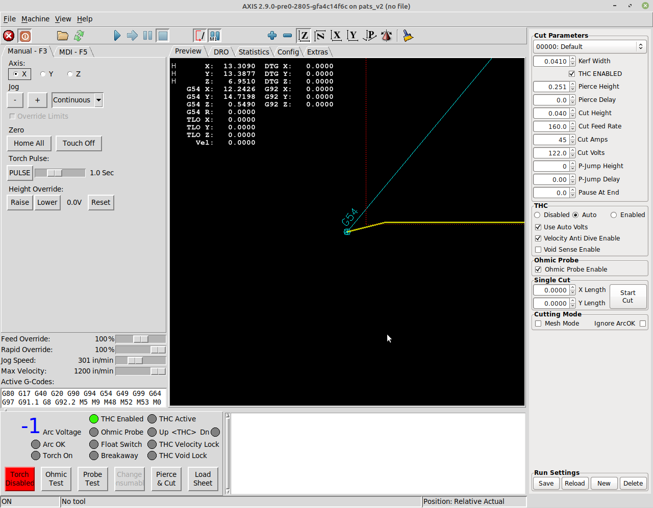

Happy to report that I did get 20.0 with the 4.9.x to work on my tiny BRIX PC. I came back to v20.0 because it didn't give me any issues with the graphics (screen res) like that kernel on 19.3 did. It did not work on this pc until I installed linux, then the kernel, then rebooted and opened with the RT kernel, then proceeded from there. Otherwise it kept running Linuxcnc in simulator mode only, not sure why this was the case...maybe something with this PC I reckon.
So far no thread errors popping up, and the machine is cutting a dry-run without issue thus far. I had no idea that this PC was going to be so particular with the Linux version, etc.
Edit 22SEP2020 after running updates on the dist, the latency shot up to 5M+. Had to reinstall everything again and that got it back to about 50k. Just noting in case someone else is going down the same road.
