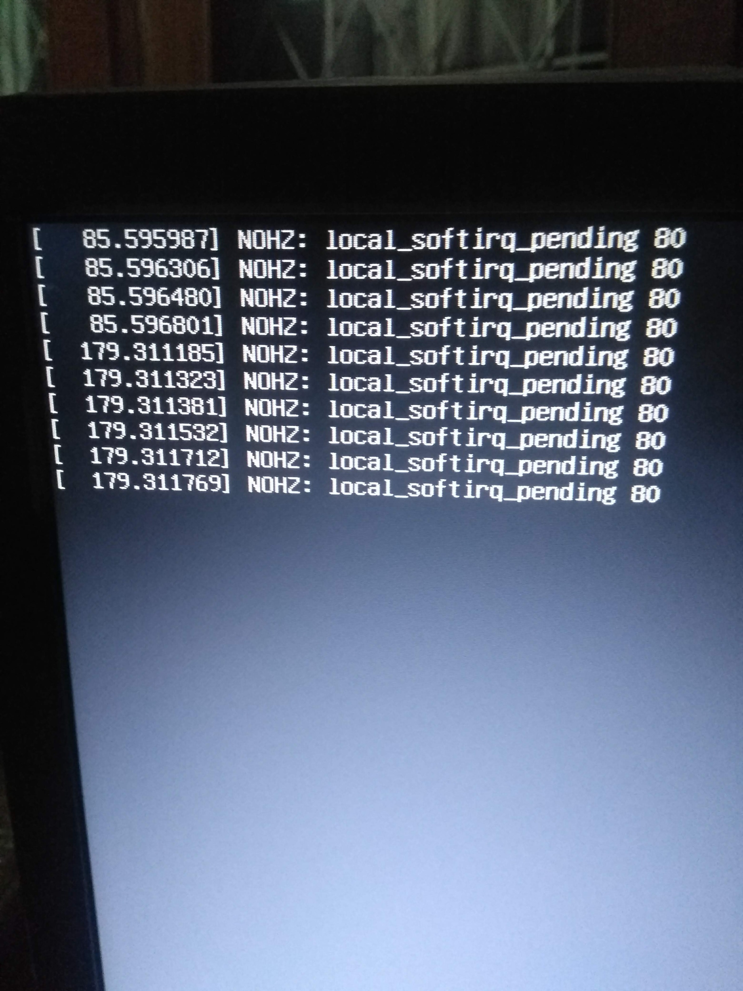

Can you explain why my servos actet so funny? or what did just happen =)
learned again some new... Like Grup. I didnt find it the first place and everything seemed to work so i forgot it.
testdriving still to do.

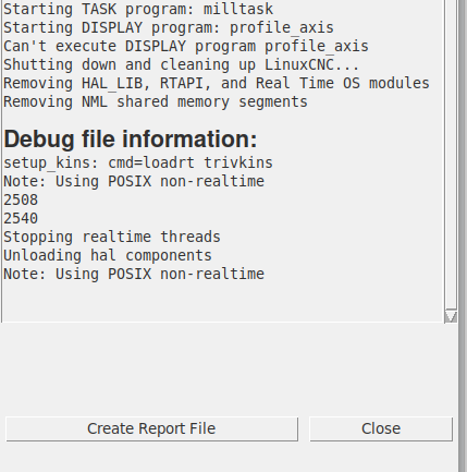

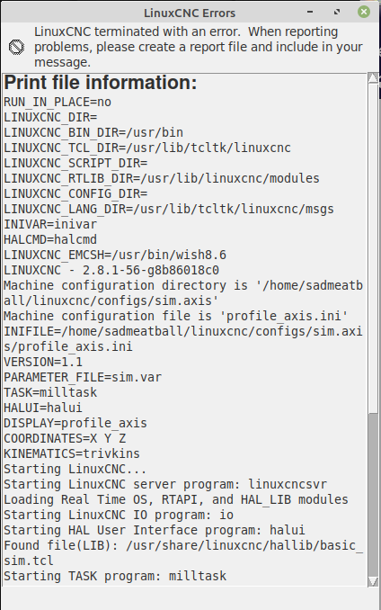

Hi
I have successfully installed linux mint 20 and linuxcnc.
I followed all Tommy's instructions for installing Linux mint and Linuxcnc, except the Instructions for "Editing the GRUB menu"
But when I try to open the linuxcnc program its show Linuxcnc errors.
I have a few questions:
1: Should I not skip "Editing the GRUB menu"?
(I only run 1 OS and it's Mint 20 on my computer now)
2: what does the image I screenshot mean?
(From Linuxcnc)
has anyone experienced this?
Many Many Thanks Before
Cak
(From Linuxcnc)
Cak
- Posts: 22030
- Thank you received: 7504
15 Feb 2021 18:56 #199004
Replied by tommylight on topic LinuxCNC on Linux Mint 20 quick and nearly easy install
The GRUB menu stuff can be skipped but it does require holding the Shift key on the keyboard when starting the PC and choosing advanced options>4.9 kernel and booting.
Otherwise LinuxCNC can be used only as a sim as the Real Time stuff will not be available with the generic kernel.
