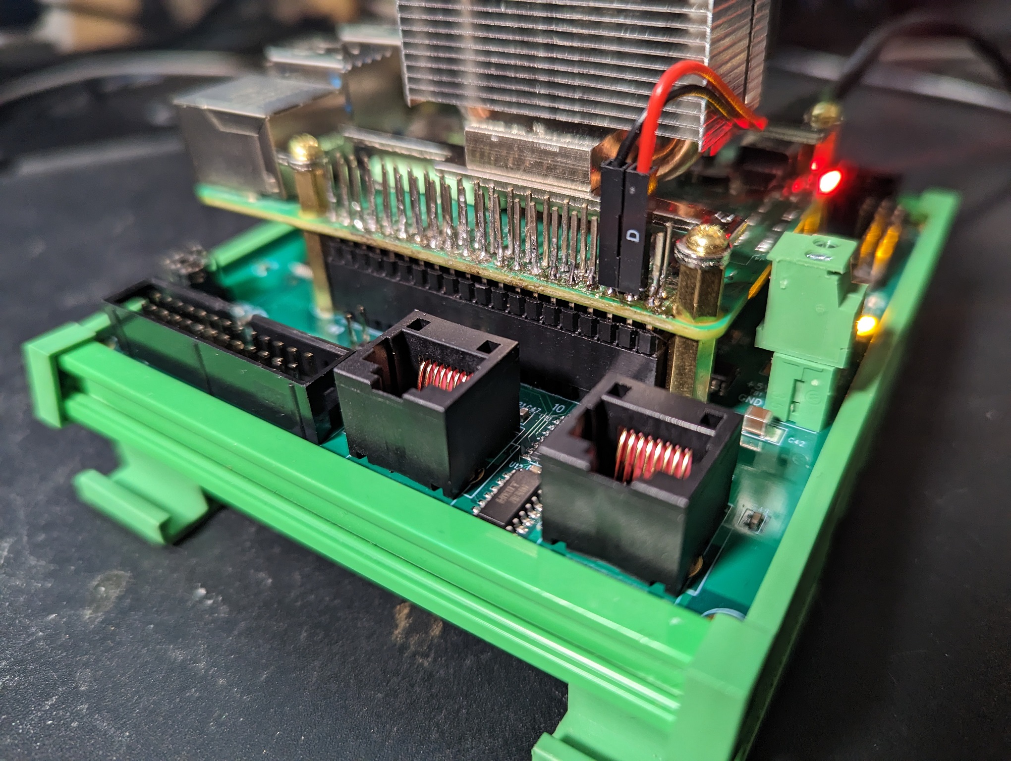

Good news / bad news
Good news is that the image I downloaded from this thread seems to be playing nicely with the 7c81.Bad news is that I bricked my 4GB Pi by giving it a poorly made cable while attaching it to the 7c81. There's a little more to the story than that, but I digress.
The Pi I'm having success with is a 2GB version which I mutilated during a previous project - but it's working well enough to SPI to the 7c81 - and I was able to make it work without a ribbon-cable (because it seems I can't be trusted to make those):
sudo mesaflash --device 7c81 --addr /dev/spidev0.0 --spi --readhmid
gives:unable to set bpw32, fallback to bpw8
Configuration Name: HOSTMOT2
BoardName : MESA7C81
FPGA Size: 9 KGates
FPGA Pins: 144
Number of IO Ports: 3
Width of one I/O port: 19
...The Pi I'm having success with is a 2GB version which I mutilated during a previous project - but it's working well enough to SPI to the 7c81 - and I was able to make it work without a ribbon-cable (because it seems I can't be trusted to make those):
Last edit: 15 Jun 2023 15:18 by MrRekt. Reason: typo; weird nested code tags

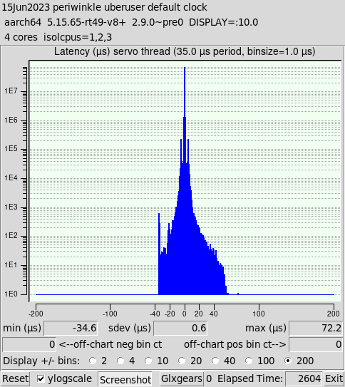

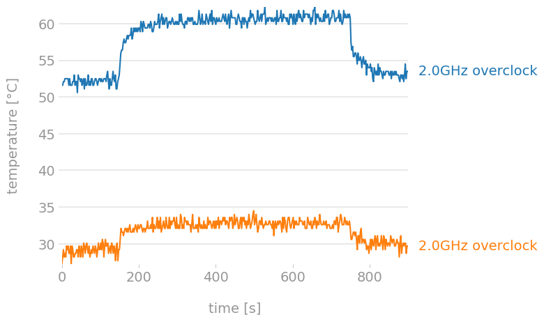

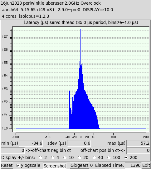

I was having odd performance issues while trying to improve latency in different scenarios.
Ultimately, I was able to conclude that it was a matter of the Pi thermal-throttling the CPU.I found that overclocking the CPU to 2.0GHz had a small improvement in LinuxCNC's latency test, but would eventually overheat and ruin test results.
I ended up running a number of tests with a tool called "stressberry", which monopolizes all 4 cores with prime-finding and logs the internally-reported CPU temperatures. After seeing that reported temperatures were far higher than would be expected with the actively-cooled heatsink I have attached to the Pi, I swapped out the standoffs for the heatsink with ones that were about 1mm shorter to improve contact with the CPU.
This small change had a tremendous impact on the stressberry tests:
This is the same test, run for the same amount of time, before and after.
I've been meaning to report back these finding, because I've been trying to get the fantastic results shown previously in this thread:
forum.linuxcnc.org/9-installing-linuxcnc...cnc?start=150#253623

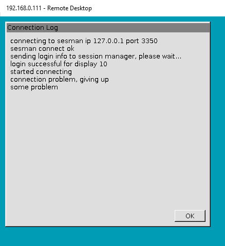

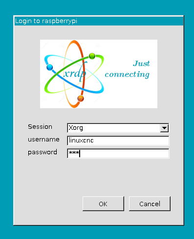

Some additional information:
I installed xrdp on the RPi.
The ifconfig terminal command outputs 3 sections; etho, lo and wlan0.
The eth0 section contains this line:
inet 192.168.0.111 netmask 255.255.255.0 broadcast 192.168.0.255
On my Windows machine I opened the Remote Desktop application, entered “192.168.0.111” in the PC name field, with username linuxcnc and password cnc.
But when I connect I only see a blue greenish empty screen.
After a couple of minutes it shows a "Connection Log" (first photo), when I click the Ok button it opens the "Login to raspberrypi" window (second photo), but entering my username/password brings me back to the empty screen for a couple of minutes, until the "Connection Log" window appears again.
