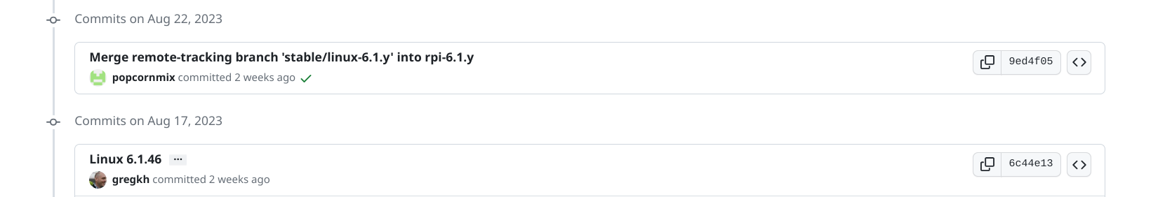

I have yet to try this but with more generous support from Cornelius upstream, we need to use I did not realise until recently that we are pulling down the Pi kernel from
github.com/raspberrypi/linux
When I started, the kernel version was 6.1.47 and now its marched forward to 6.1.50
The latest RT patch (which I use) is for kernel 6.1.46 so they are too far apart!
ref: mirrors.edge.kernel.org/pub/linux/kernel/projects/rt/6.1/
Going back through the Raspberry Pi commits, 6.1.46 was committed in 17 August on commitRef: github.com/raspberrypi/linux/commit/6c44...706ca48fd016d6b3d49a
So if we use the command above, we need to paste in the commit when asked for it.
Lets see how that goes...

Actually I was not right with my methodology, We need to pick up the merge afterwards.
Read the tail of our conversation here github.com/pyavitz/rpi-img-builder/issues/56
The commit should be 9ed4f05ba2e2bcd9065831674e97b2b1283e866d

Success! finally got it working! The kernel is in sync with the RT patch!
I did not that sudo does not ask for a password
I have updated the linuxcnc branch of my repo
github.com/rodw-au/rpi-img-builder-lcnc/tree/linuxcnc
I also added an instructions.txt file explaining the steps required. Repeated in the spoiler
