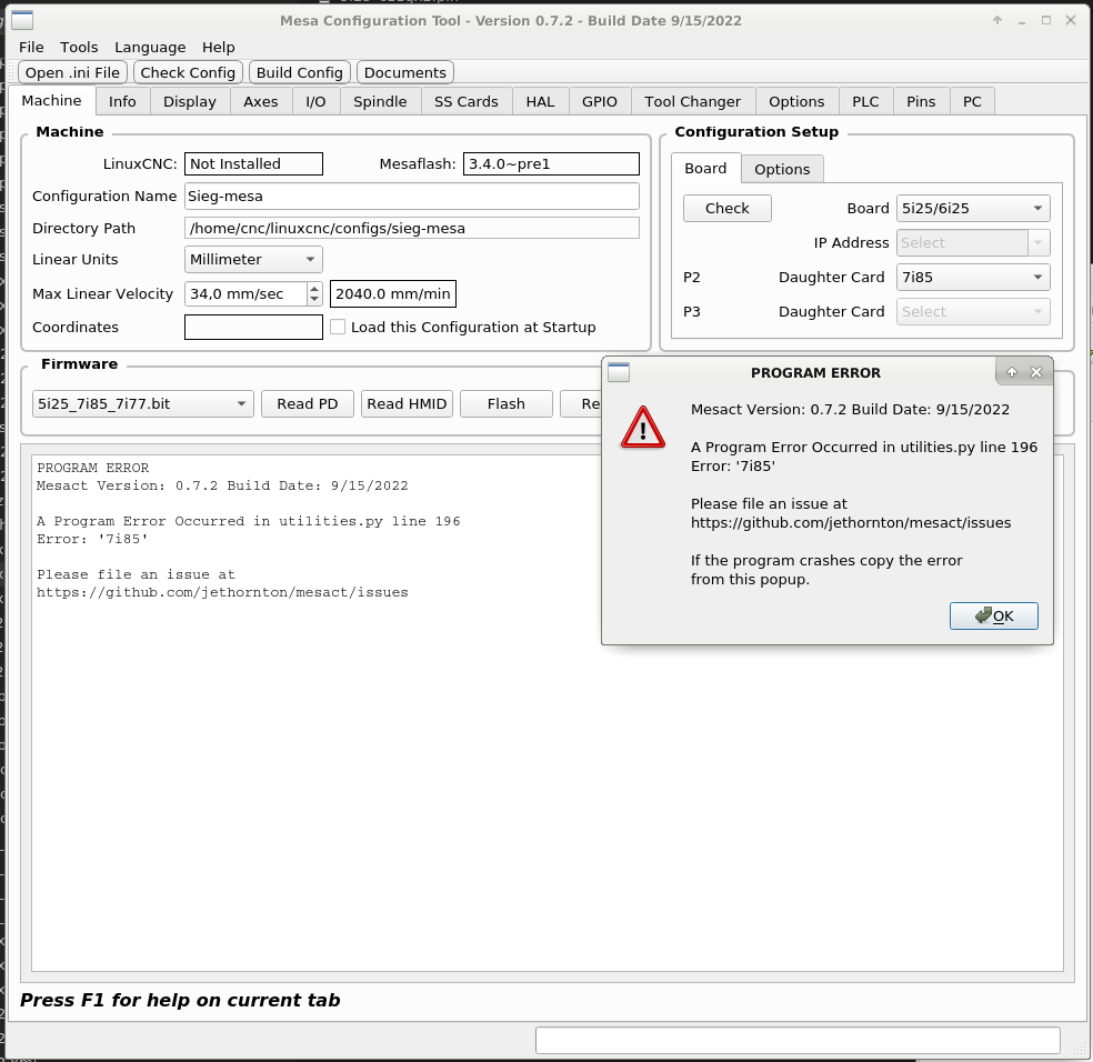

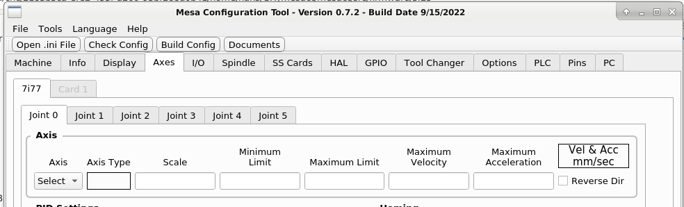

I wanted to create a configuration for a 5i25 + 7i85s.
It seems that the 7i85s is not fully supported yet.
I get this when trying to select the 7i85s:
And in the Axes tab it still says 7i77
Furthermore I wonder about the meaning of the bit/pin files in the 5i25/holding folder. Are those the not yet supported ones?

16 Sep 2022 13:21 #252095
by JT
Replied by JT on topic Mesa Configuration Tool
Thanks for the feedback, I'll correct that in the morning.
Yes, as I add support for bit files I move them from holding.
JT
JT

16 Sep 2022 15:36 #252116
by JT
I fixed the errors and you "should" be able to configure your axes but didn't have time to test that. Download a fresh copy of the deb from the menu File > Download Amd64 Deb in mesact.
JT
