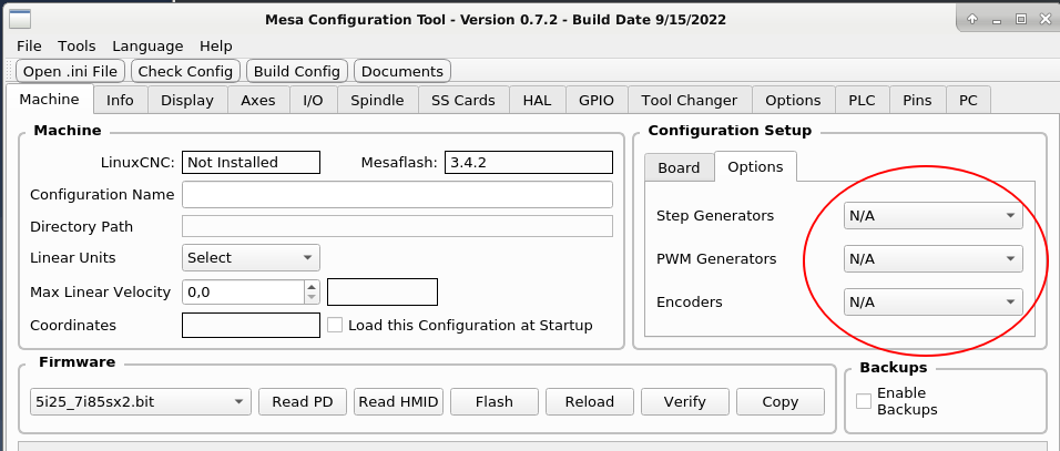

Some other annotations:
  • When I select a firmware like 5i25_7i85sx2 - shouldn't it be generally possible to select two daughter cards?
  • And these drop down menus are empty for me:
  • Backups - This could be understood as backup of the firmware because of the layout. Maybe change the text to "Enable Configuration Backups"
  • It creates some non-existing pins the the HAL file:
    hm2_5i25.0.7i85s.0.1.analogena
    hm2_5i25.0.7i85s.0.1.analogout0-scalemax
    hm2_5i25.0.7i85s.0.1.analogout0-minlim
    hm2_5i25.0.7i85s.0.1.analogout0-maxlim
  • In Axes I have to provide values for the PID controller. I think the config generation shouldn't fail I don't provide PID parameters in case I don't want to use a PID controller.

18 Sep 2022 17:28 #252306 by JT
Replied by JT on topic Mesa Configuration Tool
At this time I only have the code base for one daughter card... in the future I'll work on two daughter cards.
Also only some boards are coded to allow reducing the number of stepgens etc.
Backup text changed to be clearer what the function is.
I'll have to see why those pins are created for the 7i85s, can you attach your ini file?
Mesa cards need the PID so it's required.
JT
