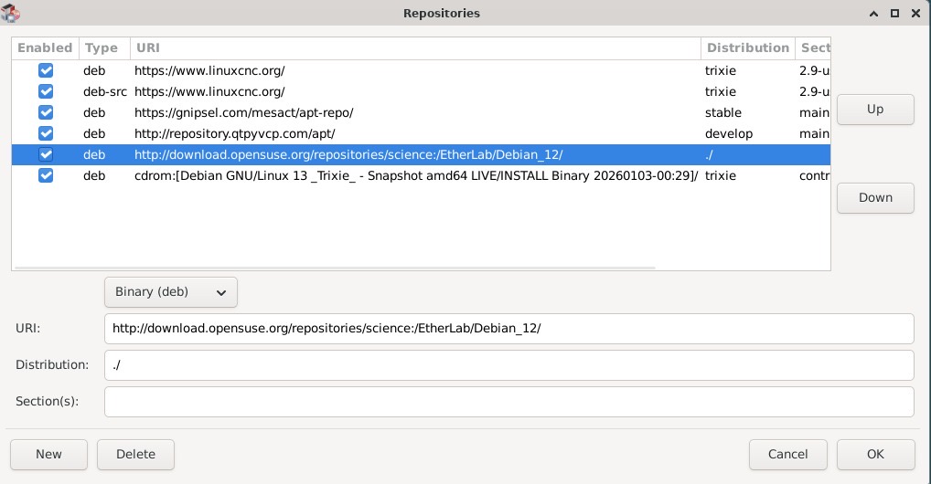

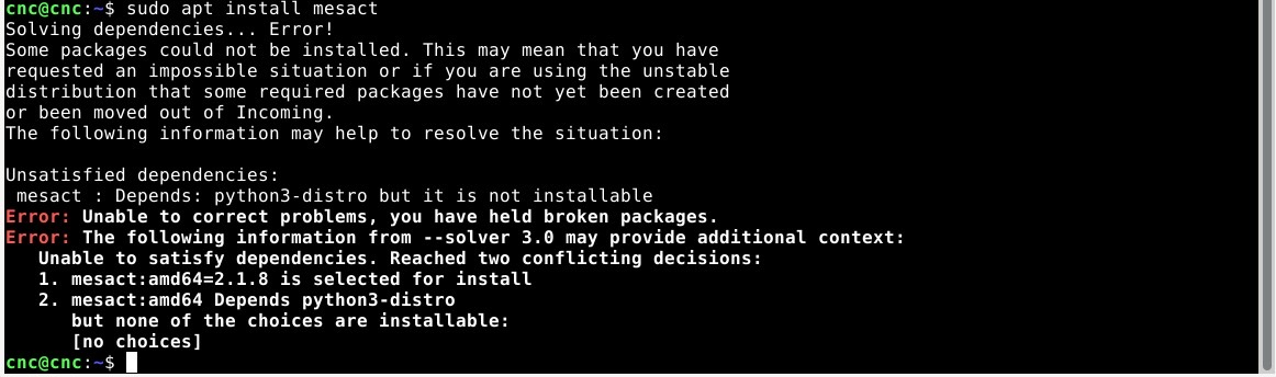

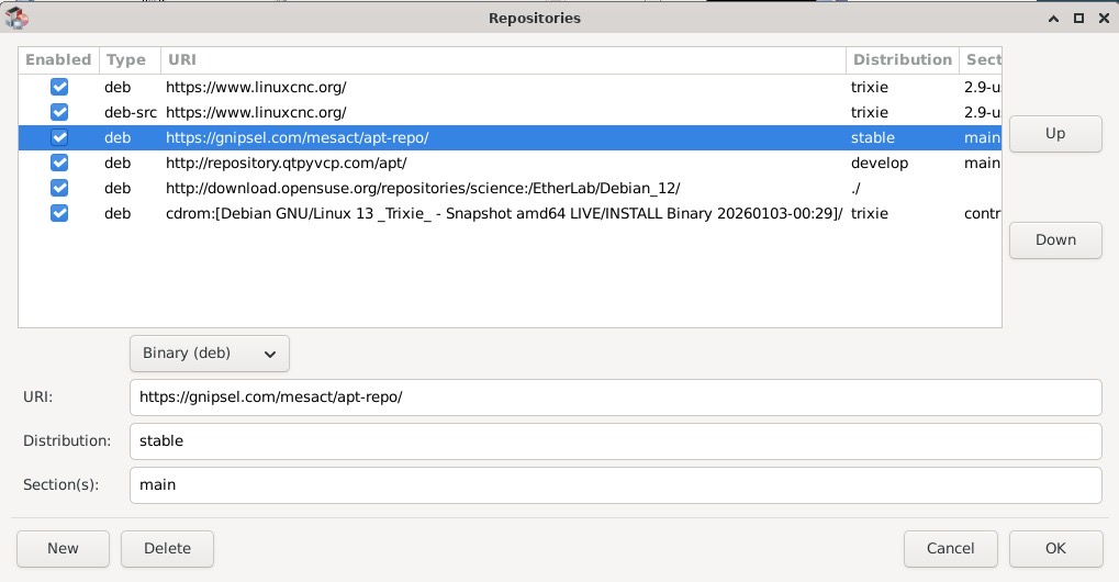

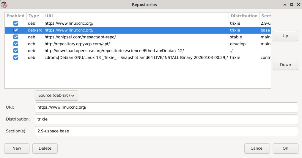

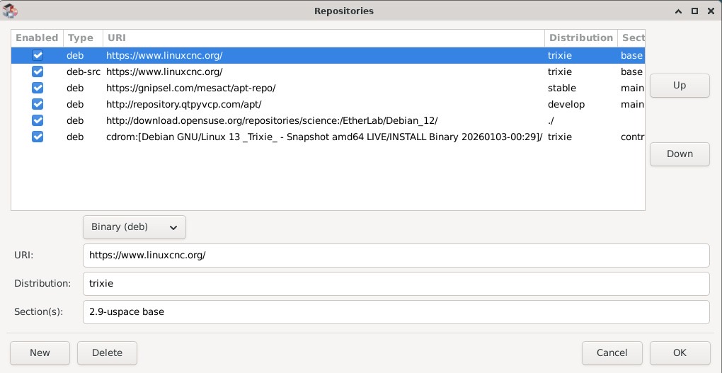

04 Jan 2026 09:45 - 04 Jan 2026 09:47 #340949
by 5_Zylinder
Replied by 5_Zylinder on topic Mesa Configuration Tool
First off, I'm not a computer expert. I've followed all the steps on the website step by step. I've attached a few screenshots. Can anyone tell me how to solve this problem?

04 Jan 2026 10:58 #340953
by 5_Zylinder
We already tried that yesterday. But then a new error message appears:
available from another source
Error: Package 'python3-distro' has no installation candidate
cnc@cnc:~$
in a terminal
cnc@cnc:~$
in a terminal

I don't see any Debian repositories how did you install the OS?
I'm downloading Debian 13 and installing that on SSD for testing.
JT
JT

04 Jan 2026 11:15 #340956
by michaeln
Replied by michaeln on topic Mesa Configuration Tool
there is the package "python3-distro" in Trixie.
But you have to configure the sources correct.
Please look here:
forum.linuxcnc.org/9-installing-linuxcnc...e-with-debian-trixie
Please look here:

04 Jan 2026 13:14 #340963
by 5_Zylinder
A friend of mine helped me and adjusted the source.list accordingly. Now the Mesa Configuration Tool works.
