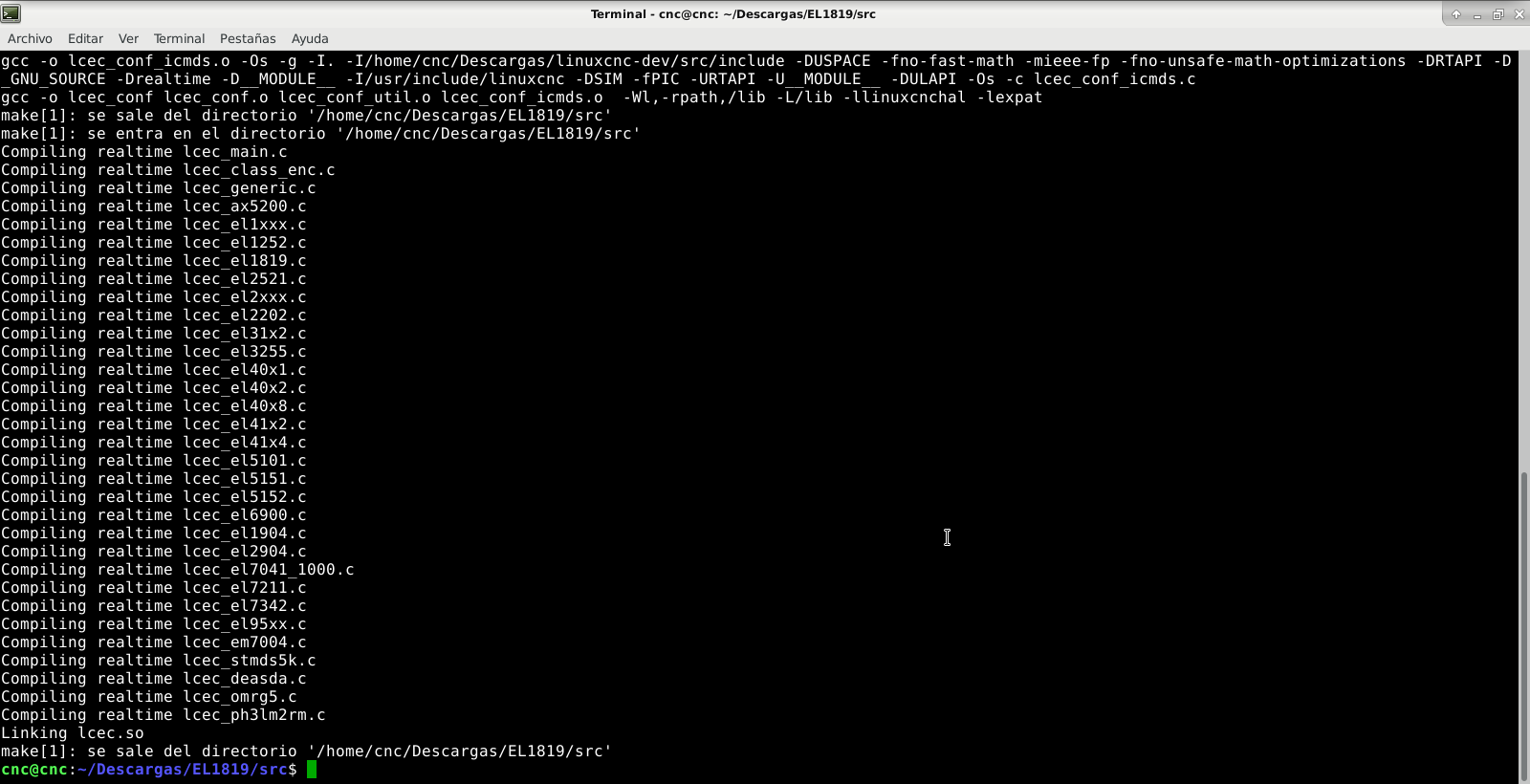

04 Feb 2020 21:01 - 04 Feb 2020 21:06 #156540 by chimeno
Replied by chimeno on topic Ethercat HAL driver
Hi Jirkam
you need to edit the Kbuild file for device compilation I attached it modified and compiled, it works fine.
regards
Chimeno
Last edit: 04 Feb 2020 21:06 by chimeno.

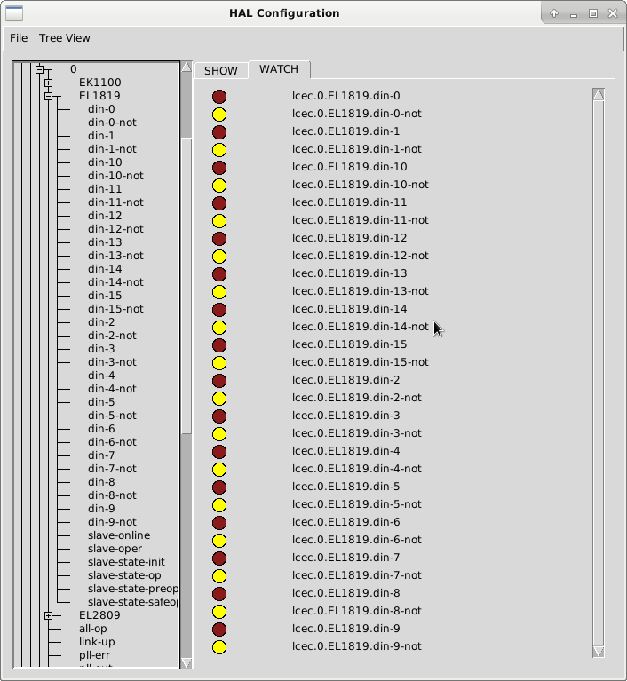

04 Feb 2020 22:16 - 04 Feb 2020 22:22 #156545 by jirkam
Replied by jirkam on topic Ethercat HAL driver
Hi Chimero
Thank you very much.
I did compile (compile.txt) and I probably did something wrong. (linuxcnc.txt)
But before "sudo make install" linuxcnc started (EL1819.png) but did not respond to input. I don't even know if I tested it correctly.
I connected 24V and input. Is it right? I don't trust myself anymore.
Can you advise me?
Must be a PC restart?
Thanks a lot . Jirka
