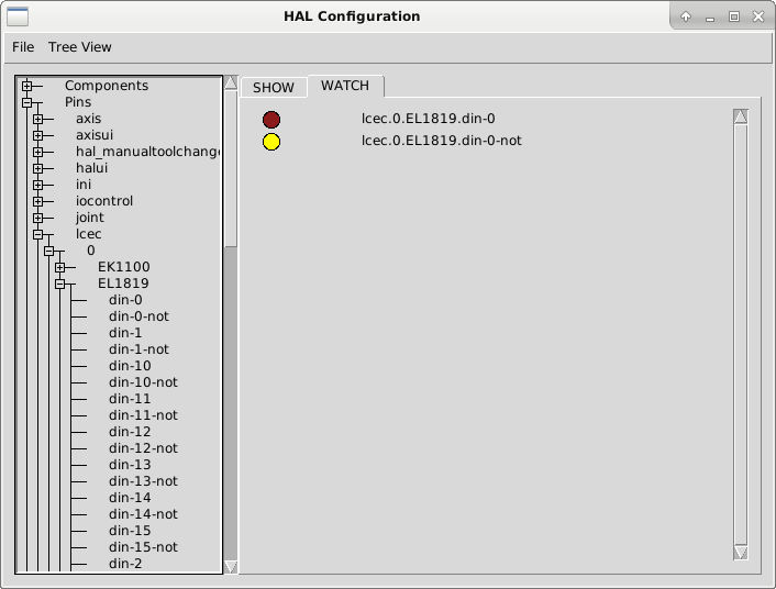

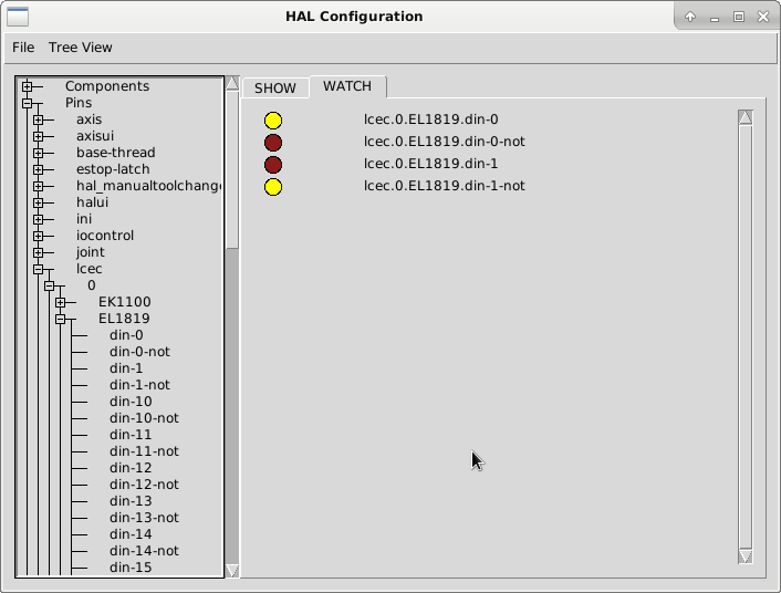

Replied by jirkam on topic Ethercat HAL driver
Hi Chimero.
I modified EL1904 to EL1819. I added channels.
Thank you very much for the edited files.
Compilation Ok. Start LinuxCNC Ok.
When I connect 24V (or 0V) to input # 1 I don't see a change in HAL Configuration.
It's good?
Thank you very much for your advice.
Jirka

Hi @jirkam,
EL1904 is an input terminal device that is associated with the safety set EL6900, EL1904, EL2904, works differently and is not a good starting point for standard terminals, I advise you to use other examples lcec_el40x1.C and lcec_el40x1.h
It's good?
It is not good, I would have to change, can you verify that the device is OP mode? One way to do this is by starting linuxcnc and while you are running, in a terminal you visualize it with the command
ethercat slave
I attached my .xml file to compare with yours, it works well for me.
regards
Chimeno
