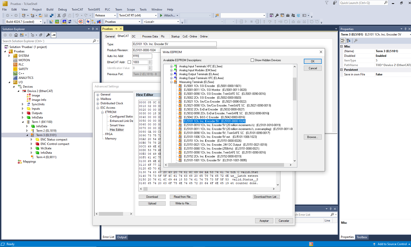

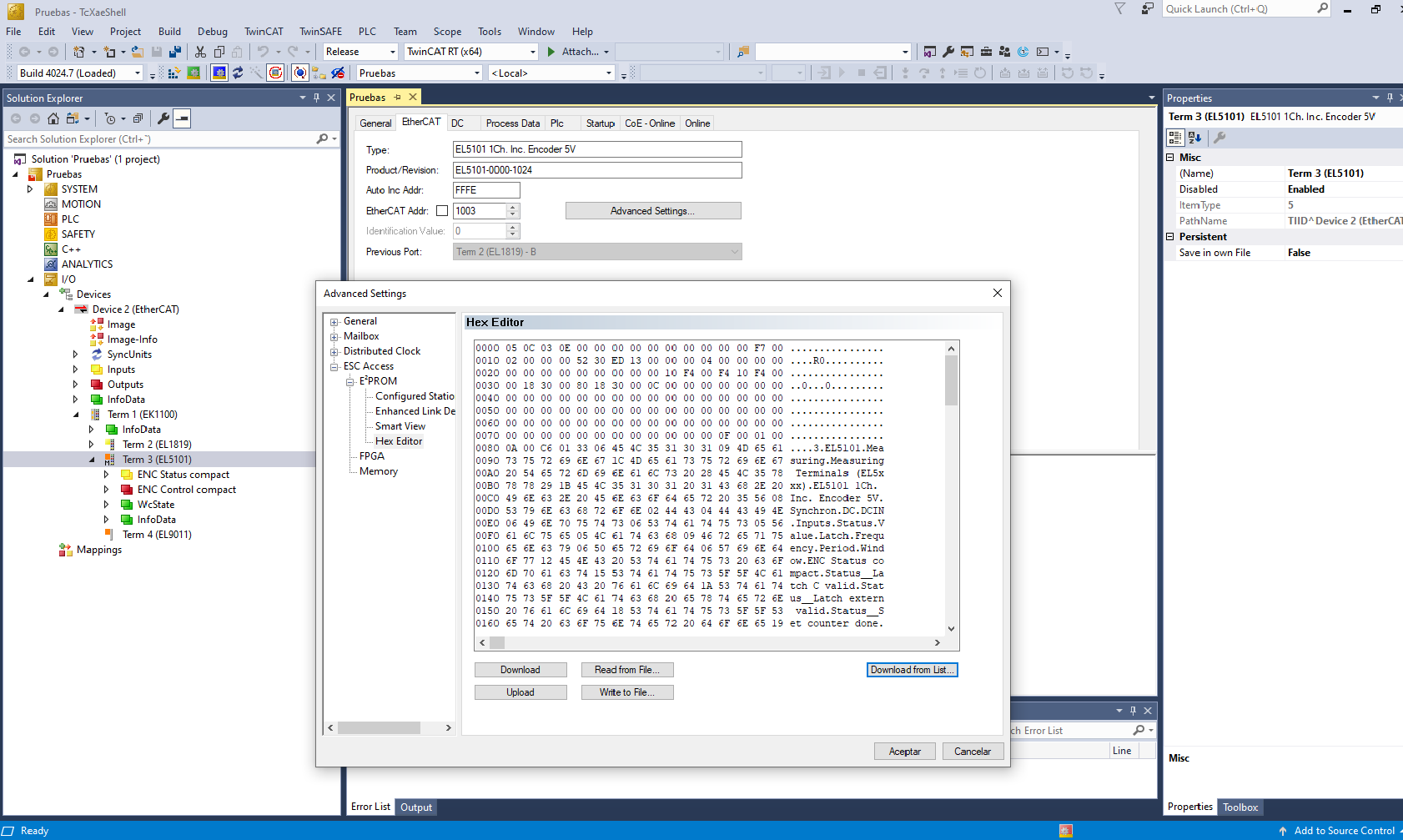

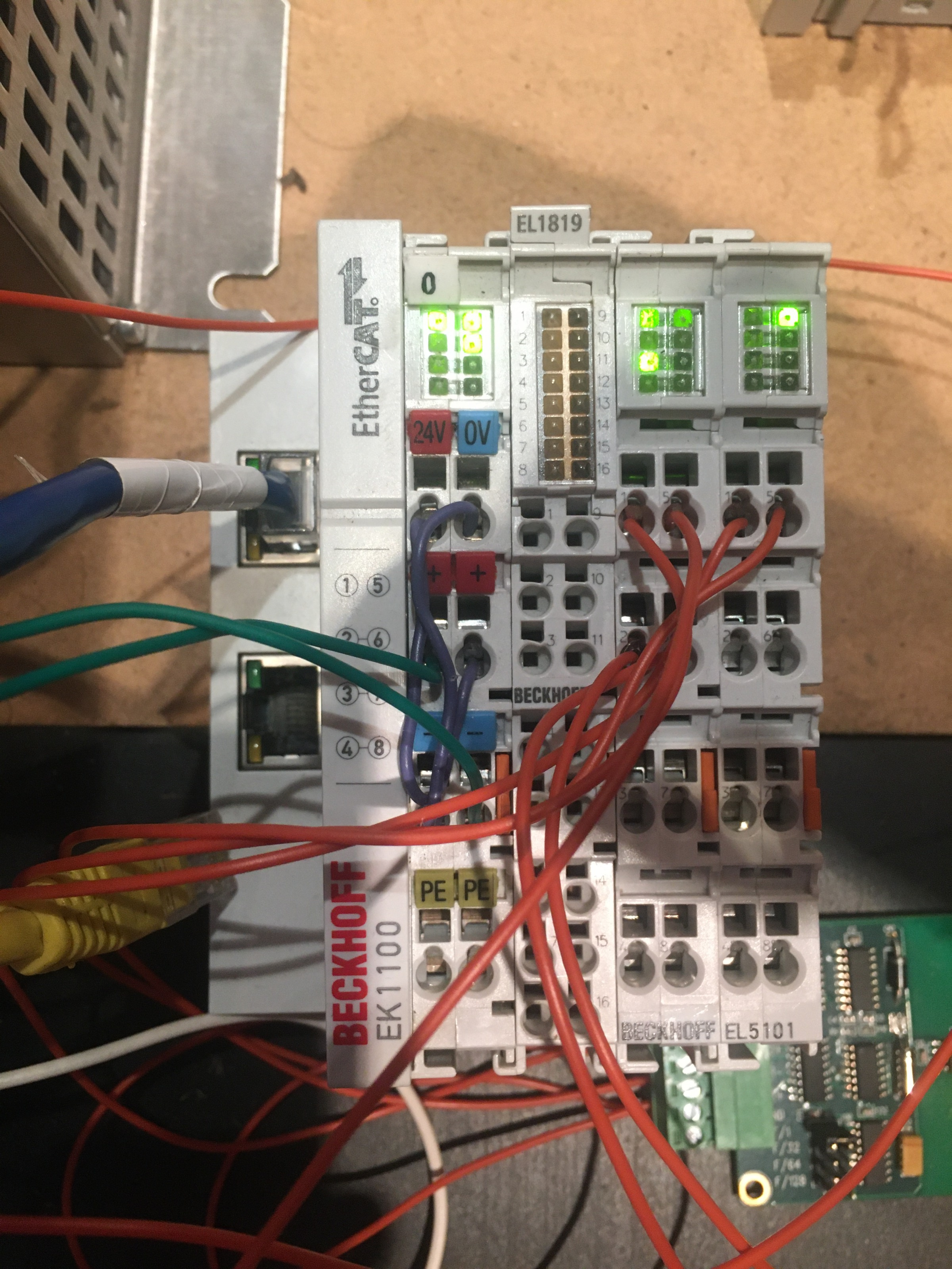

18 Apr 2020 20:12 - 18 Apr 2020 20:40 #164501 by chimeno
Replied by chimeno on topic Ethercat HAL driver
Hello @CORBETT @SQMATHLETE,
thanks so much for the compliments, although I'm just trying to help in any way I can.
I am attaching a couple of pictures of how to restore the image saved in the eeprom of the device, you have to be careful if you make a mistake it can destroy the device and it cannot be reconfigured,
1 - "ethercat" tab of the device
2 - "advanced settings" tab
3 - "ESC ACCESS" tab
4 - "EPROM" tab
5 - "HEX EDITOR" tab
6 - "download from list" tab
7 - select the device
8 - "Ok" ... recording image.

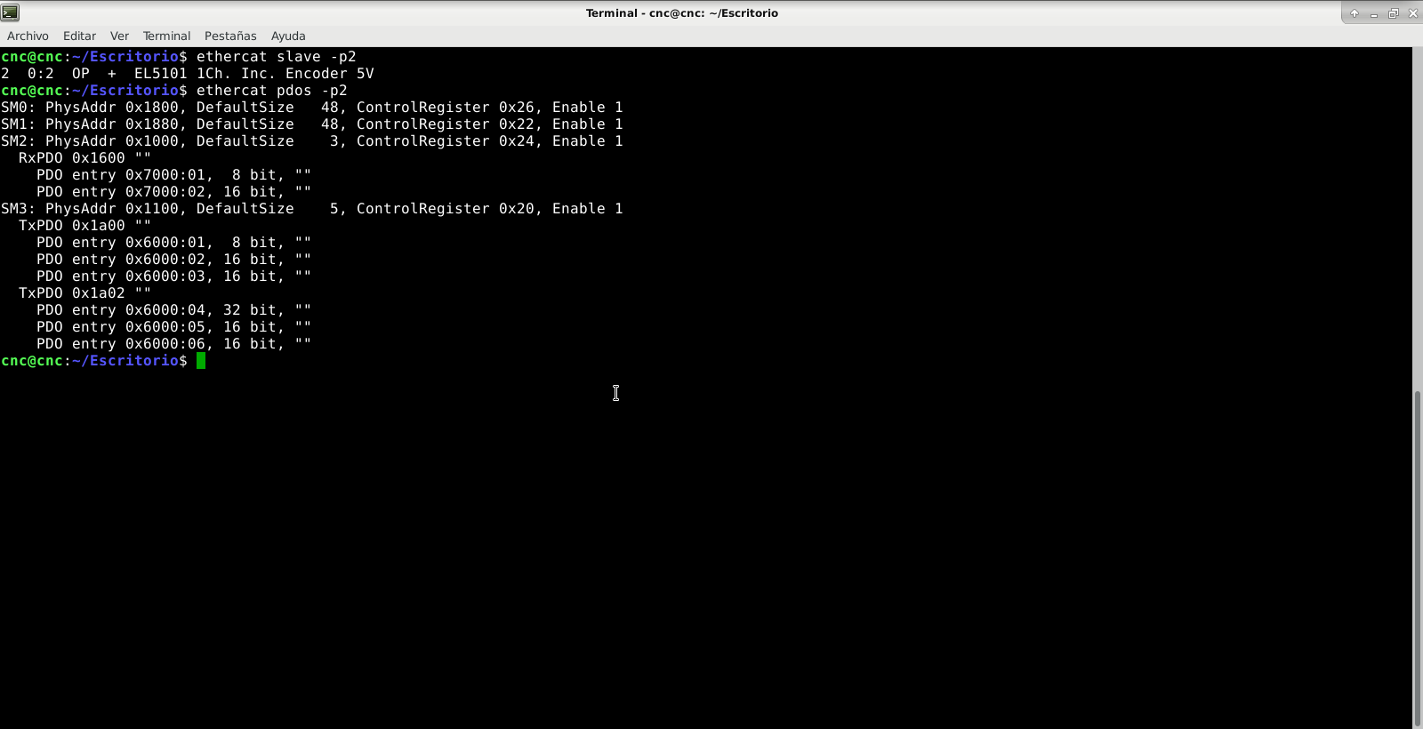

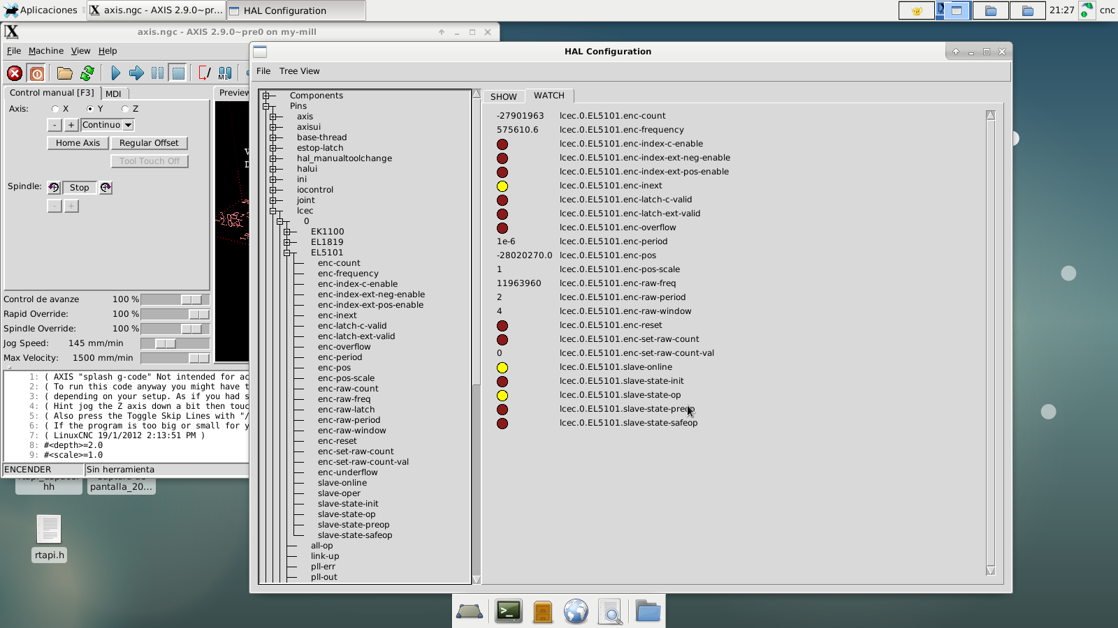

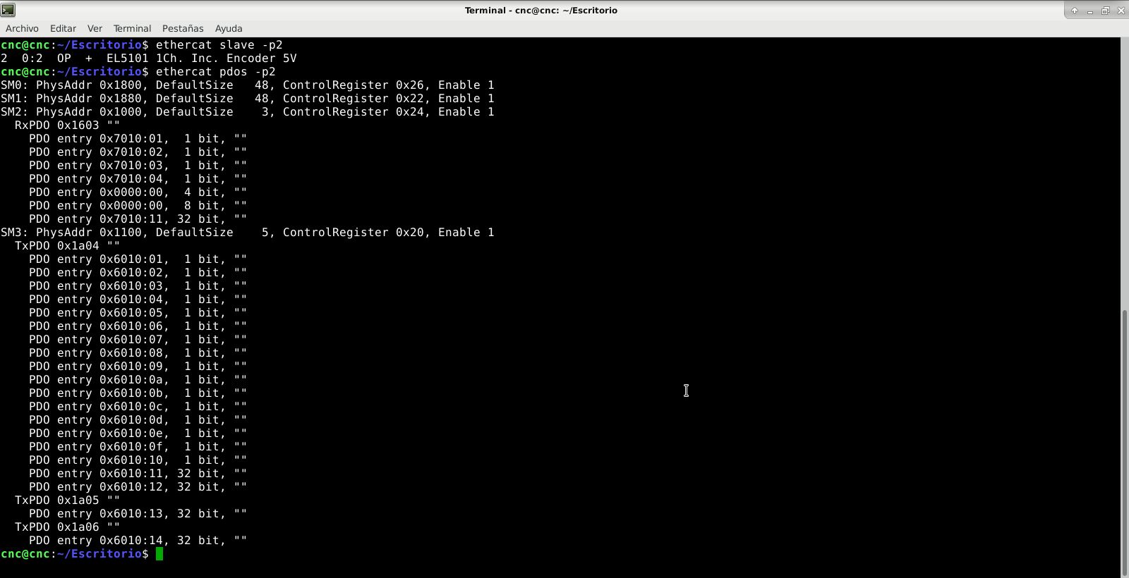

then I attach different screenshots from now of my device EL5101-0000, the device works witht the default configuration, although I have tested it in linuxcnc-ethercat with different configuration modes
- in normal mode Ok
<slave idx="2" type="EL5101" name="EL5101"/>
- in DC-MODE mode Test phase Ok
requires a new program or also if you can do it with generic mode
greeting
