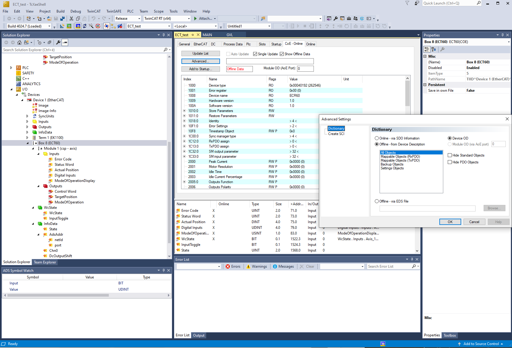

17 May 2020 20:53 - 17 May 2020 20:54 #168088 by theshade
Hi @chimeno,
Thank you again for your help.
Yes I did put the .xml in TWINCAT 3 already here
C: \ TwinCAT \ 3.1 \ Config \ Io \ EtherCAT
and it works, I was able to make an axis in the twincat and I have an "offline" drive. (see screenshot)
I will receive the ECT60 drives next week and I am not in a rush, but how and where do I export the .xml from twincat3 or do I need to I need to do anything else in it like configure drives parameters or such?
All the parameters or config files I can export from a simulated axis are exporting as ".lis" ,".xti", ".csi" ..but I couldn't find where to export an .xml.
Which menu should I use or what do I need to export?
The ethercat-conf.xml I use in linux CNC looks currently like this and it works in linuxCNC for the Beckhoff modules, I understand I will need to add the 4x ECT60 to it with SDOs and PDOs definitions
